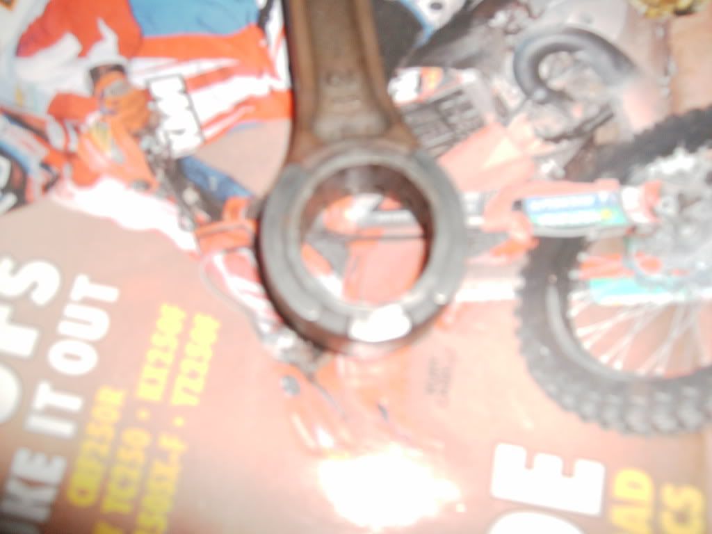

well she held it WFO in first gear for 2 MILES DOWN A ROAD...
so it made it 100ft from where she was going till it died, most of the coolant was gone

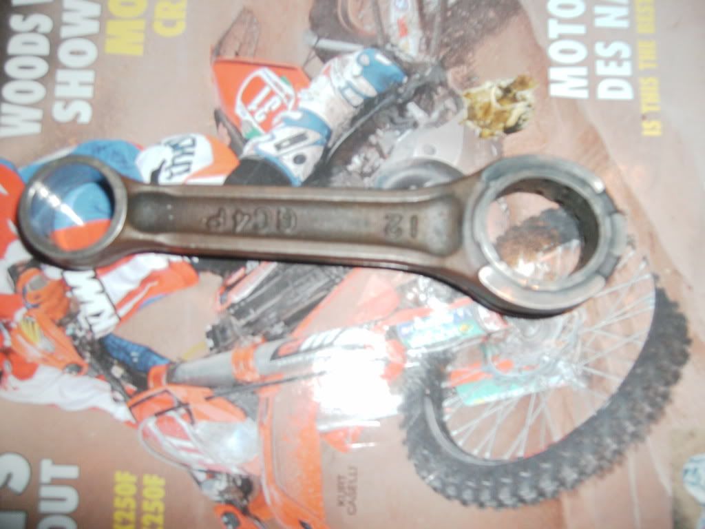

heres the rod, the bearing is non removable now, its welded itself in there
now to the point
the cylinder is perfect
the cast piston isnt scored at all
and since i was broke i just rebuilt the bottom end, didnt even do the rings and it still started first kick, good comp and was good as new
now if that was a iron bore there would ve been a smeared piston and it would have needed to be rebored for sure
and ive owned 2 cast 80s and 2 nikasil
never needed to touch the nikasil, and 3 rebores iron
and i had the iron when i was small, and the nikasil when i was 14-17
