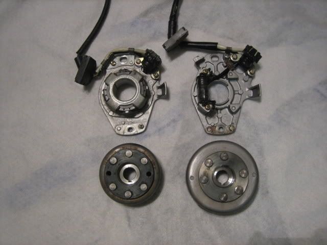

Got it today. OEM ignition has been removed and the 250 equipment have been test fitted. Direct fitment. Fits like it was meant to be there :D

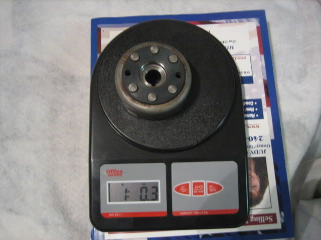

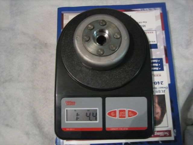

For you 100hp,
The 250 flywheel is 1/2" smaller in diameter, and made from 1/10" thinner material.
Before and after installation pics will be posted tomorrow, followed shortly there after by ride impressions.

4.4 vs .3 ? dude thats going to rev up like RIGHT NOW :lol:

4.1oz isn't really that much. A Service Honda ignition uses a flywheel that's 3oz heavier. You think about the after market FWWs in comparison. I don't think you can buy one less than 9oz. So in the grand scheme of things I don't believe the weight alone is going to make the largest difference. And of course this is a work in progress. I'm going to see if I can't use the 500 flywheel with the 250 cdi. Just so I know what's making the difference and where...
at any rate, thnx for the info man :cool: . also if your testing everything, you could try the 250 stator/flywheel with the cr500 cdi.....if it plugs directly into the 250 stator wires

It does. I will be testing all the components individually. See if I can't do it all this weekend.

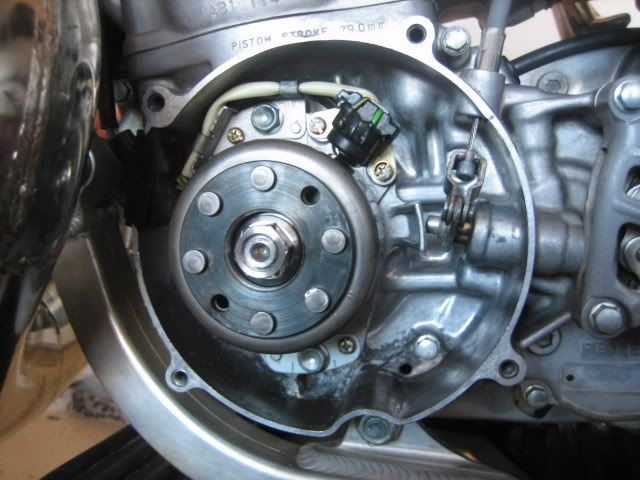

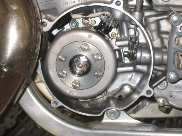

Everything mounted like is was original equipment. Cleaned all the parts up and applied dialectic grease to all the fittings. Be riding in an hour.
500
250
The size of the flywheel will make the biggest difference not the weight.

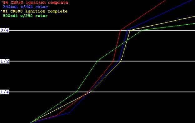

Here is how I think each of them effects power delivery. 0 - would be stock. 1 -5 would be for the better and -1 - -5 would be for the worst.
250 complete: Bottom 1, midrange 3, top end 5
250 cdi/500 FW: Bottom 0, midrange 1, top end 3
500 cdi/250 FW: Bottom -1, midrange -3, top end -5
Going riding again tomorrow, hopefully at Monster Mountain. Will have more input then. But for now I'm very pleased. A bit shocked actually the complete 250 ignition works as well as it does. I did not expect that. I will not be using the 500 ignition components again...

It's kinda hard for me to explain the differences between the different combos. And they say a picture says a thousand words so...
The vertical axis would represent power output while the horizontal axis reflects rpm:
:cool: :cool:
