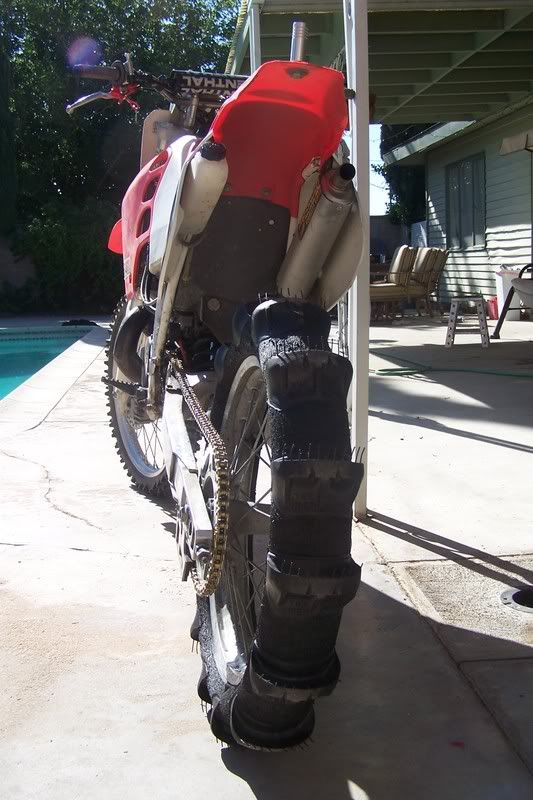

Even with the right setup the paddles still grab the rear fender and fold 'em over, Ive seen it lots at the hillclimbs. Im only worried about it folding my mount and flag into the wheel.
i remember first time out of the gate on mine over some whoops it caught the fender pretty bad and rear shock slammed pretty hard. im going to try the 6.0 spring and i hope its the right one. i cut a new fender that dont look to bad and wont catch on the tire ill see if i can get a pic- it looks like you might have to move the flag mount towards the seat more but maybe not. your setup is shorter than mine so it might catch easier

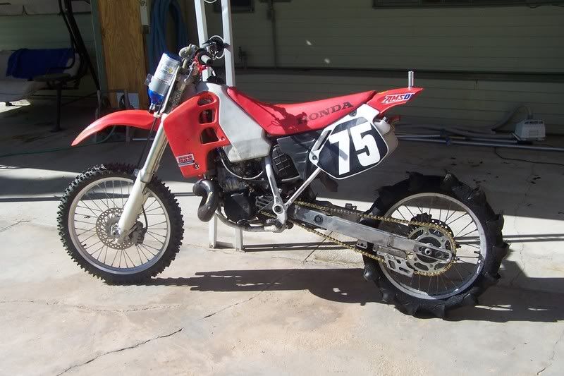

6.7 is what are on 2 of mine not sure of the other but looks stock, I had a friend re-do the valving on one, and just ran the stock valving on the other. when I set the race sag it turned into a pogo stick so I think its set to 5" and that softend it up.
lewisclan wrote: so I think its set to 5" and that softend it up.
I wound my spring down the other night and got it from 7.5" to 5.75", it made it really springy so I cranked both clickers in 5 clicks and it seems better now.
All done :D
The 14 viper is gnarley :cool:
so, how is the preformance with the PC pipe? have you put a real carb on it yet?
otherwise...NICE! :wink:
It seems like its got a little more on top but I havent had it to any really big hills yet, my trusty PJ is doing just fine :wink:

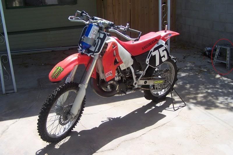

caseyracing222
Posts: 569
Post by caseyracing222 »
britincali wrote:Image
Stuck.... Ya rite :roll:
Hey Brit how big of a bottle is that?
-Jake
4Z
Posts: 299
Location: Western WA
Post by 4Z »
Looks like a 2.5 lb'r?
britincali wrote:
lewisclan wrote:, or keep the LAME look that you currently have working for ya :D
You gotta love the 3lb capacity :lol: :lol: :lol:
Its a 2.5lb bottle but you can and I have got 3.5lbs in there.
Hey Brit nice ride man. :cool:
