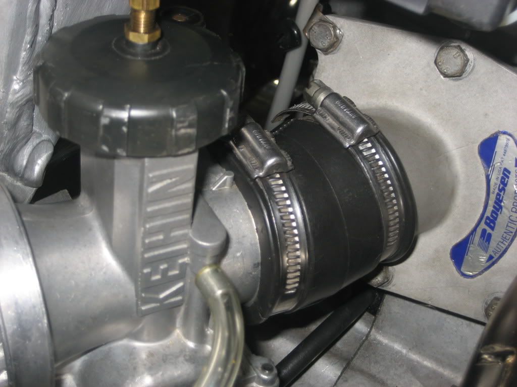

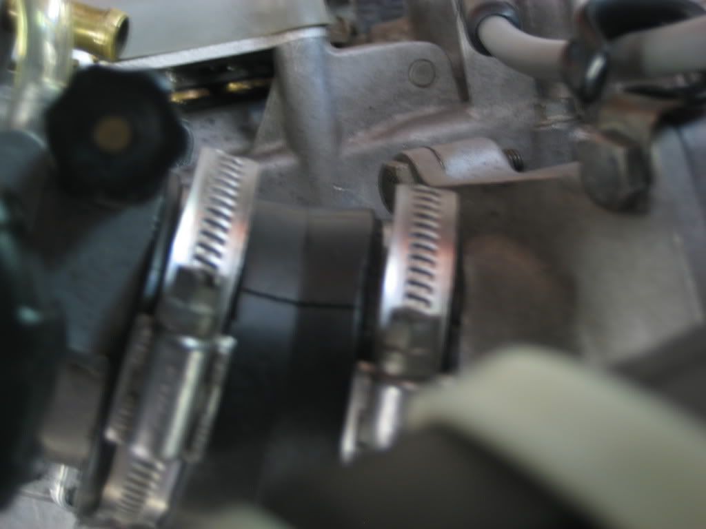

when I went to put the pipe on last night I decided to redo a few things better. one was the airboot/carb connection. mine has a rad valve and the airboot pushing on the shock makes the boot want to pull off of the carb. I stared at this for a while and thought the rubber manifold between the carb and reed block intake needs to be angled, not straight. a few months ago I took the Jikov carb off my CZ 400 and put on a 38 mikuni. The rubber boot I took off the CZ was perfect (bad pics sorry)

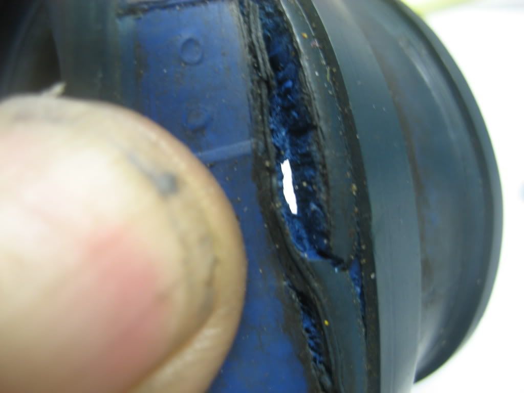

in the process of removing the stock CR 500 manifold I realized I had overlooked that it was rotted out (need better glasses I guess) good thing I decided to make this change or I would have been sucking in sand.

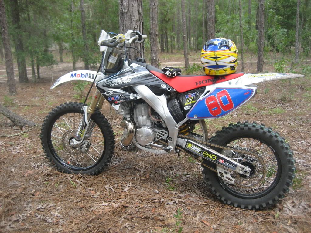

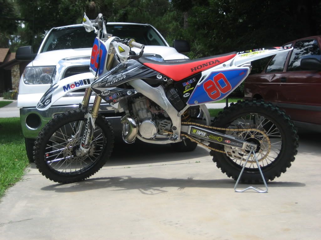

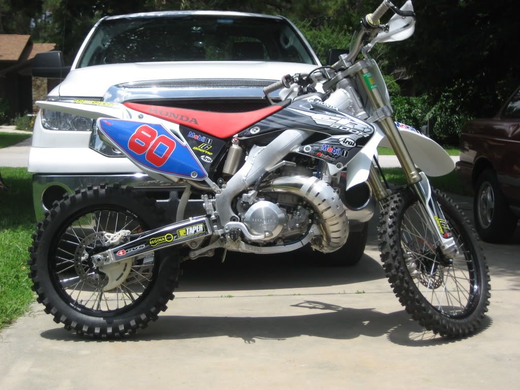

ok I hereby declare TTM frame #11 build as complete.
1994 CR500 power
2003 CR125 chassis
2006 CRF250X suspension
1976 CZ 400 intake manifold (:
09 TTM CR500AF
08 KTM 200 XC
08 Ducati Hypermotard
03 CR125
95 CR250
83 Husqvarna 125 XC
73 Maico MX250
I'm not feelin' the pipe guard.....
Everything else is pretty sweet!!!!

thanks, I put CF guards on all my bikes but the one for the std 500 pipe doesn't fit these SH pipes. My friend with the SH LE has one and it fits like crap, actually looks worse than this believe it or not. all my riding is tight woods and I go for every log and wall of brush I can find so I have to do something or I'll have this sweet pipe looking like a pancake by the end of the day tomorow...

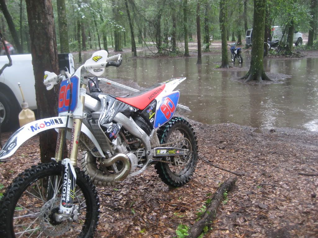

"Like the man said go out and get that thing DIRTY!"
well a little dirt. rained like hell, this is our parking area, was completely dry 30 minutes earlier. Thats Dredge"s 500 in the background. he's a mod on the other site. we swapped bikes for a brief ride in the pouring rain.

btw, bike runs great, freaking power is just stupid. frame works great, handling is good but still sorting suspension and set up. was worth the wait indeed.
