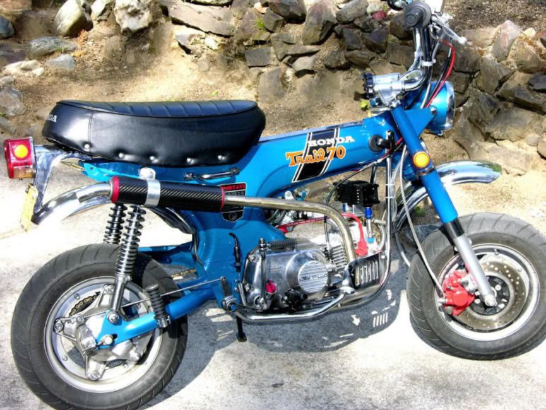

Here's a couple of my other bikes I've done up and/or own. the ct70 cost me about $6000 but I made it a 75mph machine.

That CT70 is BADASSS!!!!
That was the first bike I ever rode.

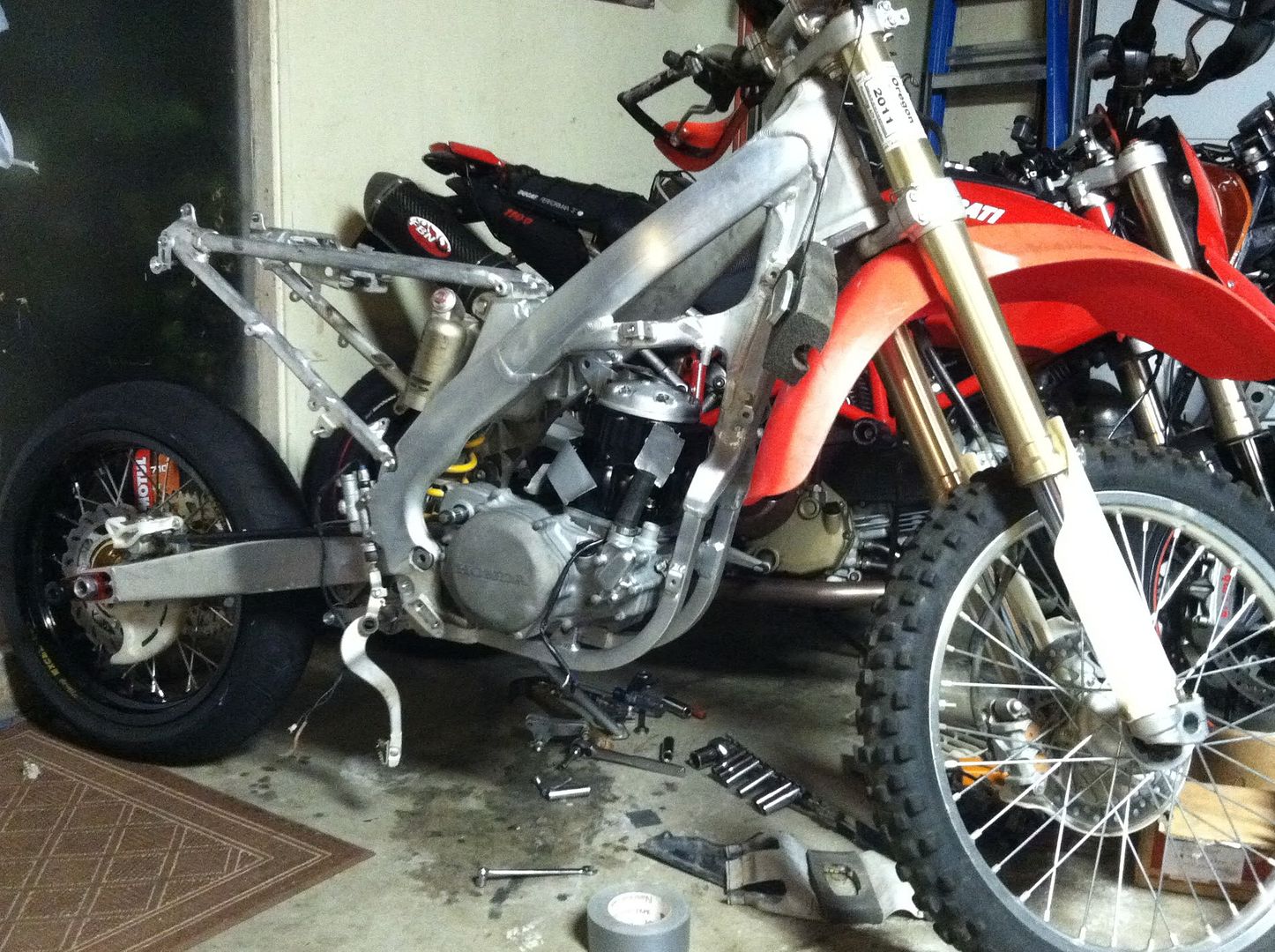

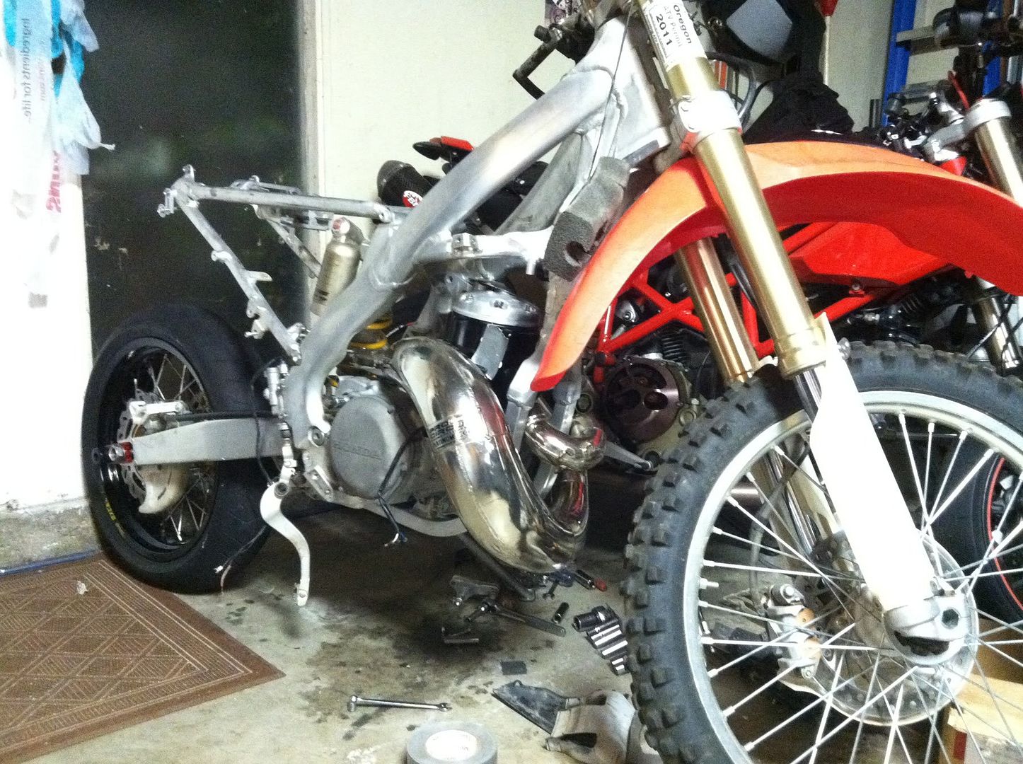

still working on this one after delays on other projects. CRF250X motor weighs 60lbs, 91 CR500 wieghs 58lbs, I thought the difference would be more but losing weight is always good

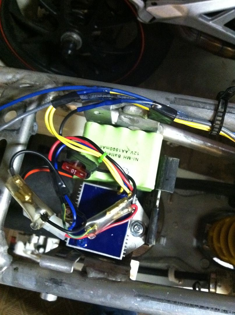

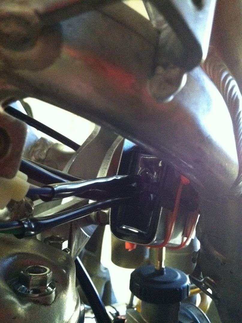

service honda cdi
Post by Jeff4510 »
So I have a brand new sh cdi with the dc output so this bike can have lights but no wiring diagram. Anyone have any idea? SH has been slow to respond and not really helpful in any part of this build so far. I'm getting close to getting this done. Mike did a great job

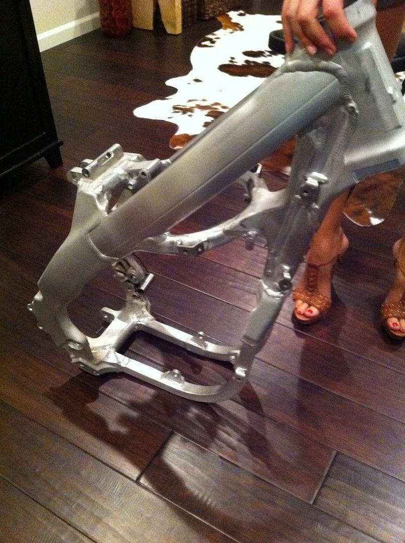

There needs to be alot more leg shown to get answers like that :lol:
Jeff4510
Posts: 86
Joined: March 2nd, 2010, 8:58 am
Post by Jeff4510 »
Roostius_Maximus wrote:There needs to be alot more leg shown to get answers like that :lol:
lol! The chick lives in Denver and I'm in SO cal. Haven't seen her for awhile

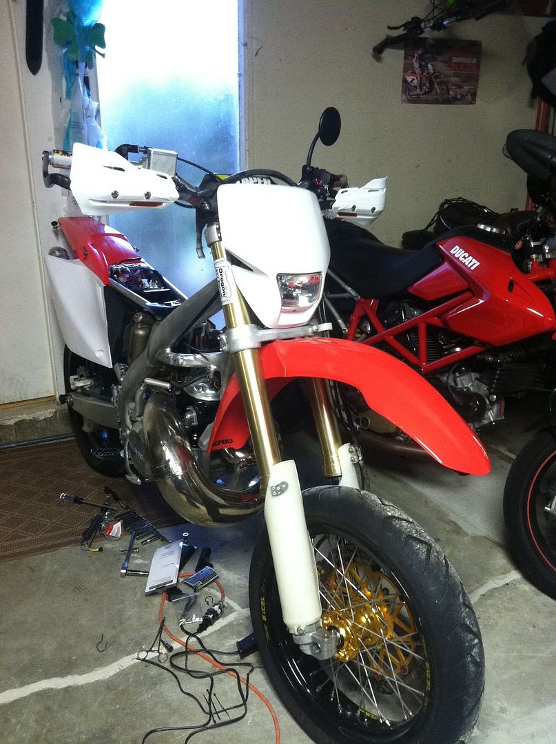

Finally getting to doing the wiring harness
Re: service honda cdi
Jeff4510 wrote:So I have a brand new sh cdi with the dc output so this bike can have lights but no wiring diagram. Anyone have any idea? SH has been slow to respond and not really helpful in any part of this build
Call Electrosport.... they made it.
http://www.electrosport.com/
S/H doesnt make anything..... and stopped selling them due to massive failure rate with them.

I got it all figured out, Jeff at SH really really took care of me! Blinkers/lights here I come :)

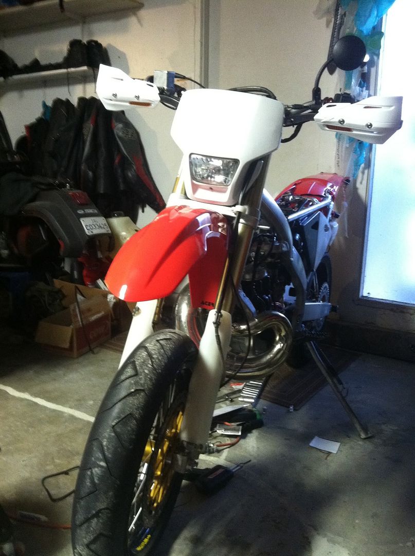

General question regarding rad hoses: since I'll need 90• bends in both the lines going to the head, what are you guys using?
Mik329
Posts: 493
Location: Cumming, GA
Post by Mik329 »
stock or buy a kit from motohose. You can always put 90 outlets in the head as well.

Yeah, I've got the same. So stock bend hoses fit on that? I must have missed something...
getting there Image
Jeff4510 wrote:Yeah, I've got the same. So stock bend hoses fit on that? I must have missed something...
getting there Image
Yea, cutoff the last down turn and your golden....

So I started her up tonight and she ran great but didn't have the chain on. So with regards to the shifter, the bolt comes up from underneath and it hits the frame and the shifter cannot go on with the bolt on as the shaft is slotted. Any ideas? Is there an aftermarket one that would work?
thanks! I'm excited, it sounded so crisp and clean but man what a bitch to kick over. Major compression
