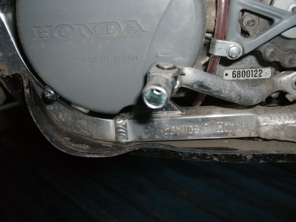

sorry bob, i didnt make it clear. i said some people were re using the genuine honda y section which appears to be hollow (which would be my prefered option) and not using billet ones.AlisoBob wrote:
Not hollow....
![Image](https://bannedcr500riders.com/images/auto/d5e4982a5a8c6ee2c4b131c1b0bdde55.jpg)

i would have thought it was for the web on the inside of the extrusion (down tube)AlisoBob wrote:Thats the upper section I told you was milled out, the holes are prolly' vents to let trapped ( expanding) gasses out while being welded....

http://i216.photobucket.com/albums/cc24 ... ble022.jpgAlisoBob wrote:
Not hollow....
was looking at att the builds and found this. looks like mike used to hollow out the top section after all.

and i think the Y is solid, and the bottom rails are billit, i dont know if there drilled out, but i like how ill never crush them
![Image](https://bannedcr500riders.com/images/auto/d965bd58b2c592f01ccf5994d0957482.jpg)
