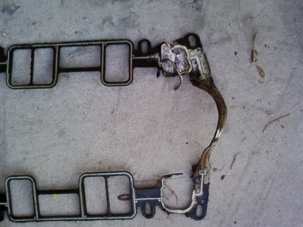

so, I got that fucking intake off, what a PITA! I wish GM would put the wire harness along a crossmember or along the firewall like everyone else! and I wish they would decide if their vehicles are metric or standard... WTF!
anyway, some D-bag put a crap load of stop leak in there when the coolant was leaking into the valley and mixing with the oil so the 2 rear coolant ports were plugged solid over 1/2" thick with this stop leak crap!
just went and picked up a gasket set and t-stat, should finish tonight.

a crank better be in the budget, anoterh 300 miles and you'll be in it
the gasket was crap, but hey the heads arent junk like the ford 2.9+4.0s
its not like a ram 318/360 where the valve seats are wore out by 100,000kms, the valves recess in the head and stack up to break the pushrods, kick a lifter, no oil and bang shes over
felpro has the best gasket to replace that vortec stuff, aluminum with rubber, never do it again.

just finished the fucking thing! the aluminum was all eaten away at the 2 rear ports on the manifold. so I wire wheeled it to break the powder shit loose, then I RTVed the hell out of it w/ the new revised felpro gaskets. should be solid, I went through the same thing with my old c2500. before I start it I'm changing the oil.
turns out my mother in law was told when she did an oil change 6 months ago that there was coolant in her oil and didn't tell me. then she came home the other day after getting an oil change and told me the guy there said she needed to replace the manifold gaskets for liek $700. so I told her I would see if I see a leak (she STILL didn't tell me he said there was water in the oil). Yesterday she comes home and tells me it over heated. I look for leaks on the outside, none, I check oil, looks a quart over.....
I will see how long the bearings last when I add some fresh oil tomorrow.
