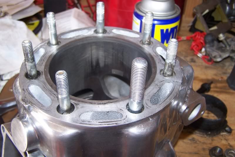

M.F.D.B. wrote: How do you plan to enlarge the gasket holes without fukking the gasket??
I practised today on an old one and as long as you have a decent drill bit and go slow it comes out alright.
What size Reamer you need Brit? .375-.390? Millimeters are not going to help me here. Remember, your on the other side of the Pond. :lol:
Twist drill ain't gona get it, "One Slip and Down the Hole You'll Fall." -P F
I'll see if I can bring ya one Sunday. :wink:
Also I don't if its a good idea not having a shoulder on the new studs. OEM ones are designed like that for a reason. I wouldn't want the thread at the shank to put pressure, expanding the cylinder and cause it to crack there. Understand?
Im not following iggy :?
If you are talkin about the threads on the stud expanding on the lip of the barrel I dont think thats gonna be an issue as there is still a gap....
Ive also been wondering exactly what size to do the holes in the head and gasket, Ive been leaning towards 11mm (dont know what that is in inches)
britincali wrote:If you are talkin about the threads on the stud expanding on the lip of the barrel I dont think thats gonna be an issue as there is still a gap....
Ya I kind thought that.
I'm just concerned about where the thread ends at the shoulder of the stud pressing against the thread inside the cylinder, possibly causing the cylinder to crack.
Maybe this is a none issue cause sometimes when the head comes off a couple of the studs are already loose.
11mm hmmm.... maybe .406 = 11/32"
Im not sure on the size but the hole has to be larger than the stud @ 10mm otherwise it would be a press fit :lol:
Got a mic to measure the new stud?
Posts: 2960
Post by M.F.D.B. »
Guys the stud is tapered because its smaller on one side then the other. If you didnt taper and left a "step" you would have a HUGE stress riser...
iggys-amsoil wrote:Got a mic to measure the new stud?
Ive not miked it but im pretty sure its 10mm :wink:
throw it back on the hone after
Already done and as of an hour ago making smoke.
What do you mean hone it after?
