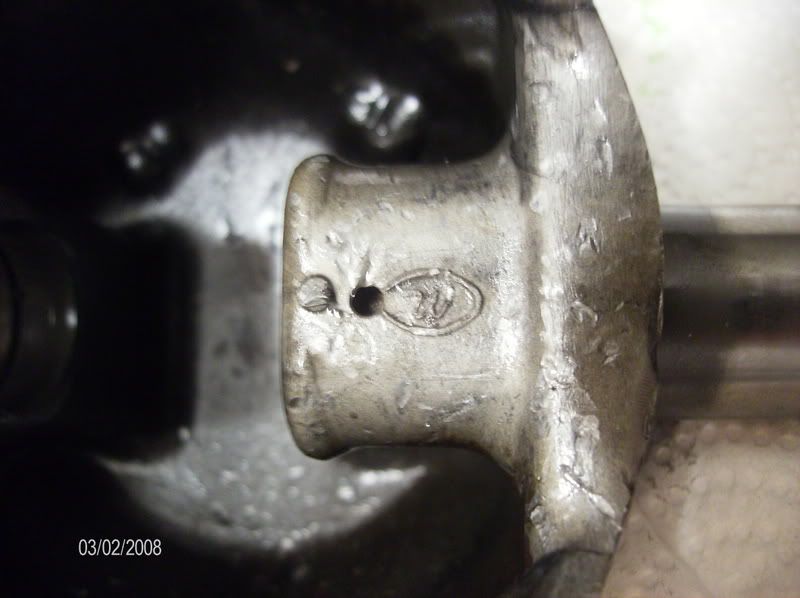

the 55 is the part number, the oversize should be stamped on the top middle. since looks like a .5mm oversize jugjing by the compression releases. measure to be sure. you either need a .75 or 1.0mm over (by my guess.

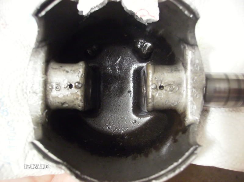

heres a couple pics of the bottom of the piston, i knew i shouldnt have let Brit borrow it to run a 75 shot on :) .. wheres that new orleans crack head with the box full of looted top ends when you need him

im all for not having to rebuild the bottom end, Bob also suggested i flush it with diesel untill it pours out clean, definitly better than redoing the bottom end!

Jay, do you know where you are going to have it bored?
Glen at GSS charges about the same as my local shops, only he uses a torque plate and knows 500s inside and out, and could also probably repair your head, since I imagine it is all dinged up.
if you go with another wiseco make sure to tell the machinist to bore to atleast .004 tollerance. you have to tell them this since the box will say to bore to .003
