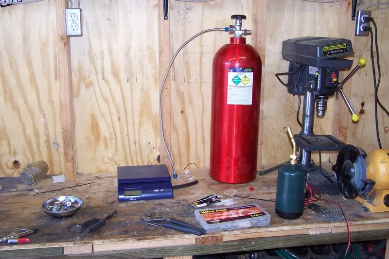

lewisclan wrote:It looks like Ill be looking for a Bottle re-fill set up as well . are there any out there ?
You can go all out and buy a nitrous pump for around $500 to do it properly.
I copied stoffers setup and got hold of a 20lb bottle, 2ft of 4an hose and a $20 scale off ebay.
I slap the small bottle in the freezer and sit the big one next to a heat source (blowtorch, heatgun, heater in the camper)
Connect both bottles, open the taps and voila the little one fills up.
As long as there is a big enough temp difference I can get 3lb in the 2.5 lb bottle, you won't be able to get all the nos out of the big one without a pump tho.
Cost me $200 for the 20lber (full) $20 for the scale and $10 for the hose.
I know that if i fill a 10lb bottle by the freezer method the bottle holds a denser charge, sounds stupid, but measuring what leaves my big tank the freezer method does take more liquid into the cyl than my nos brand pump does.
Dont make the mistake of having a bottle on the bike thats too small. When the nitrous leaves the bottle the bottle cools and you loose pressure and reach a richer fuel mixture. get a bigger bottle, and it wont cool off as much = denser nitrous.
When i was truck pulling I used a fullsize tank 55lbs of nitrous and painted it black. I needed to add weight to the truck anyways, black in the sun also helps boost the pressure. I had a 500hp stock bore stock stroke chevy 350, and added 200hp of nitrous to it. It was also my daily driver.
At 4900 lbs that was a sweet machine to drive, I have 25 miles of gravel roads between work and home, so with the setup i had on the suspension she handled great, but pull another 200hp of nitrous into it on gravel and u'd better have it in 4x4! Wasn't til i got my first 500 a year after selling the truck that i had as much fun.
The only way I can get my tanks empty here is to take the tank and roll it out in the sun to get er heate up and then pump it out. I always send my cores back with atleast 3-4lbs of unaccessable nitrous. And ya, the dentist nitrous works dammn good too, maybee better.
