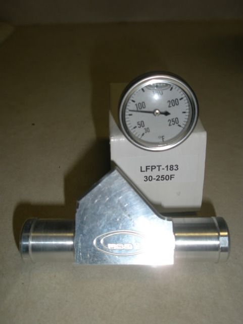

The ESR gauge and gauge block
http://www.eddie-sanders-racing.com/Sea ... emperature
The "USA-1" that I put on my bike.. No link yet I will try to get some and put them in the classifieds.

I went to Jay's place today and picked up 6 gauge blocks
ID is 5/8"
OD is 3/4"
OD at Barb is .800 (almost 13/16")
Over all length is 3 1/2"
Gauge hole is 3/8" female pipe thread.
