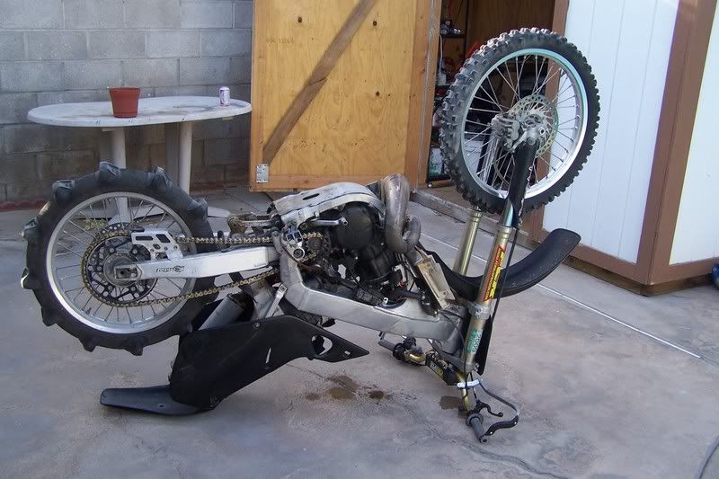

I don't know those alky jets are HUGE and I know from experience you can get at least 1/2 a cup of fuel in the bottom of the motor from kicking.... (see the fuel puddle?)

it was from bump rolling the motor with the carb closed using the electric starter . after I cleaned it all out I used meth and I wAS STILL ROLLING THE THING OVER ........
i REACHED OVER AND OPENED THE CARB AND BANG,
SHE FIRED .
