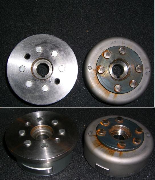

How will the CR250 Flywheel affect the 500 though?
simple, take a 250 and a 500 one and have them both spun to see what the balance is at, any one how balances small cranks can do it. If they are differant have the 250 one changed to balance like the 500 one.
As for the later 250 digital units they also have a electric sensor circuit built into then for carb enrichment, left unused It may or may no effect how the unit overall works, that would be a testing issue.
I've run the pre digital 250 CDI box with good results using the 500 stator assembly and coil.
