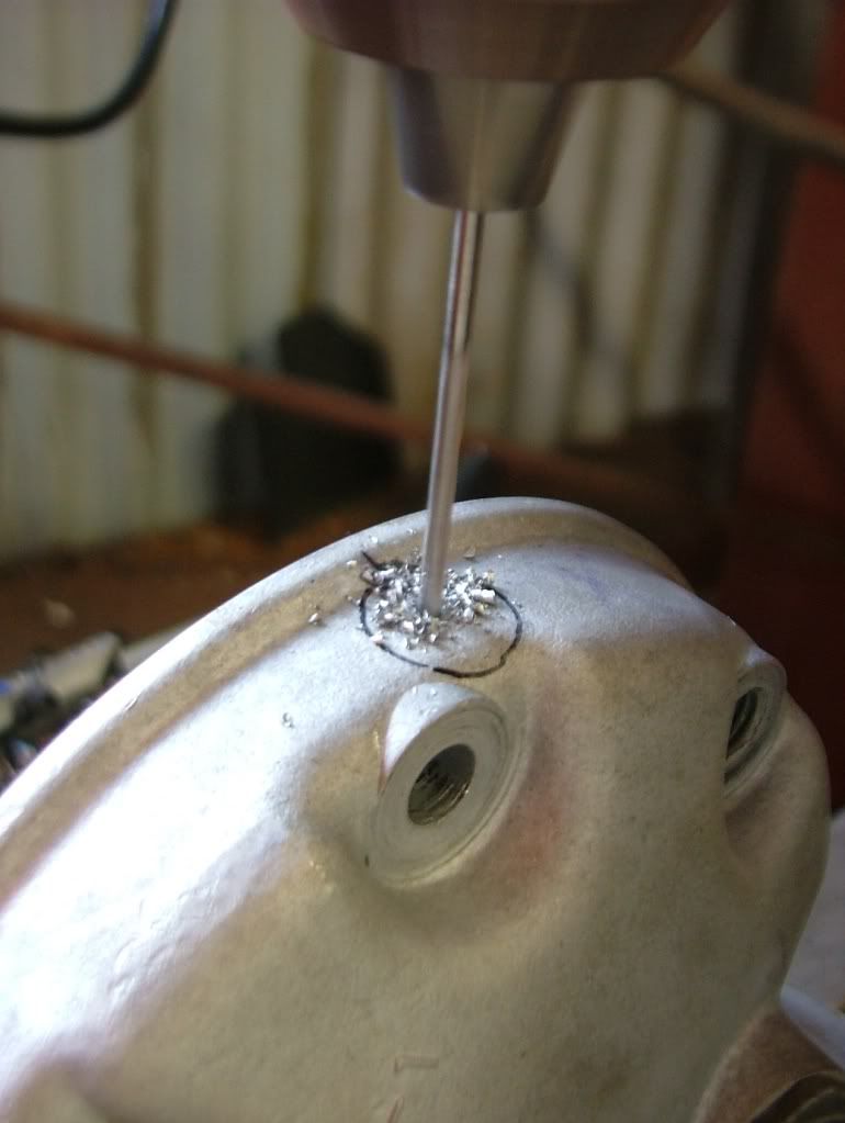

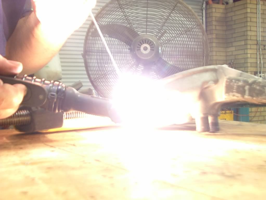

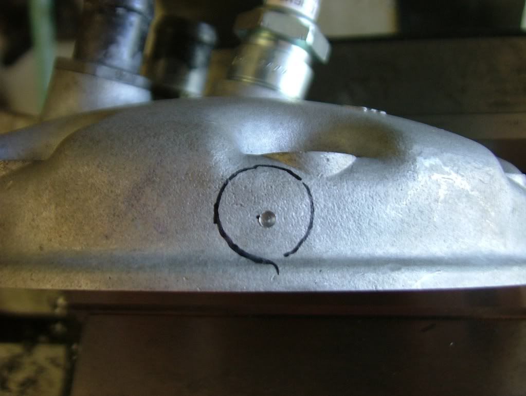

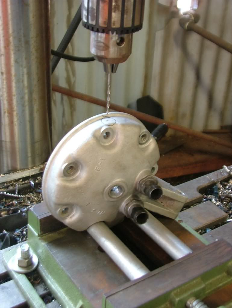

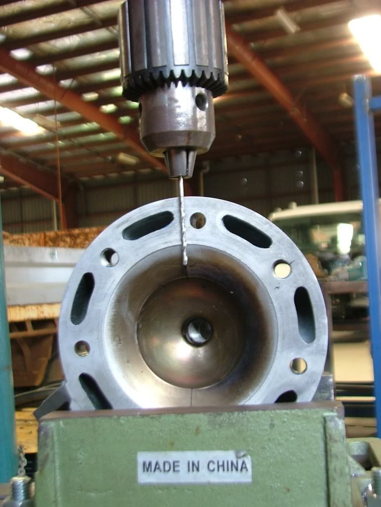

I finished off my D-comp valve today.
I decided to go in here.
Using a 2.5mm bit we set the head up in the vice and made sure it was sqare. i used the 2.5mm bit as it was the only one i could get that was long enough.
Clamped in place using 2 pieces of rod so as to press the face of the head against the sqare side of the vice.
Drilling the hole, we went in slowly and with the odd spray of WD-40 to keep it from binding on such a long hole, also drawimg the bit all the way out every now and then to spray the alloy of the bit with the WD-40
Now i used a 14mm blade bit to recess the side of the head so the new treaded piece could sit sqare onto the head, you dont have to do this but we did because it was easier to hold it in place to weld.
Recessed.
Dummy fitted prior to welding.
Clamped in place, alot easier with the recess done.
Steve tig welding it in place. (thanks Steve, my welds suck)
Final welds completed.
A quick acid bath.
And finaly back were it belongs, i recon it looks good, is functional, and easy to get to, you've gotta flick out your kick start any way so now i can hit the decompression valve while i'm at it.

Donavan, i drilled square to the face of the head, there for it exited 4mm above the band line in the squish cup.
I dont see a problem with it, i chamfered the hole so no hot spots are going to be prevelent.

any pics of where the hole enters the combustion chambers ??
i know you a bit concerned about people saying it would block on the outer edge just think the hole in the outer edge is a safer option [ could also make it harder to do any head work at a later date [recutting squich band]
saying that due to to the shape of the head it should work ok ,
