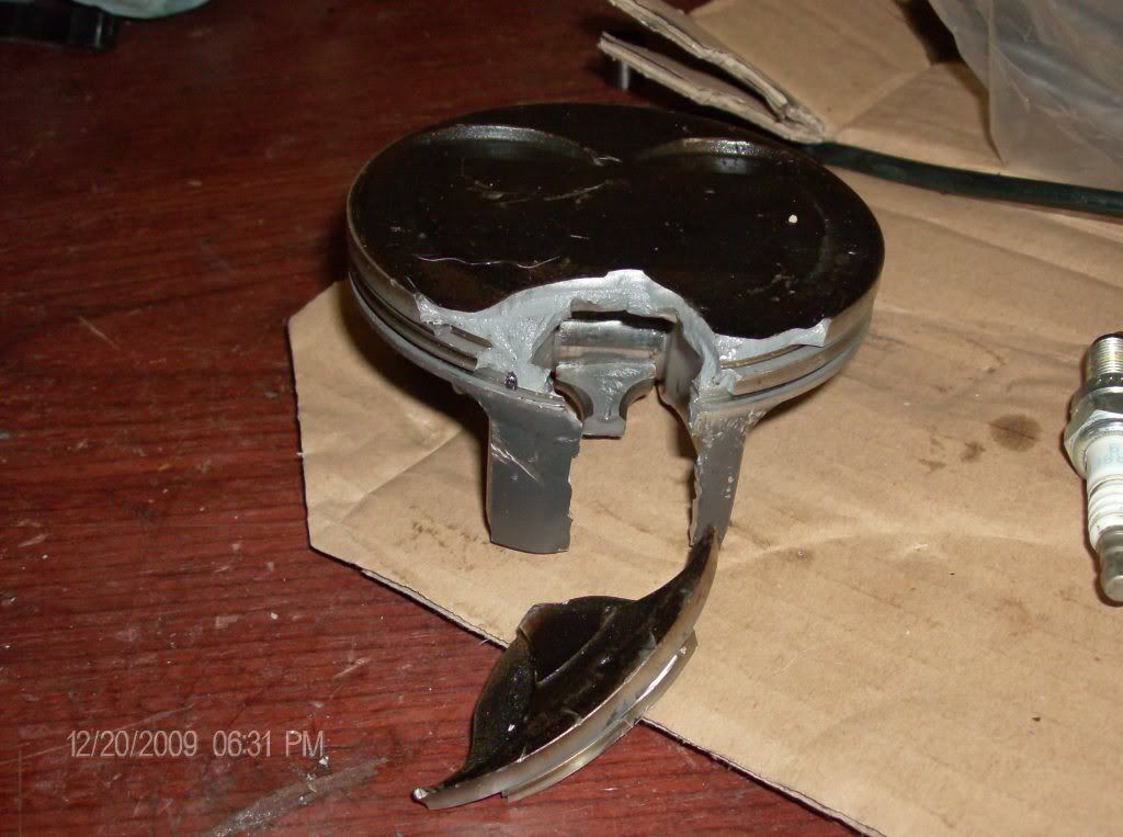

Here are a few pics of the motor from my friend's KX450F. This was a relatively low hour motor that always ran strong.

The KX450F I was riding this year ate a piston in November. Not nearly as badly as the one pictured above...but fuck...might as well had been, it's costing a fortune to fix. Shame really, it "was" a strong running bike :(
that pic is an '06, they had a weak rod that got fixed in '08. unfortunately they fixed the weak piston in '10.
Mick, the rule of thumb on the kawis is a powerloss=time to check that piston. they get a crack going across the piston by the middle that makes a huge compression loss, but doesn't damage any other components unless you keep running it. You friends mistake was taking it to the stealership for said "tune up" those pimple popping douche bags have no fucking idea what they are doing.
he could have spent $150 on a forged piston or an oem '10 piston right when he experienced the powerloss and been back to riding with more confidence than ever.
in the next month or 2 (after I catch up financially) I'm going to just buy a piston kit and just replace that shitty oem piston.

Doesn't have to be. When we're talking 4-strokes valves and pistons are only 20% of the problem :lol: Where were all the Honda's this year? Dead in the parking lot with FI problems :doh:
the main reason I went green. that and the oil separation and decomp pin failures of the honda.
