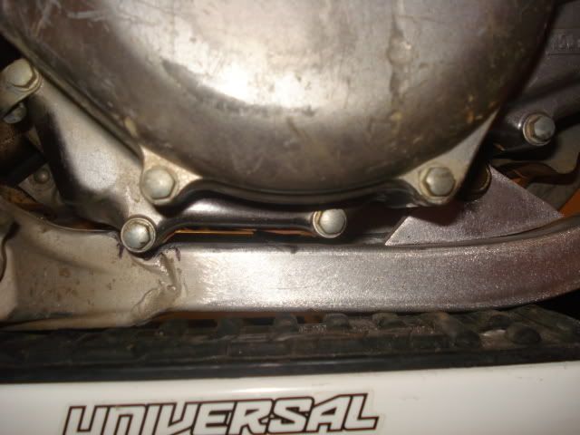

This is my steely that got sacrificed.
Please I can't wait to be doing this on the AF I've been losing waay to much sleep. Think'n bout I could do this or that But I just want to weld on some nice clean pieces

on my 450 i cut out two notches for the two lowest hanging cover bolts, and tilted it as far as possible, super glad i did that cause like danny said, no tank issue AT ALL...it's close but it's close enough that i didn't have to f with it, and a shorty plug fit perfectdannygraves wrote:look up my gen-4 conversion.
I would angle that motor a lot further forward. I cut into the cradle and insered a solid peice, then hit it with a drum sander. that motor being angled like that is going to make you gas tank even more or a nightmare!
on my bike and marshalls, but angling the motor forward, I was able to keep the stock petcock and just heat gun the tank.
BWT, on the R airbox, the best airboot is a gen-1 125 ('98-'99 cr125) the gen-1 250 works also, but the stock 500 boot is way too short to use a R airbox.
I got the hose routing on marshalls biek to work out well using all the existing stock hosts and a plastic '02-'04 crf450 coolant Y.
