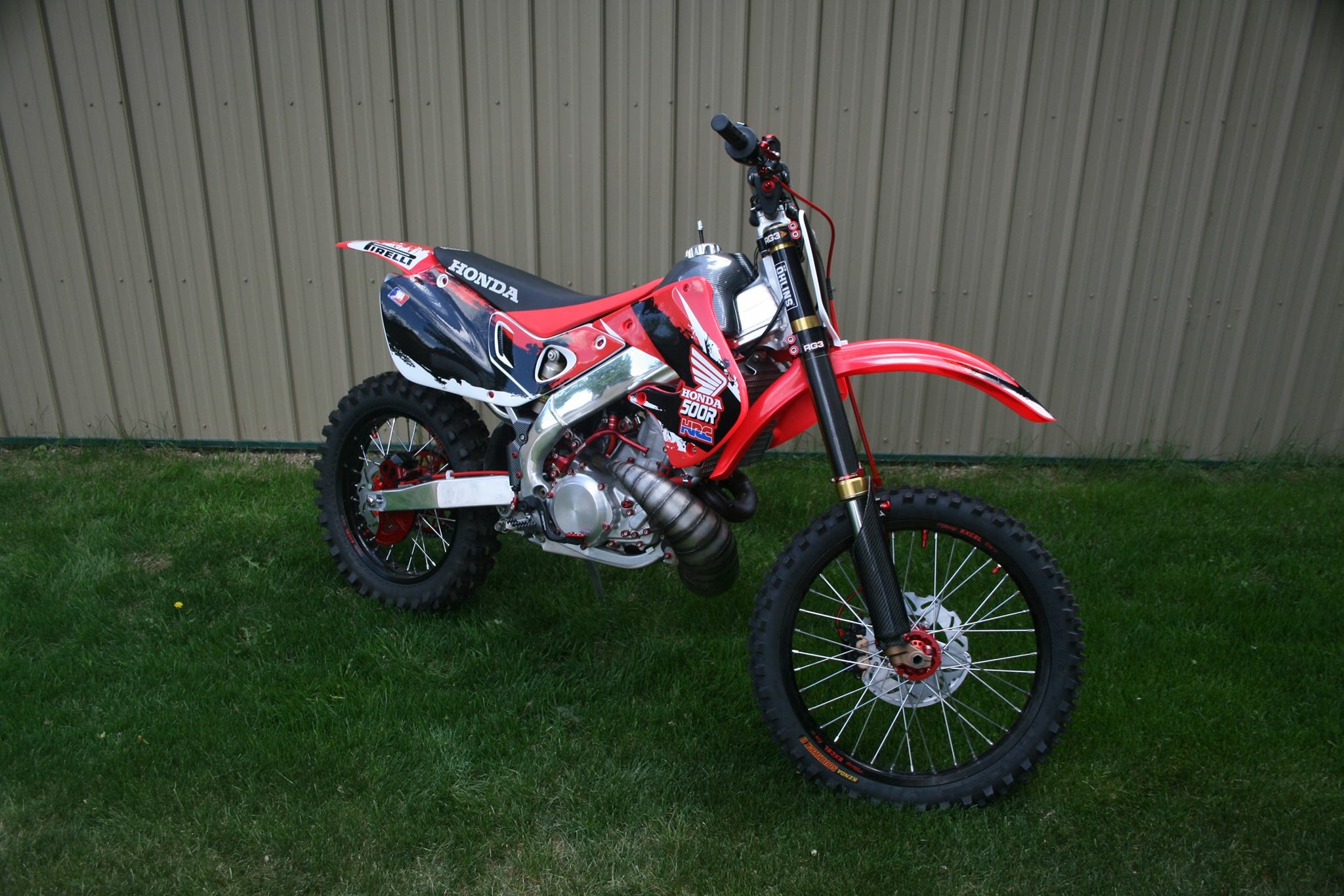

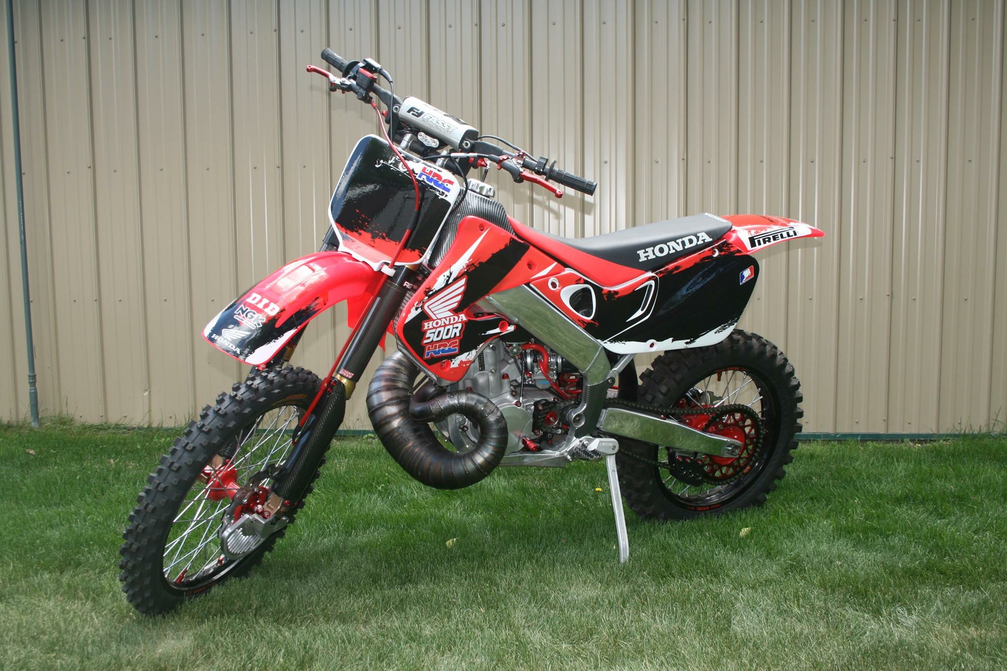

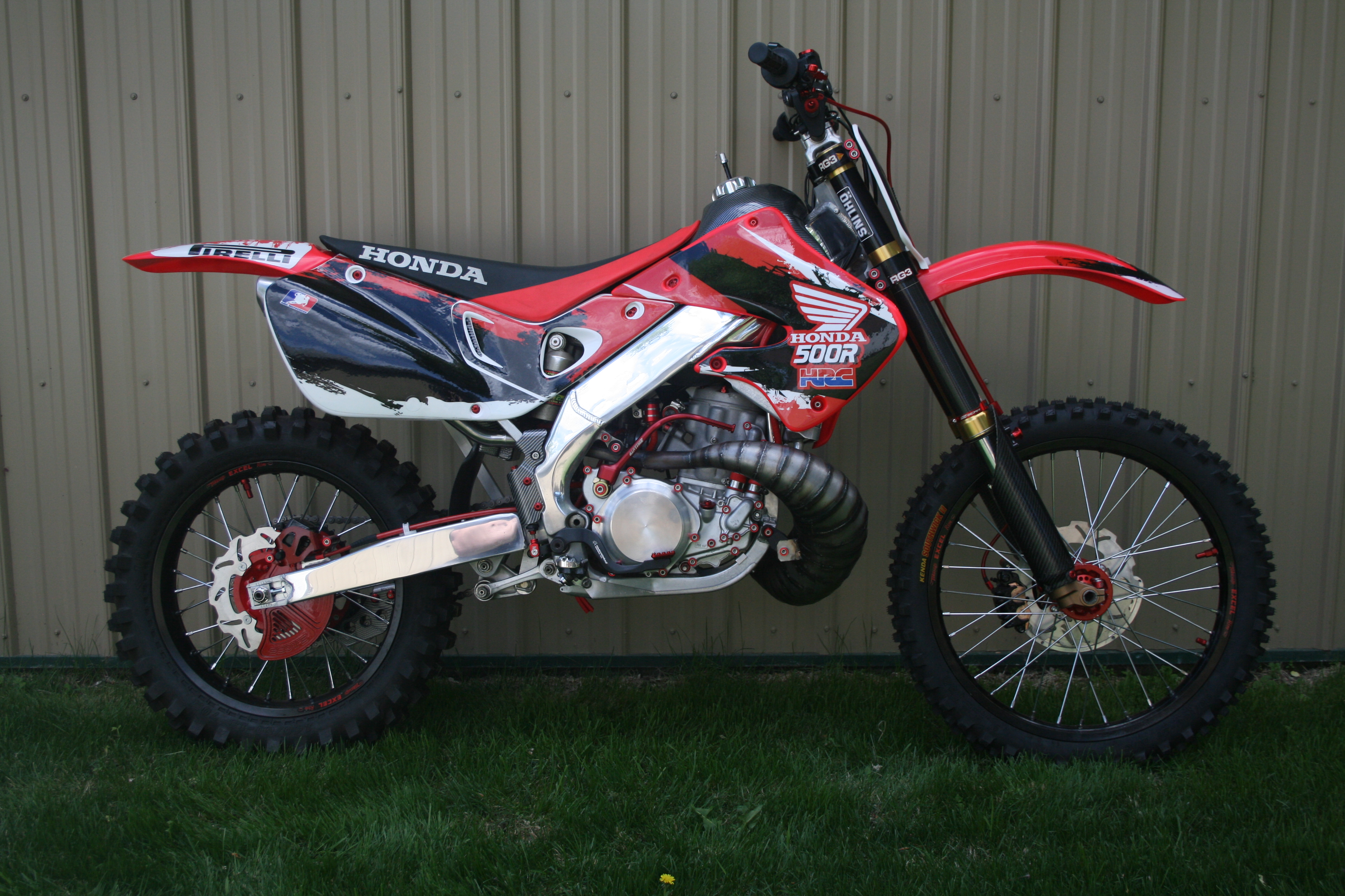

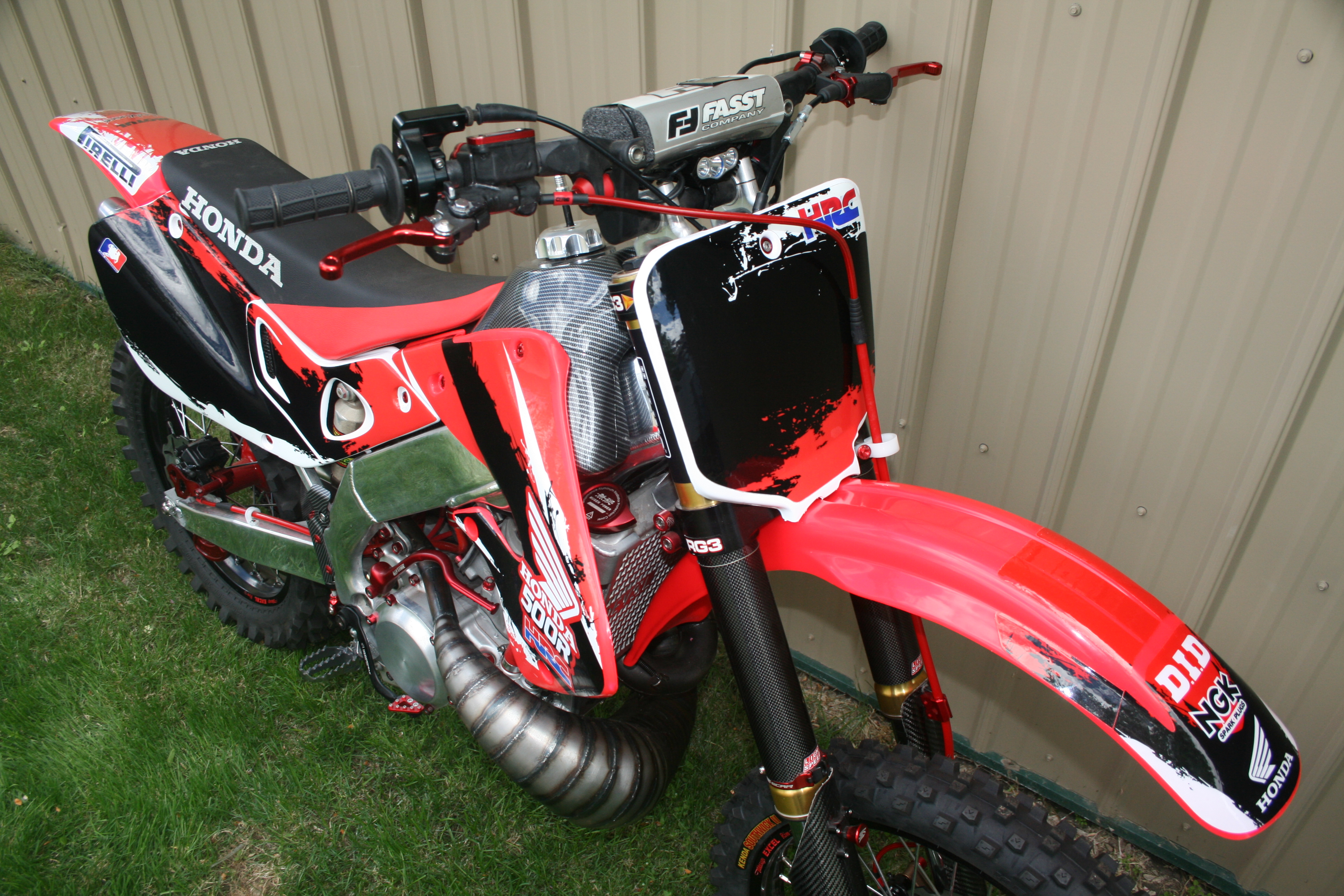

I am calling this build finished!
First off, thanks to Danny, and Shanman for the advice and conversion kit.
Also thanks to everybody before me who has built one of these!
I took it out of the kitchen today and out into the cold Canadian air.
(its about -15 F today for you non metric folks to the south)
The first thing I have to say is that it is not a good idea to try and start a 1985 CR500
with a shaved head and Cr250 kicker while wearing skateboard shoes in the winter.
After about 10 kicks, I had enough of that, and went back inside to put on one of my riding boots.
3 kicks later it was ALIVE!
In the next 30 seconds, a foot peg rattled off (no cotter pin),
and I discovered my kill switch didn't work. (loose connection)
I took it for a ride up and down the steet a couple times,
and back out to the garage to retorque everything.
So far all I can find wrong is that my fuel petcock leaks,
but only when turned on.
Anybody thinking of doing a gen 1 should not hesitate.
These bikes go together almost like factory.
Here are the finished pics.
I didn't put on all the decals that came with the kit,
but I may add a couple more. I think it looks good as it is.

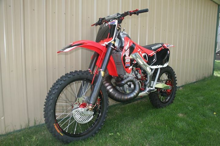

So this is actually the 99 that I started building so many years ago. The skull bike was a 97 that I built with most of the stock parts from this 99.
Yah, I'm from Saskatchetoon!
Nodge
Posts: 527
Location: Saskatchatoon
Re: Nodge's Gen 1 '99 CR 250
Post by Nodge »

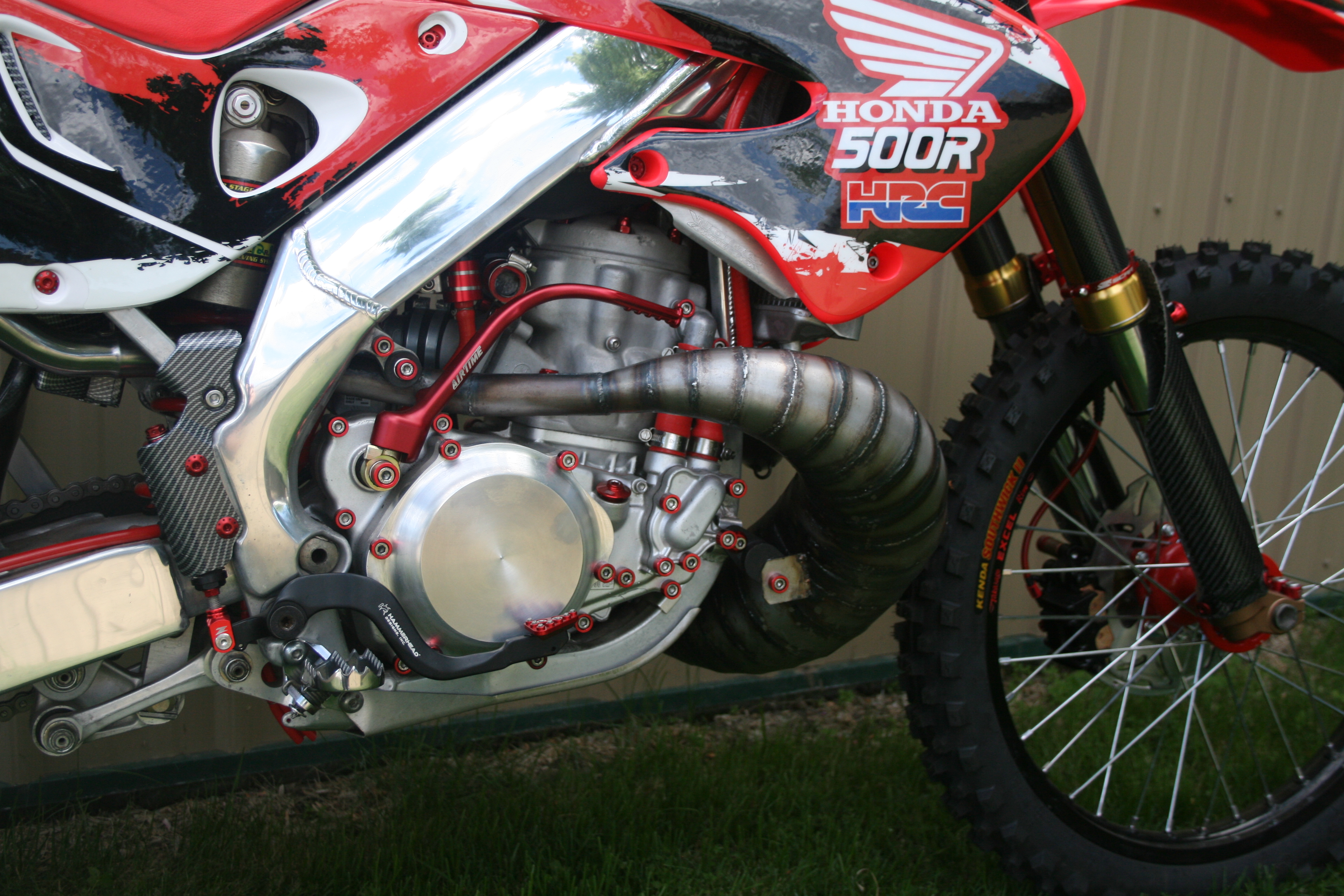

Kuma
Posts: 854
Location: Norco, Cali
Post by Kuma »
The pipe looks wild, lots of welding, is the front tire going to clear on full bump?
