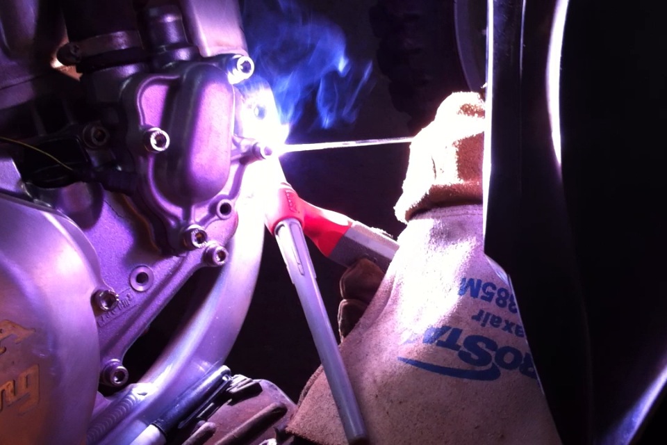

Bro can make a heck of a nice job in any place, here I didnt want to pluck the motor out so instead of a queer, left handed weld I figured he would attempt the guy go cross handed for stability and welds it without getting heat near the engine cases.
If I didnt need to spend time with the kids I could have been starting it up lastnight. This weekend I'll get it running, tuned and posted for sale.
