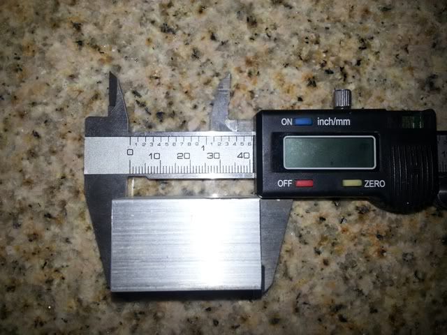

Now its time to make lower frame inserts. Algava made his from 3/4" X 3/4" solid billet, and built up welds to flush out with the frame tubes. I made mine from 1" x 1" as to not need to build up as much weld.
I cut the square stock to length with a band saw, then squared the ends on a mill.
Next made 1/8" deep cuts at the ends so the could insert into the lower frame tubes. I used a 45 deg. face cutter to leave a bevel for the weld.
The one on the left is top view, the one on the right is side view. I made the spigot on the front shorter than the rear, you can't stick them in as far due to the curvature of the frame. Also notice the side view, the more nibbled side goes down and front, its cut more to accommodate the frame curve.
