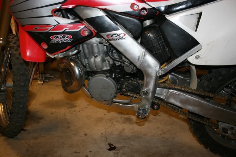

More updates. Motor is done and re-assembled, and installed. Ended up making some head stays - came out good!
Another shot:
Coil:
Radiators:
Will have to space the right rad due to Y being raised. Left side hits pipe. I may have to heat the pipe and adjust it some...ugh. Anyone else encounter this?
Desert tank clears without modification:
Trial fit subframe and tank. Cut off rear pipe mount. Had to modify front pipe mount holes. Exhaust has a lot of tension on it when bolted into place...wonder if it got tweaked or thats just the way it is. :?
This process is time consuming! Well, it'll be all good when its done...hopefully soon!
Its Done!
Update! Since my last post, I realized that I did indeed tweak my pipe at pismo. Straightened that out, made a lower rad spacer on the RH rad to clear the Y. Extended the coil signal/ground wires. Exhaust was tight getting it on - but its on.
I finally got the rest put together last night and wanted to take it for a test ride. Too bad it was pitch black outside due to no moon being present. Ugh. Primer kicked it like usual and started on 1st kick! So I took it for a quick spin up and down my driveway. My initial impression was DAMN! Where'd my vibes go? It is really smooth. And wheelie action is insane. Also realized that my brakes need to be bled - found that at the last second... :shock: Also realized why the PO used some sort of sealant on the side cover...as it leaks oil past the gasket areas. :x So I have to bleed the brakes, take the side cover off and seal it up. Anyone else have this issue of leaking oil?

and on the pile of 500 motors I have assembeled repeatedly, I've never had a leaky side cover :?

The 98 with the 01 engine in the first picture on page one won't go far without a chain on it. :lol: :lol: :lol:
