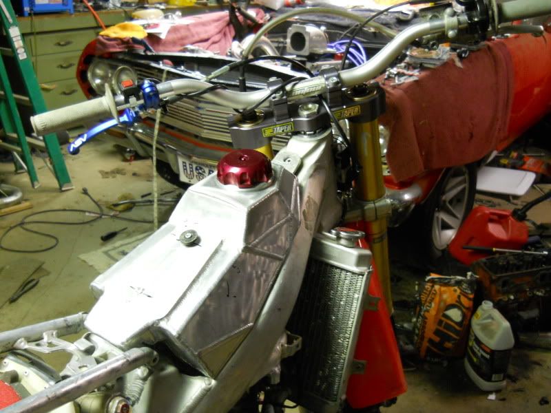

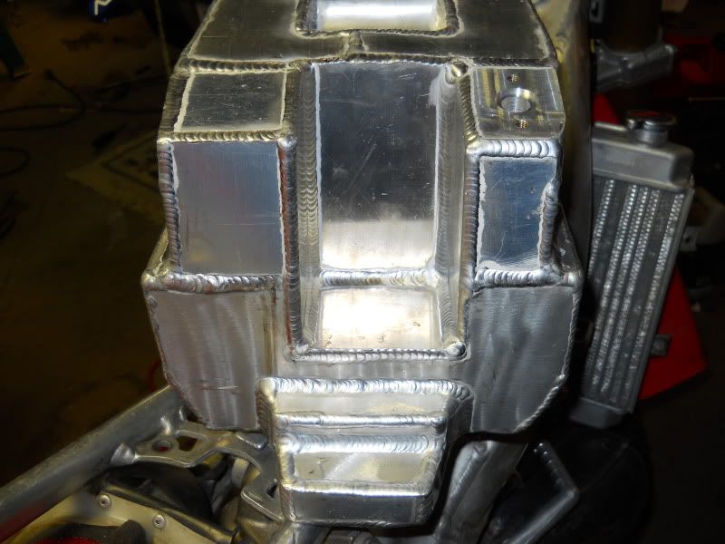

Getting work done on my 2004CRF 250 and 87 CR500 Engine
Today was pretty laid back with the big Christmas lunch and a lot of people gone, so I jumped into the tank with relish. I welded in the machined mount for the outlet and even cut loose the thin piece of sheet on the front bottom of the tank and replaced it with an thicker piece. I thought that part looked like shit and wouldn't have been hurt if someone told me so.There's also a plug relief in there which is only a split piece of 1.25 tube with the ends welded up. After I get it cleaned up next week I'll get the mounts and start on the shroud mounting points. She's getting closer to being alive.
Finished the closeout welds on the tank after getting it flushed out real good and have the front mount tacked. Hopefully I can start the drilling and tapping for the seat mount and tank strap tonight. I'm hoping to dig up the fallen leaves in the back yard this weekend and I'll try to get a video of the maiden voyage. I do want to re route the throttle cable to add a little slack and mount the blaxk box with wire routing.

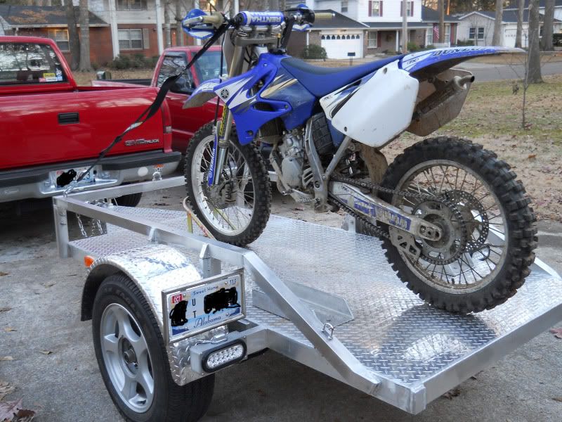

DC works great on stuff from ~.150" thick on up. It's a handful with lower gauge stuff but is still doable if you heat sink it right. You're using pure helium also, so there's absolutely zero cathode cleaning action that you get when using AC and argon. With DC you can have a block of aluminum 12" thick square and throw a piece on top of it using a small TIG torch and .062" tungsten you can run a tight bead around it with no preheating. It's a handful on 50 series aluminum and of course magnesium, but I have made class 1 radiographed welds on these alloys when I had to. The trailer is pretty much done as I got the wiring and lights squared last weekend. It was welded in my back yard using DC and took a full bottle of UHP helium. I'll get a newer picture and upload it. Just got a nice set of Arrow carbon/kevlar silencers mounted on my RZ and took it for a spin. Talking about a motor with potential the RZ350s are great. Back to work. Most of the tank used AC except the top thick piece where the seat post threads in to it.

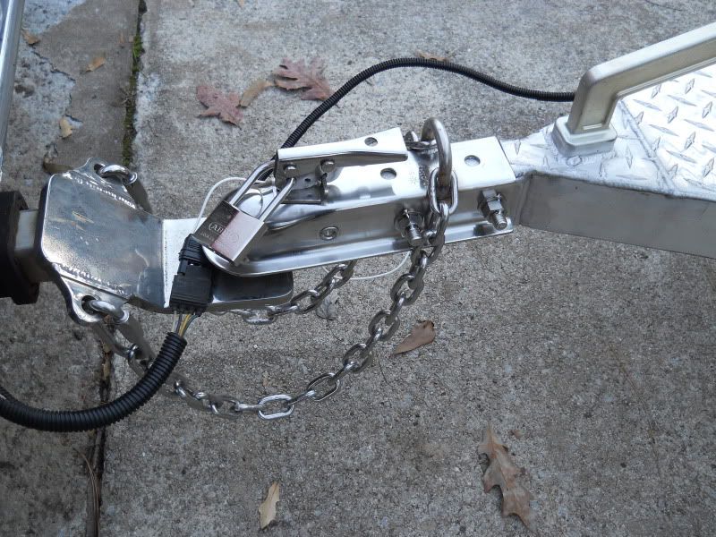

Took the trailer on its maiden voyage with the little YZ and it did great. Closed out the tank as well. Don't like the hump on the bottom but I don't feel like cutting it right now. It won't show anyway. Getting primed for the live SX race. The hitch and all of the hardware up front is stainless.

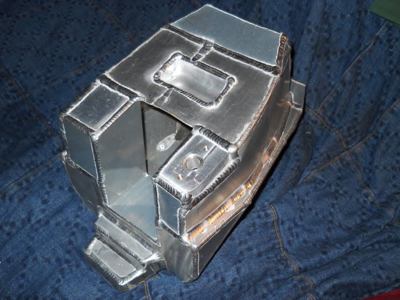

I'll fill it with water to check it for leaks and measure what comes out. Instead of drilling the rear of the tank for the tank strap mount I'm going to weld one on.

Man that trailer is awesome! That is a sweet way to haul your bike with class!!
I had been told it was possible to weld aluminum with dc tig but everyone said it would be ugly welds. Obviously they had never seen someone who knew what they were doing!!

that tank is wicked man. is there a reason you are building one and not using a plastic tank?
i would air pressure test for leaks. just remember you use a VERY low pressure for that.

Getting work done on my 2004CRF 250 and 87 CR500 Engine Goto
I appreciate the kudos guys. What's cool about this site is the shooting the shit with people all over the world who enjoy the same things I do. I've seen a lot of unreal stuff here much of which I've tried to emulate. I'm lucky to have a lot of neat equipment and friends like machinists, water jet operators....If I had it to do over on the tank I'd have left off the thin crap on the bottom and used at least .090 for ease in welding and less distortion. The thing about DC welding is cleanliness. It has to be very cleaned and in over 50% of the time balloon grade helium will not cut it and the weld will go in and look like shit. You pretty much need .999% purity (UHP) which is about $100 a bottle around here. The only DC on the tank are the two long welds on the thick flat part where the seat covers. It's snowing big time here so work tomorrow is questionable. This week I'll have it measured for capacity and start the shroud mounts.
