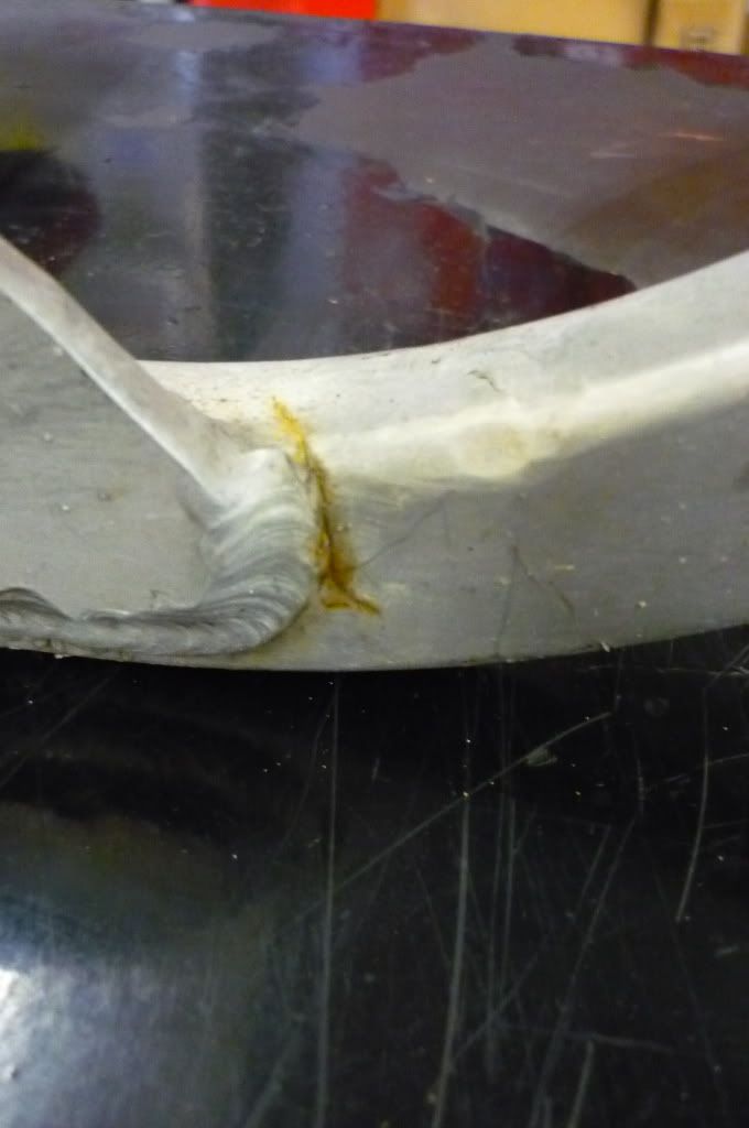

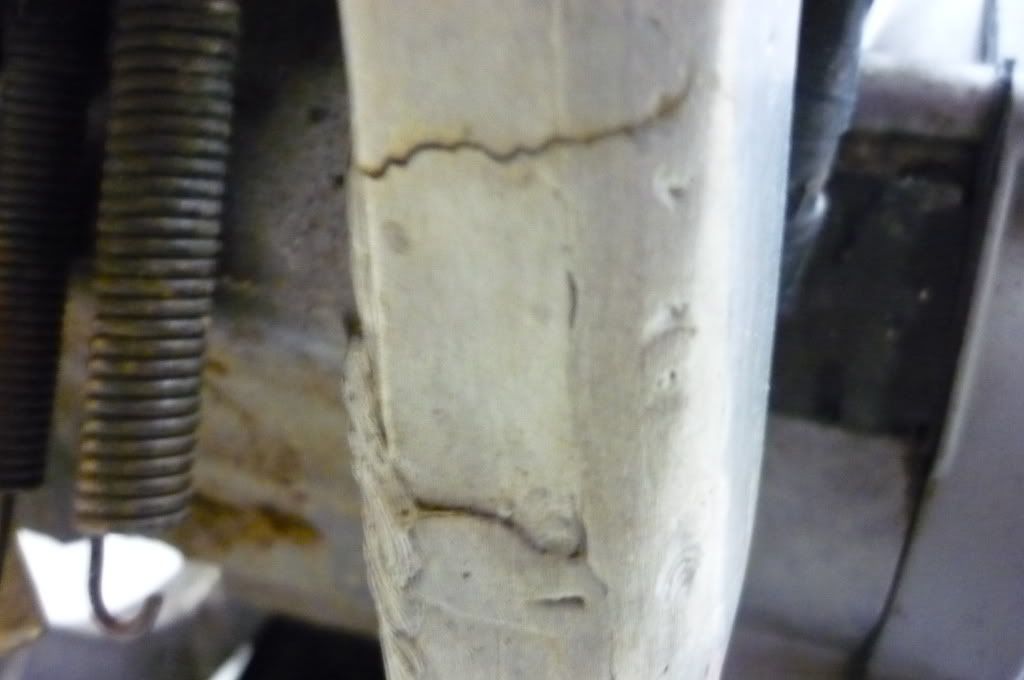

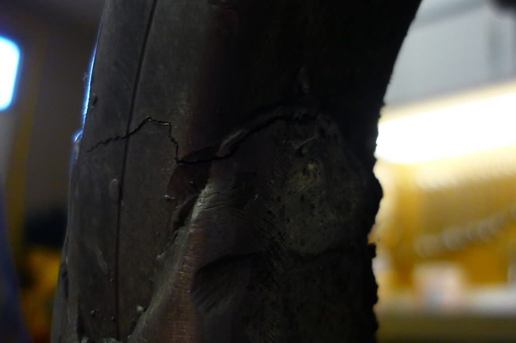

This is a chasis I bought already converted. I knew the cradle would requires some work but never figured I'd find it almost destroyed, once i got the pipe off it, the damage was clearly visible.
It was still a decent deal considering the components it came with.

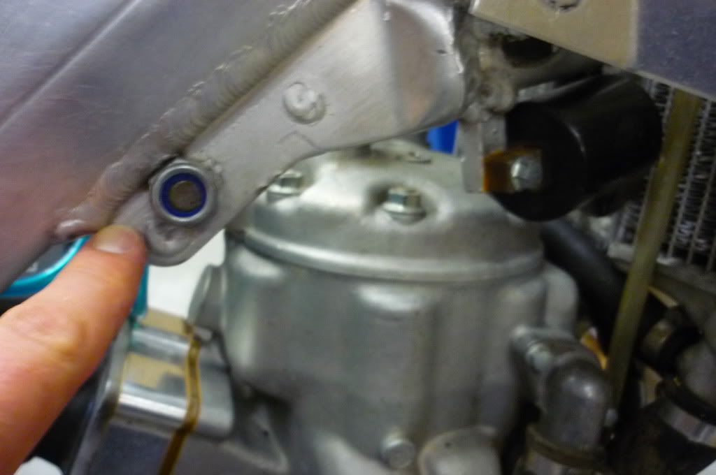

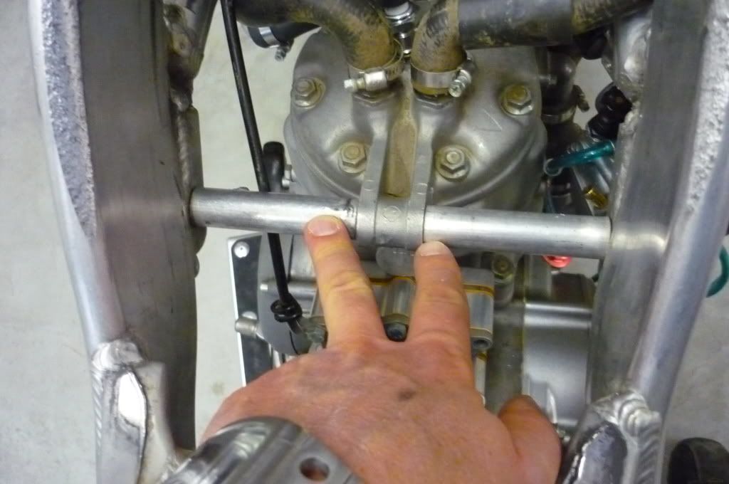

There is no lateral strength in the direction the motor rotates when it applies torque to the chain.
The motor is able to apply torque across the front and lower motor mounts, which lave less leverage over the top of the engine , the part that rocks the most!
The traditional design like the original oem headstay is much stronger in all the angles required.
The result was this frame that was repaired so many times ther was nothing left to fix. It needed replacement:

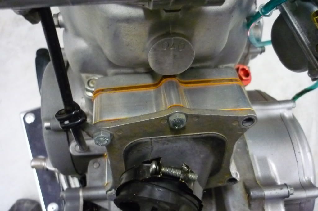

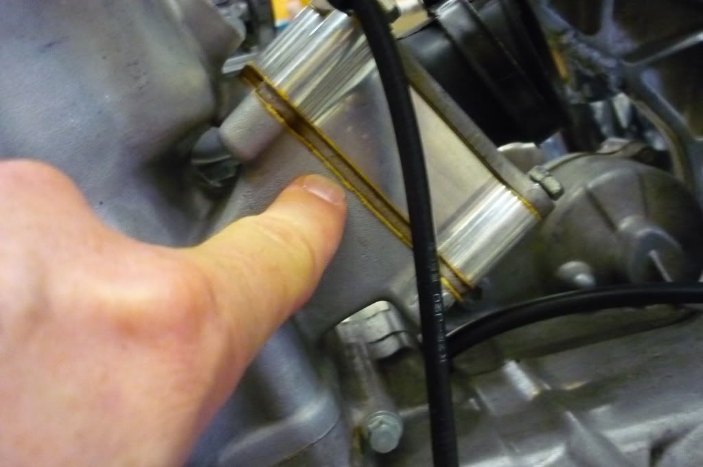

worlds longest reed spacer....

wtf is that spacer doing on the wrong side of the reed, and its giant!
I think just the weight of it is what cracked the frame!!!

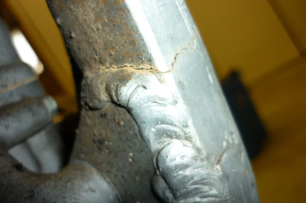

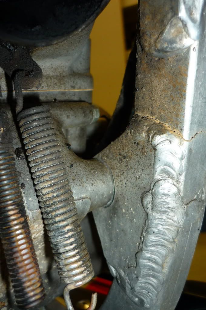

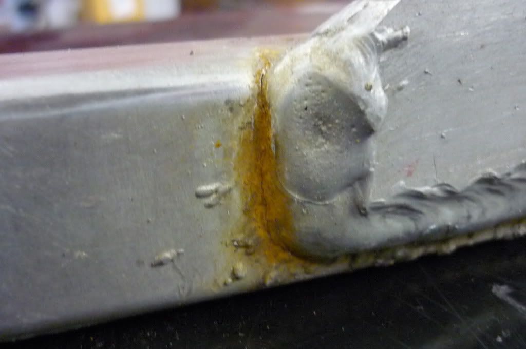

Why are the lower motor mount welds contaminated with iron oxide...

why was the headstay not built proper
why the short air boot and long reed spacer

why bubblegum wirefeed weld cracks, instead of fixing the cause of the problems.

That might be some type of dye penetrant leaching out from some of the cracks. Once it gets in the crack it'll keep coming out until it's fixed or in this case possibly scrapped. It's just a possibility. There are tons of cheap four stroke frames on eBay every day.

I posted to display how an improper head stay can allow engine vibes and torque to destroy a frame.

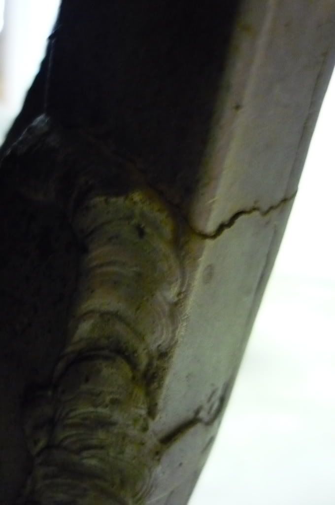

i could be wrong but i dont think headstay had anything to do with all your cracks. theres 3 solid motor mounts controlling torque :wink: . dont think vibration cracked anything either. cant recall ive ever seen a head stay on a drag qaud. alot of them have 2x the torque our bikes have. cracks were all in the heat affected zone of the weld, were the temper has been erased :wink:. blame the welder
Clyde, look how much the motor is moving around...
I think a good head stay is a requirement.
I also "match drilled" all the motor mounts to the engine cases. using oversized hardware. Took all the slop out of the connections.

AlisoBob wrote:Image
This motor has been sitting in this chassis for 5 years.... ZERO movement.

100hp honda wrote:i could be wrong but i dont think headstay had anything to do with all your cracks. theres 3 solid motor mounts controlling torque :wink: . dont think vibration cracked anything either. cant recall ive ever seen a head stay on a drag qaud. alot of them have 2x the torque our bikes have. cracks were all in the heat affected zone of the weld, were the temper has been erased :wink:. blame the welder
blame the welder your the man 100 dont worry about the under engineered head stay that is the obvious cause the welding isnt nice but glad you chipped in

the welder makes or breaks the job. should of completely wallered out the engine mounts before anything cracked :wink:

the welder should have used TIG and hand fed the alloy rod in there, those ginormous aluminum MIG welds just stack a cold pile of alloy right on top of a seam with no real penetration..... maybe the welder (machine) and not the welder ( hillbilly fabricator) is to blame..... either way most fabricators know tig is stronger than mig in this particular application.....

Ya I noticed the welds were mig, and am going after tig.
Either way it will be fixed right and i recycled a 500!

Another frame breaker is not having the right bolts holding it together- if they are too skinny the motor will move around and shake it apart.
My current frame I used regular width mounts so I could use the original bolts- real happy with that decision I haven't had to tighten them once in the last year.
03 CRF450/85 500
bearings??? I made a gen-4 250 that had some shitty welds, but was put together properly and it held together great until the rod bearing went, then it was riddled with cracks. All of those cracks look vibe related to me. I am not saying that was a well done conversion, I'm just saying, a messed up motor will vibe cracks into any frame if it vibes bad enough.
