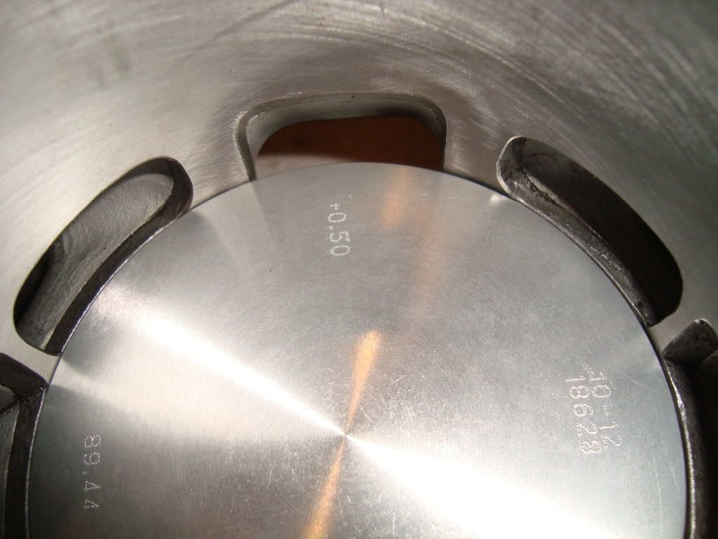

Heres looking down the throat. So many times I see some backyard porter grind away here. Hello? The reed cage fills all this area. :roll: Roosty left it alone, and just worked on the boost ports.

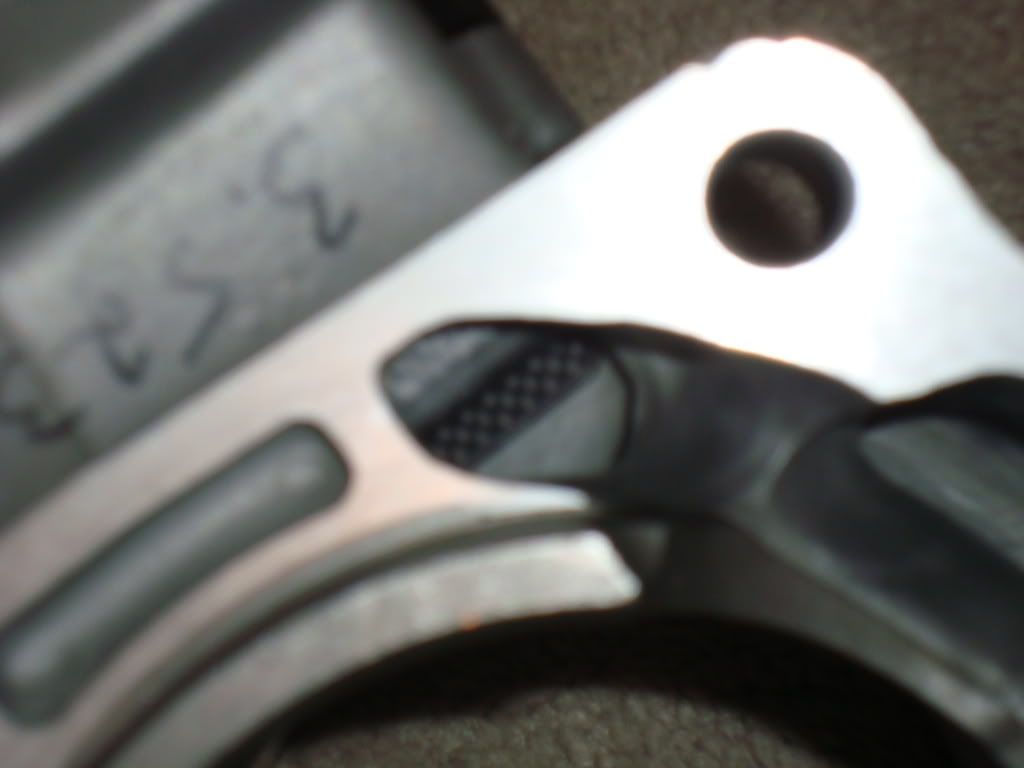

Heres how the VForceIII cage fits the jug, Adam feels it extendes too far into the throat.... so he makes a nice spacer to pull it back a bit.
Like so..... :D
Heres the spacer, along with the intake boot. Roosty ported the boot too so there is no "lip" where my 41mm PWK slips in, and its port matched to the VForce reed block.

Heres a shot of the cylinder finish. I asked Adam to plateau hone for me. This involves bringing the cylinder to size, and stopping short of the final size, and then using some ultra fine stones to finish th jug.A plateau finish is one that is very smooth and has lots of bearing area to support the rings, but also has decent crosshatch depth to retain oil and provide good ring lubrication as well. Whats missing is the metal that was folded over during the boring and rough honing operations.
A plateau finish essentially duplicates a broken-in cylinder. In the old days, cylinders were honed to size, and the rings did the final finishing of the bore surface. But this required a lot of break-in time and shortened the life of the rings... with what Adam provided for me, my bore is round, sized correctly, and will stay that way AFTER break in... as the folded over material has already been removed..... :cool: :cool: :cool:

No case work was done, the engine is in bobs bike and wasnt to be removed incase a rida came up. I did what i feel is the most the cylinder can have done and stil be good for the long rides. Using gas is one thing, making peaky hard to find power for trails is another, this is neither but i expect a ride report to reflect Bobs opinion.
You might have noticed no epoxy in the rears, i do other things to favor other ports, this works better. As you'd expect there are parts of the cylinder that physically cant be seen or recognized with the camera that get work aswell.
The head is an R casting, every other head has a narrower squish. This is modified to work like the older heads, BETTER.
.005" was removed from the base, guys will tell you .020 is the number to chase, it completely depends on purpose. With the cometic base gasket used bobs cylinder is .010" lower than stock, it does not run the piston off the exhasut port at tdc, and can possibly add some torque to the engine.
vforce had it right with the vf2 if we're talking length. the vf3 is back to matching every other reed manufacturer, i expect this is becasue of the other aplications its used for, I'm very dissapointed in those boys.
i'm not going to say that everones cylinder will look identical either, there are things i do differently for different applications, some very drastic.

double check the vforce3. had to modify the intake on mine to make them fit better. maybe its a personal thing :confused: . mototassinari said it was normal for the flappers to be smashed down when inserted in the intake tract....... seen alot of other motors and it just didnt seem right to me.
