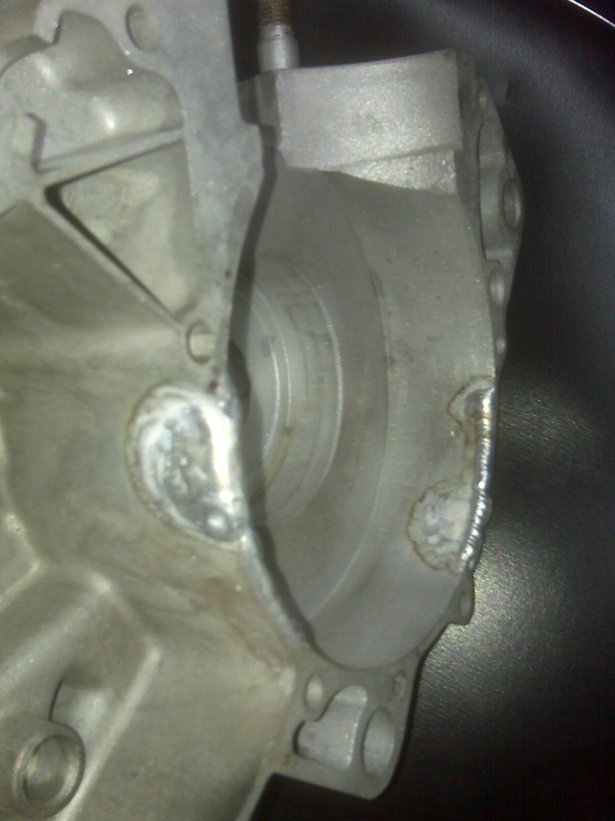

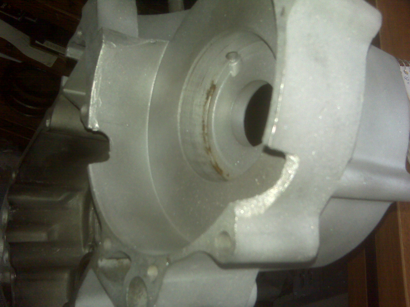

had a rod break and it took a 1/2 x3/8 chunk out of the case where the crank fits in, should i try welding it or get a new one

personally if i was still back home in PA. i wouldnt think twice about having the local welder guy weld it up.. he fixes all the coal truck beds and is a dirtbike rider himself .. has a huge shop and all the right tools.. he learned from his dad (R.I.P.) and knows his stuff..... really dont see why ya cant weld it up as long as the welder knows WTF hes doing...
if you dont have the ability to weld it or machine it back it can be a pain.

dont know how to post pics , dont look like its in to bad of a spot its up high

we have repaired a cr 250 that holed the cases thru a dropped piston skirt needs to be a welder with some skills

Welding the cases is no big deal, its having the ability to properly machine them back to working.
I bought a 1987 case on ebay for .01$ + 5$ freight :lol:
i blasted it, welded it, got the boring bar in it and sized it, then surfaced .002" off it to make sure it was strait. Its running excellent, was the first engine in my AF, sold it to bro for his conversion after i put my ported engine in.

its almost in the same spot and size

i had a set of cases where a broken rod had gone right through the bottom and made a huge whole on both halves. welded it up and worked great. looked funny from the outside the weld was a perfect heart shape.
it can be done.
weld it :wink:
