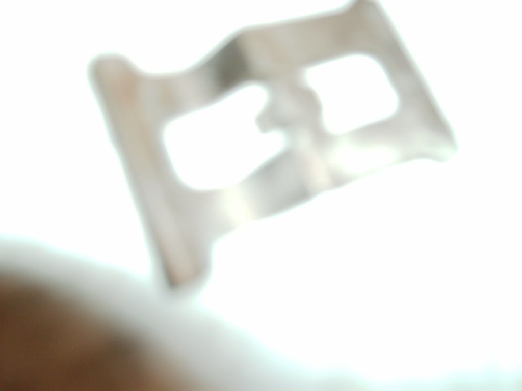

so i went to put my new rear brake pads in and this thin ss shim thing fell out and i dont know where it goes, i put it together anyways and the brakes seem to work fine...
is that piece important? and where does it go? its also bent in a weird shape, i had an issue when i got the bike putting the wheel on maybe i bent it then?
so do i throw it in the trash or try and fit it somewhere?
also i was ready to not use the ss heat sheild because it was a little bent and just use the asbestos/fiberglass on the caliper side but then i noticed the ss sheild was turned gold in a small spot, i thought i was going easy on the brakes :shock:

it is held in place wit the caliper body, and the brake pad pin... unless you pulled the brake pad pin, it should not have fallen out....

if you dont use that your pads will chew your caliper up one goes on top the pads one one goes in front in the notch . the one in the pic is the top of the pads and acts as a spring to keep the pads from rattling around. if you roll the wheel and hit your break you can hear a click that is your steel pad hitting the aluimium caliper.

if you look carefully for wear marks on the pads and the caliper and the bracket, youll be able to work out where it fits. if its a low km bike, there may be no visual signs.
no wear marks yet :cry:
i pulled the pin
tried every combination with it on top ans it ends up hitting the rotor when i hit the brakes so its prolly bent, so ill have to get a new one

2strokeforever wrote:did a race and preriding and it seems to work fine without, so im saving weight :lol:
the brakes will work fine, but when that piece wears thin, you can replace it....when the pads eat into the caliper....theres nothing to replace.....
