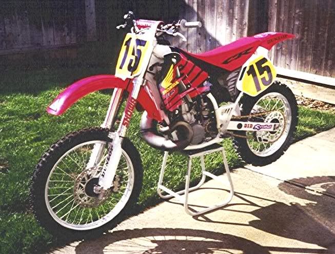

What year 500 did you race?
I raced them from 1990 to 93. I'm posting a picture of my '93.
The vibration level for all my 500s was only high when compared
to a 250; not objectionable, but not welcomed toward the end of
the moto.
