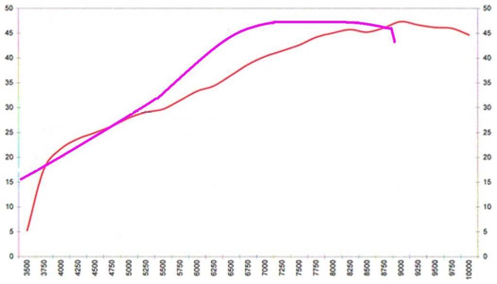

what id really like to see is a big bore rotary bike heres a dyno chart of a 50cc rotary motor!!!!!! 48 horsepower!!!!!!!! look at the torque curve (blue) 34 lb-ft of torque!!!!!! a 500 only has 45 ft lbs and its 50cc!!!!!
take a good look at the dyno chart....
the peak power is only at 9000 RPM, thats low for a 50 cc motor and the best part is there so under developed that theres plenty room for improvement
heres the same dyno chart with a ktm 450 (in pink) Wink added on
keep in mind the 450 is 9 times bigger, so id say the rotary has insane torque, remember torque is measured and hp is calculated using it.. so if a motor has more torque at X rpm than motor B it means it has more torque at that rpm too
(RPM X torque) /5252= horsepower
