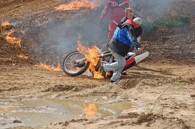

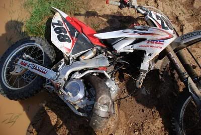

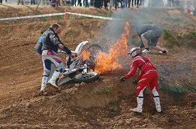

So this is the second AF death I've seen on the web. Notice that they're snapping at the spars and top of the Y? Was this shoddy workmanship? WTF? :?
The same recessive gene thats causes the British to have nasty teeth, appearantly hinders their welding skills as well....
ZETTNORCAL
Posts: 202
Post by ZETTNORCAL »
I saw one get welded up with a billet Y just the other day. The guy just went ahead and started tig'n the solid Y to the tubing :shock:
When I built mine I reused the Y (crf250). I used solid square stock for the extensions and machined them to fit into the stock tube cradle. But when I welded it I preheated the solid stock with the torch to I,m guessing around 450 -550 degrees? Before welding it to the Y and the stock tubing.
Looks like thease bike that are braking in half were not properly welded at the Y section, and it seems that they all had solid billet Y's :idea:

probly broke near the Y then the rest of the bike folded in half. wonder if he welded on the spars aswell ? maybe coil mount or something else. still i think the root of the problem started near the Y though. same scenario as the other broken bike. might sound stupid but exactly the reason im going to find out what alloy honda used and whether it needs to be re-treated :cool:. still aint made it to the metallurgist yet :cry:
Gmbond
Posts: 381
Location: Ontario Canada
Post by Gmbond »
This makes me wonder if the billet Y pieces are too stiff and instead of flexing like the thinner stock pieces it cracks or break above/below??
Gmbond wrote:This makes me wonder if the billet Y pieces are too stiff and instead of flexing like the thinner stock pieces it cracks or break above/below??
I've said this from day one.
:idea:

I know of four frames (in the UK) that've broken. Two of them broke on the Y piece welds and it was found before the bikes came apart - they vibrate really bad when it happens. Bear in mind that the UK is only 680 miles top to bottom so any news here gets around the whole dirt bike scene - especially bad news like this.
The bikes which snapped appear to have broken at the Y but continued to be ridden (maybe only for one jump). When the Y comes apart the stresses have to go somewhere and the spars are the obvious fulcrum point I'd thing. Standard Honda frames are known to sometimes develop cracks inside the spars right where the two broke so it seems it's the weakest point (on an um-modded bike). That said I've never seen an un-modded bike snap in half.
The two bikes which did snap used modified cradles and Y piece rather than Billet. It's most likely the failure was due to bad welding rather than the material used.
