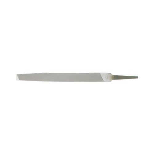

by eyesky2002
This is what I used, but you already had the Y close my friend!!!
![Image](https://bannedcr500riders.com/images/auto/b263a17051ccd9197d51c8f7c9f74538.jpg)

eyesky2002 wrote:This is what I used, but you already had the Y close my friend!!!
Been pretty familiar with that tool on this frame too.
