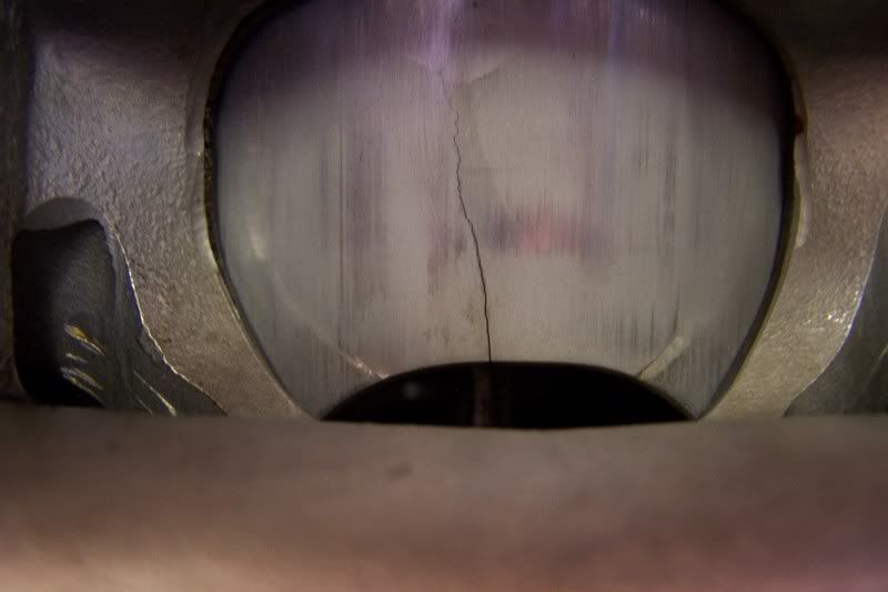

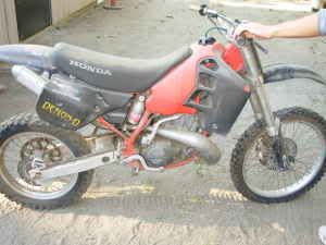

My 2000 with a 20 yr old motor still fired up cold withing 4 kicks and ran perfect at dumont last time out, the big end bearing had gone and she had sucked the needles through the transfers and into the combustion chamber the only sympton I had was lower than usual compression and a tranny that became hard to shift sometimes when under a heavy load.
When I pulled what I thought to be a top end needing rings I found the above issues, when I split the cases to remove the crank I found a broken gear in the tranny, a blown bearing and all kinds of metal and shrapnel.
Here what I found when I pulled the head.
