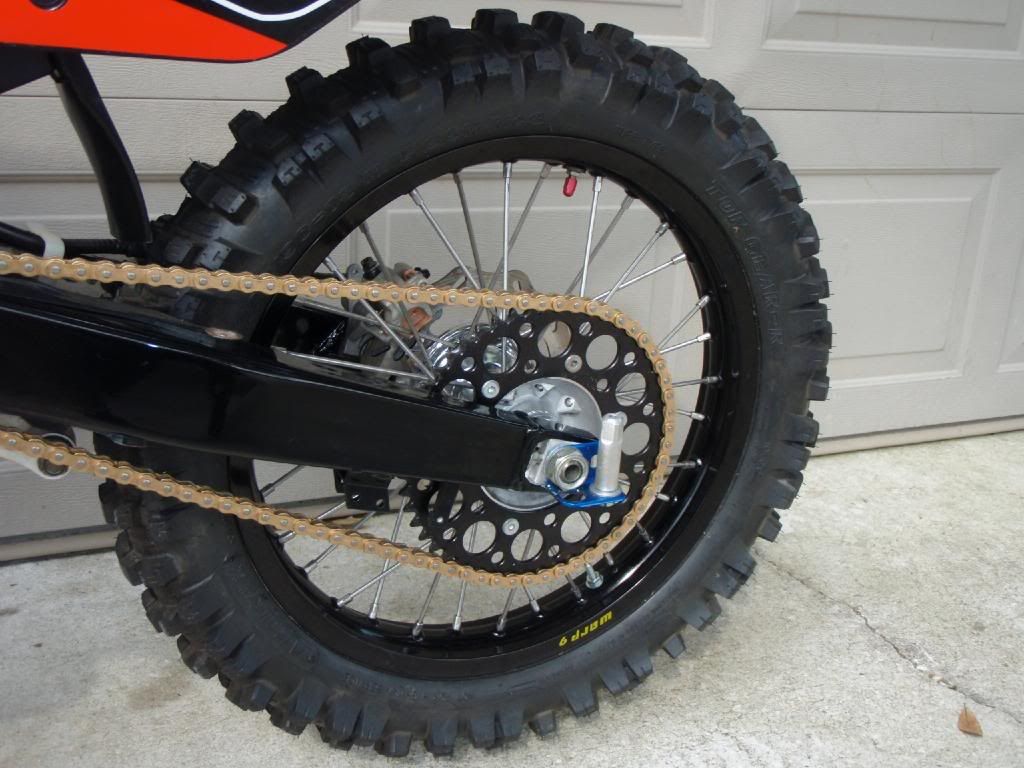

oh, and watch out because it has 215 lbs of compression :lol: and he used "double mix" to break it in :roll: :lol:
oh, and Bob, don't even look at the chain, it will only raise your blood pressure :lol:
dannygraves wrote:oh, and Bob, don't even look at the chain, it will only raise your blood pressure :lol:
:lol: :lol: :lol:
I don't think he can get it much tighter. :roll:
yeah, I was not aware that you are supposed to use the adjusters to preload the chain! :shock: :lol:
dannygraves wrote:yeah, I was not aware that you are supposed to use the adjusters to preload the chain! :shock: :lol:
:shock: Wow is that what I am doing wrong, not preloading the chain. :roll:
:lol: :lol:

I guess the chain was so tight, the rear chain guide wouldn't fit?
I also like the multiple use of incorrect fasteners...

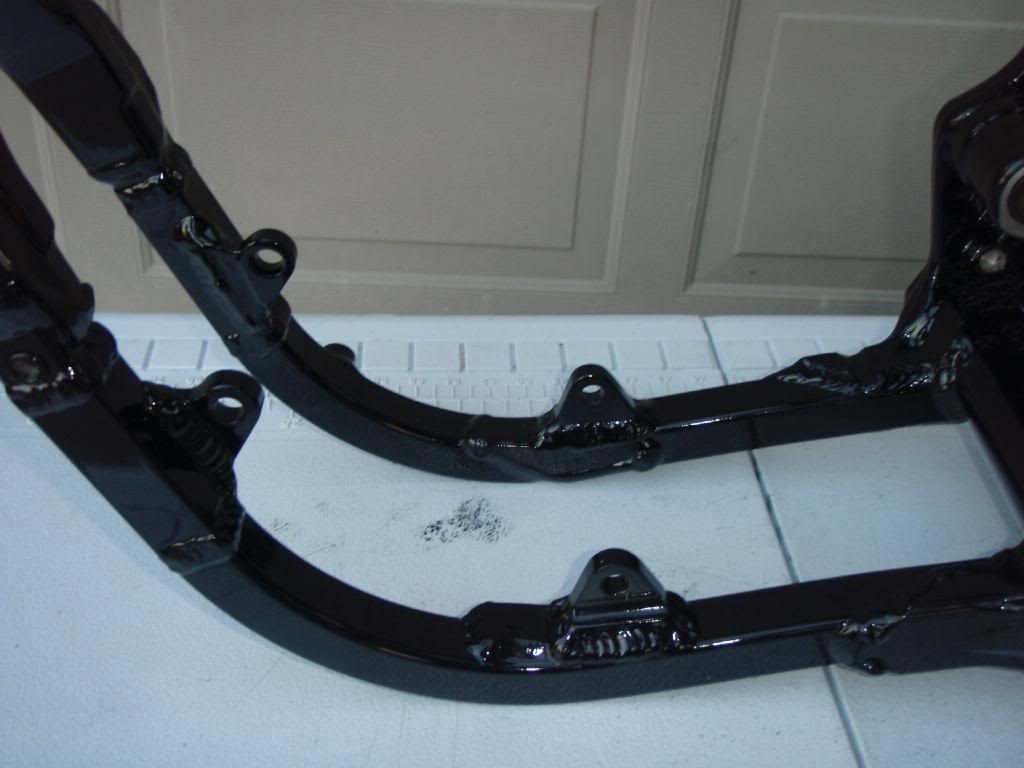

why not take 30 extra minutes and grind off the bottom of the old motor mounts ? WHY WHY WHY. MPS sucks and that guy is a tard :D

My frame..... done by Uncle Crackers brother.
Look at anything welded by Chachi, SOLID Bro, those damm Aussies..., or some other bikes....
Finding a good "Tig Master" isnt all that hard.
I'm not impressed with the bulgy welds, but I agree with leaving the floor of the old mount on, theres a good chance that no matter how you remove the old one there will be a "soft" spot where the frame was welded, we all know how the aluminum will puddle or flow into the weld. I'm thinking that the tube at the weld joint is probably thinner wall than anywhere else, cutting off the weld, which is partially the opriginal tubes material in theory will make it weaker, not less grade, but just thinner.
So: Leave the floor + learn how to weld
