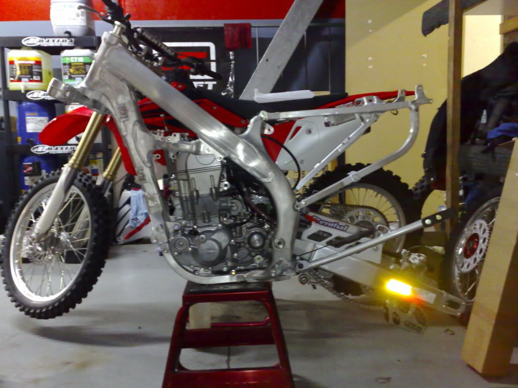

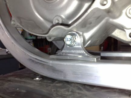

Hi guys

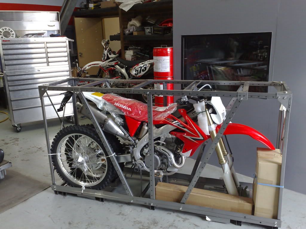

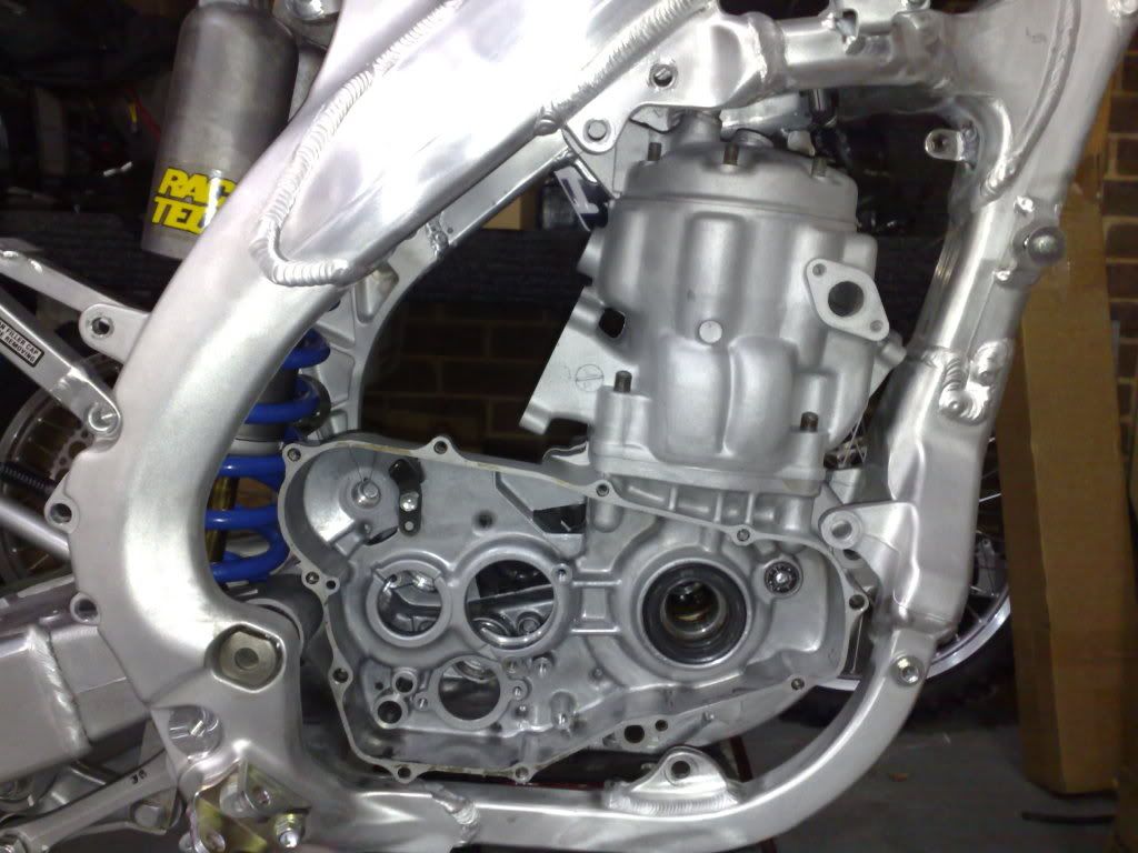

we are getting close to finishing the first of our 2 450x conversions
hopefully the pics will work
this is Beans bike
i will put some more pics up soon

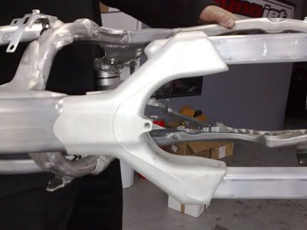

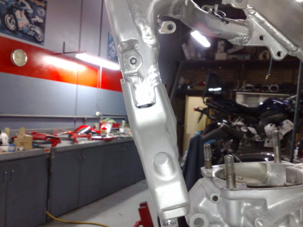

Is that Y section a brand new peice or a well cleaned up original.
Well you have made a nice start so far.
How much clearance have you got between the fuel tank and the plug and water outlets.
2009 CRF450X :?: I presume.
That 450 engine is one UGLY LUMP OF SHIT. :roll:

its an 2009 450x
stripped down straight from the create
the Y section was cleaned up and re-used to keep the original look

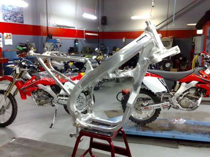

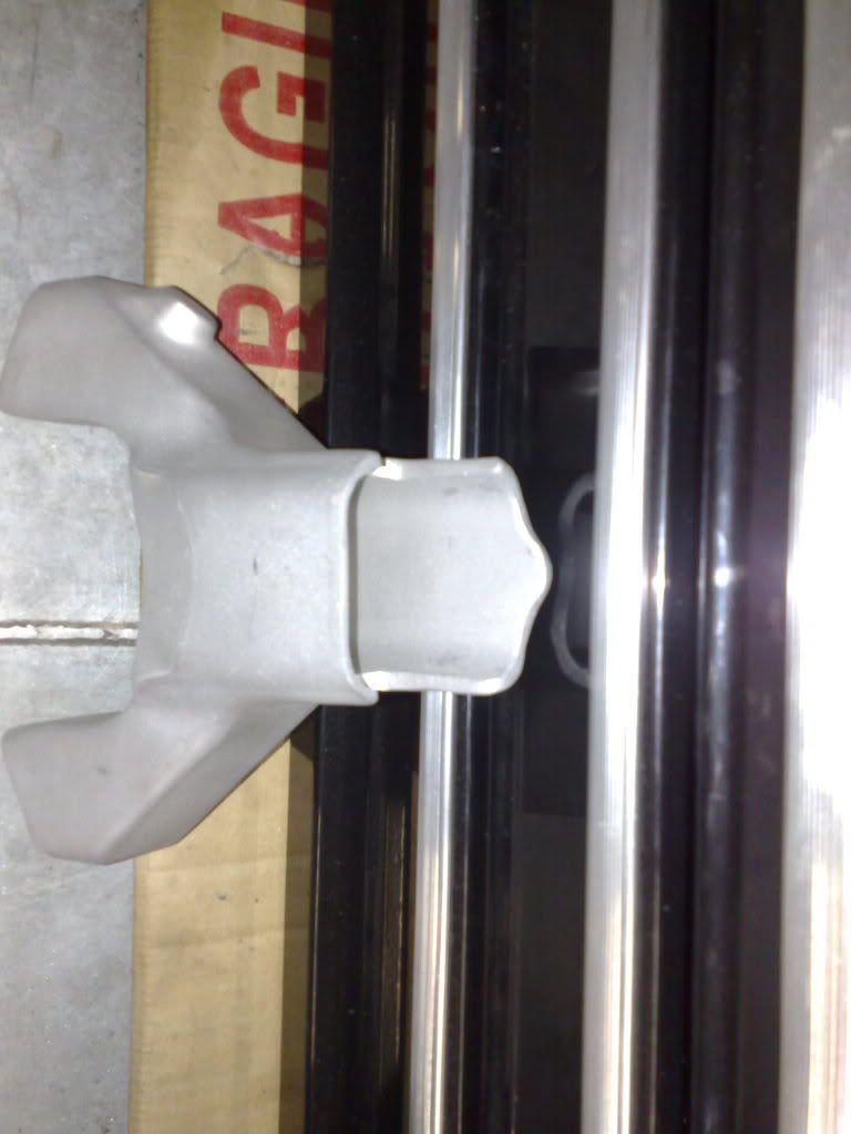

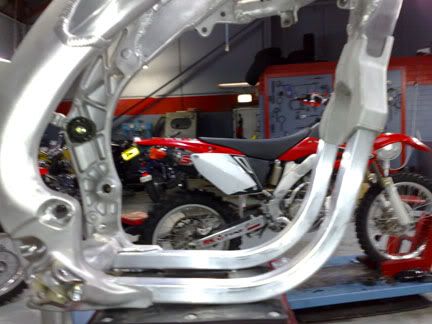

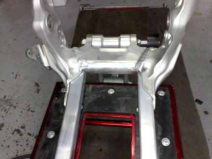

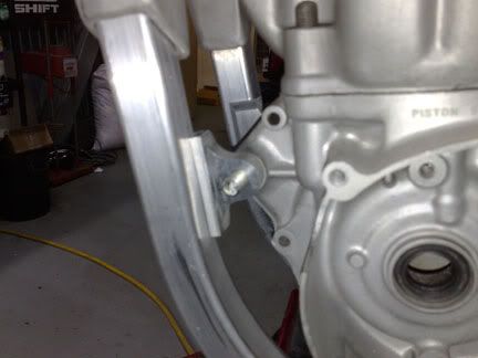

we have gone for the full cradle replacement

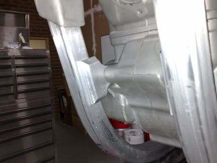

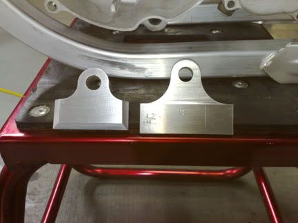

we made the engine mounts
these are the first attempts using the mill

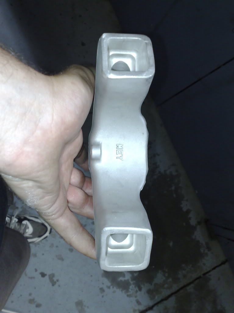

That's lookin sweet guys! What radius square die did you use in the tubing bender?

Mik329 wrote:That's lookin sweet guys! What radius square die did you use in the tubing bender?
we rolled the tube with a mandrel tube roller to 73 deg
i think the radius is 115 mm

these bikes will hold only the name of WMW as they are built by myself and bean for ourselves out of a passion for these types of bikes.
the reason they have the WMW name is that bean is the head mechanic at woodys and these 2 bikes are built there in our own time at our own cost.
All that woodys has donated is the workshop for our after hour use.
bearorso we have no ambition to be the aussie version of SH as all of our parts have been hand milled nothing has been made on a cnc

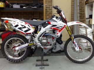

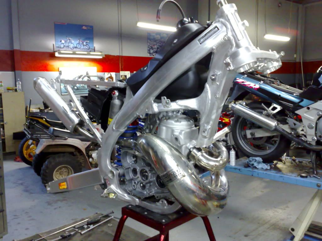

we only have the air box mod and head stay to do
hope fully it should be finished soon so then we can cut this one up for me
its full race trim before it went to finke
Beans 2007 crf450x(now my bike)

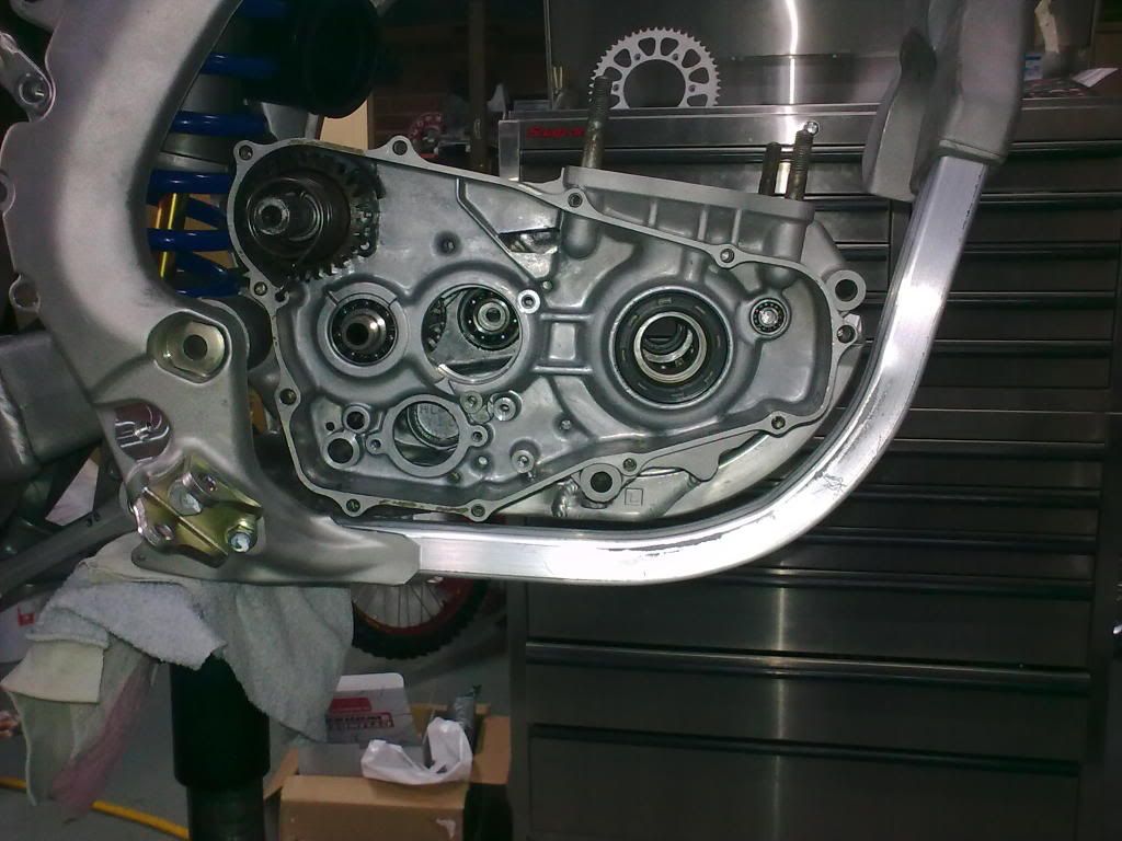

my motor is zero hr bar the barrel
beans motor cases are out of a 98 model everything has been replace including crank and every bearing,seal,bolt and is now running a hinson clutch basket.

Very nice build, I am currently building a 05 450X doing a very similar conversion with full cradle replacement. What radiators are you going to be useing, my stock radiators are hitting the Y. I plan on posting my conversion when complete.

n36 we run modded crf250 radiators
