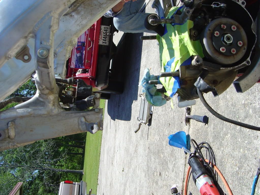

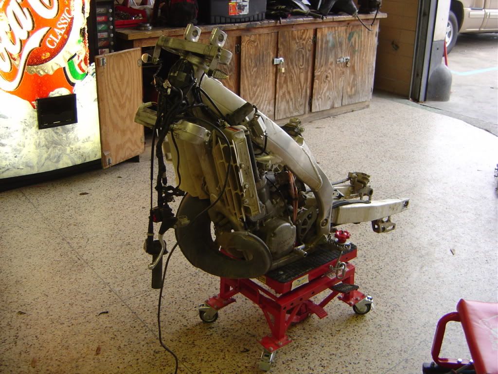

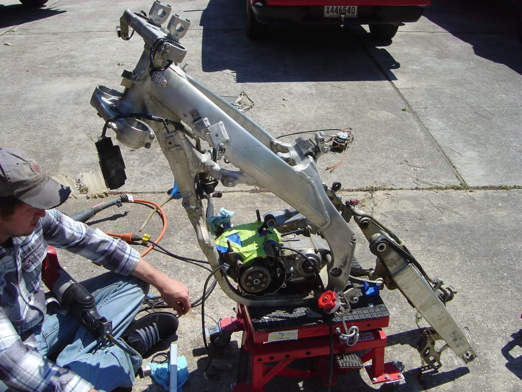

here's the few pictures i've taken so far. i plan to take a lot throughout the build process

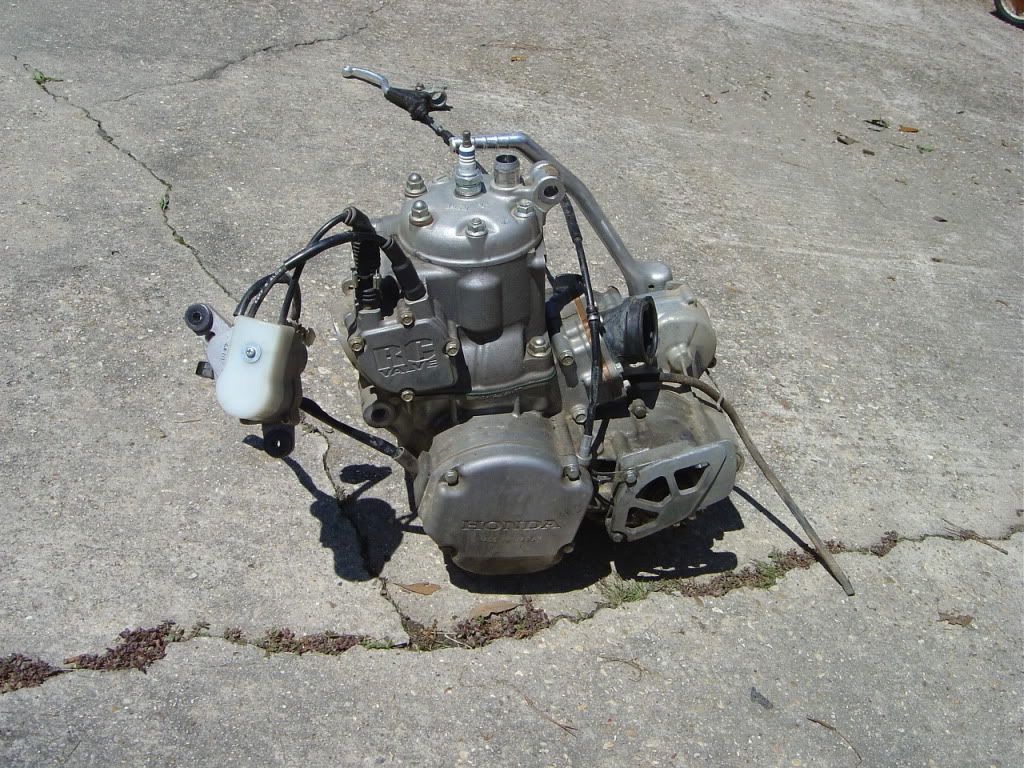

the 94 CR500 i bought for the engine

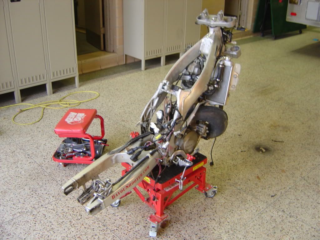

and some disassembly pictures. it's down to bare frame and the motor is out. now everything is in a little pile till i put it on ebay

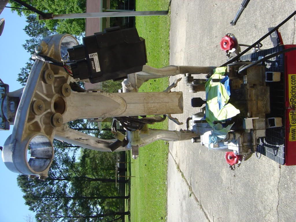

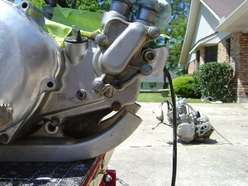

well, it's been a while since any updates. i rode it around as a 250 for a couple weeks, and thursday i brought it to work with me and tore it down. more and more stuff has come in
i still haven't ordered an exhaust or anything to run the lights. those are the only to major things i need to order to get it on the road.
right before teardown
and during...
started cutting
the 250 motor out. goin on ebay tomorrow

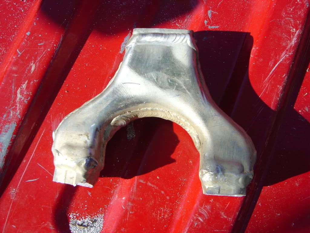

bent some hard to find tubing
yes, it's supposed to have a slightly different bend so it will clear the cases at the water pump, and give enough room for the motor mounts
the jig
the jig welded stationary, lol
after a couple hours of cleaning up the Y, here's the top

all you get is crappy cell phone pictures i just took. low lighting and i didn't feel like adjusting the settings on the phone, lol. i'm too lazy to pull the camera out. it's easier to just email crappy pictures to myself than have to find the USB cable.
there are still a few things left to do, and we haven't even started the wiring at all. i definitely won't be able to do much night riding with the little 40 watt stator. i'll be going to get the radiators done tomorrow morning. hopefully they'll be able to get it done quick enough for me to head to my buddy's dad's metal fab shop to get some headstays cut and bent. he's gonna have to make a bracket for the intake boot i got from frank too. i've still got to change the fork seals and get some tires mounted up too.

IT IS DONE!!!
well, almost 3 months to the day and it is finished. we got it running today and it runs pretty dang strong. i need to get the starting teqnique down, because 10 minutes of kicking when it's cold is just not cool, lol. when it is warm i can get it in a few kicks. the compression release i had roostius maximus install is a freakin lifesaver. it is the only reason i can kick the dang thing, haha. we tried without it and couldn't get it to crank.
pictures to come when i can take some in the daylight. i still need to post some pictures of the frame and the welds. i think it came out really nice, and looks factory (minus the diamond strapping for added support). all of the wiring is heatshrinked and we used either factory connectors or waterproof bullet connectors. everything is soldered. we can't get the MOOSE lighting coil to run the baja design LED tail light or LED blinkers for some reason. i'm going to use a drill batter to run the LED's till we figure that out.
in closing, to be honest, i'm kinda dissapointed. i really don't think it's much faster than my 450X motard. maybe i don't have it tuned right or something? i punched off from first next to my buddy on his XR650R motard with a few mods, and afterwards he asked if i was running 3/4 throttle or something, cause he wasn't far behind at all. i was expecting a little more umph since when it was a 250 2 stroke (with the same gearing i'm running on the 500) it was faster than my 450X.

the compression release is seriously awesome. i've got it down to 10 kicks cold, and 3 at most when warm. this is without putting too much pressure on my left leg when putting effort into it since my left knee is pretty bad off. (needs ACL surgery BAD)
power wise, it wheelies in first and second at the flick of the wrist. third gear it takes a hint of clutch or just keep it a little higher in the RPM range when i want to pull it up. i have a pro circuit exhaust and v-force delta 2 reed cage, stock carb with 178 main and stock pilot and needle position at sea level. i ran my buddy on the XR650R again (T-4 exhaust, edelbrock pumper carb, K&N filter) and i pull a bike length or so till 3rd, then when i shift into 4th, he pulls by me and out pulls me the rest of the way. we're both running 15/40 gearing since we're on the street riding. i know the CR500 will wax the XRR stock for stock. why am i getting my ass handed to me in a drag race? he's 40 lbs lighter than i am, but the XRR is about 90 lbs heavier, and has less power!!! i'm seriously bummed, as i was pretty sure i could wax the new 450's, but i can't even beat a freakin slightly modded XR650R. i can just ride my big red pig motard and run about the same as i am now without the better sounding motor.
