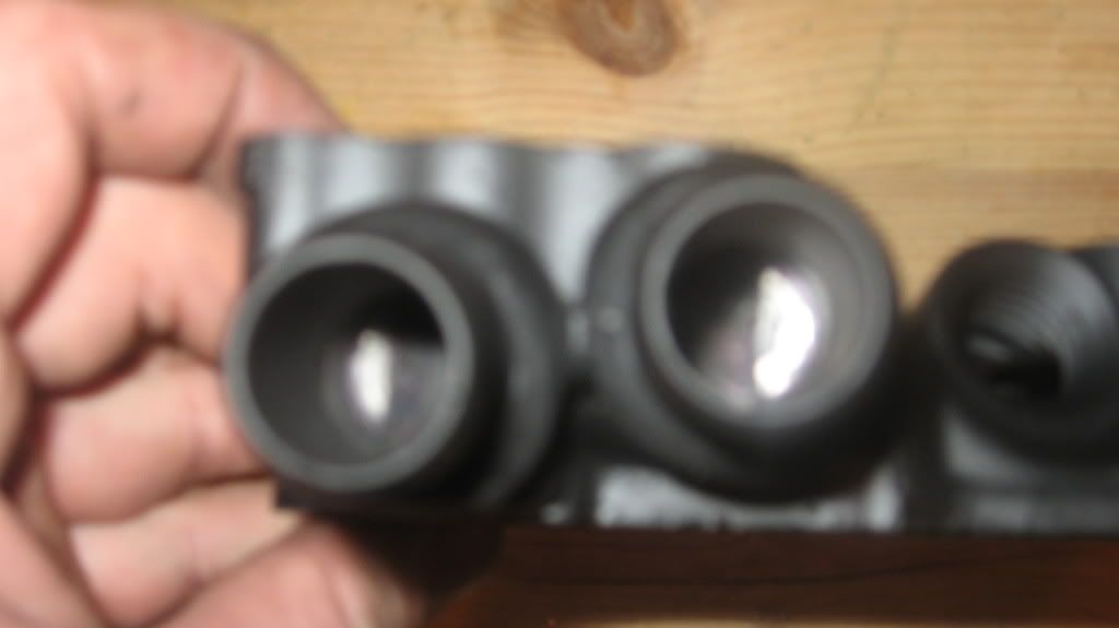

hi guys thought i would share this with you,repaired my badly corroded pipes that come of top of pump today,used a dremel to clean out inside of tubes and slightly enlarge,then used sleeves that you use on plastic 22m hepworth pipe for heating and water(not sure if you get hep over there but any 22mm inserts will do)these have nice knurled end on them .once got good tight fit used chemical metal to bed them in and build up around corroed area sanded of and repeated where necessary. they look allmost perfect and save a fortune,not sure how long they will last but should do the trick.the sleeves are very thin and stainless so dont restrict the flow and will not rust.
Sounds like a good fix, gotta' pic?

few pics
Post by patgas »
Image[img]http://Imagei244.photobucket.com/albums/gg20/patgasmayo/021.jpg[/IMG]
few pics works a treat

Looks damn good to me! :cool:
