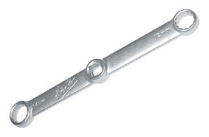

Searched for this and did not find, but I am looking for the specs on the head and cylinder(not that you can get a socket on all of the cylinder nuts).

Cylinder is 29 ft/lb and the head are 20 ft/lb. You might want to buy a Motion-Pro adapter for the base nuts. :cool:
Thanks for the info and tool suggestion.

Remember to factor in the extra leverage from the length of the adaptor and reduce the torque setting to accommodate...
Michael Stiles
2007 Honda CR500R-AF
if you buy the motion pro tool (which i highly recomend you do), all the conversion factors will be included with the tool
100hp honda wrote:if you buy the motion pro tool (which i highly recomend you do), all the conversion factors will be included with the tool
You are correct sir. :cool:
