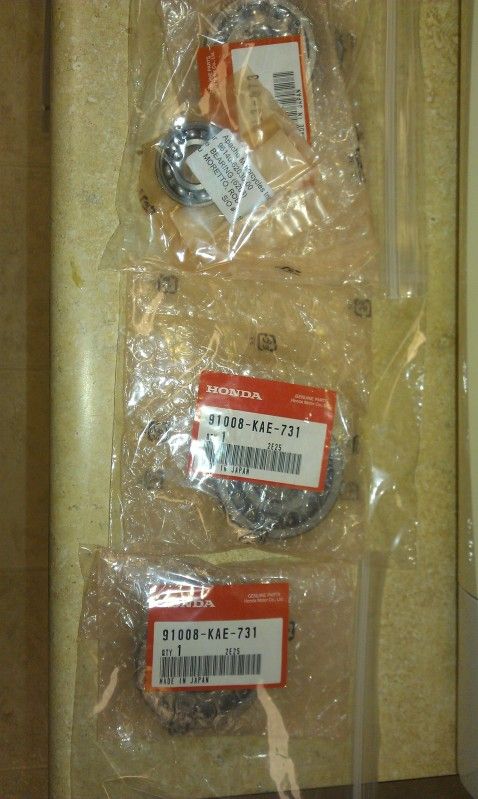

Oh daddy! Got "everything" I need to do the bottom end!

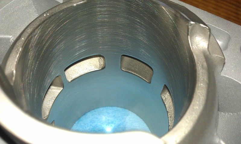

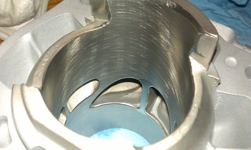

Working top end..... Having Millennium do a replate on the cylinder and set it up with a standard bore Wiseco. I still need some gaskets and such.
I bought everything for the bottom end through these guys. Good prices and friendly service. However, they stock nothing...you'll wait a bit.

The jug was sent off a few days ago to Millennium for a replate and top end. They said they would have it for about a week. I got a warm fuzzy talking with those folks. Got in a tech discussion of what their process is--kinda cool. They're pretty friendly also.
Both Mainshaft bearings are toast. They turn but have that gritty feel. The other bearings feel really good and turn easily and quietly. Most everything looks VERY good. I was surprised. The shift forks looks great, the shift fork shafts have no marring or anything on them.
I'll be placing another order here soon after I am done looking at everything. This will include top end gaskets and such. I ran an "assumed" list of what I would need. Think I am gonna rock with Apache Honda In Phoenix. Their pricing is very competitive for OEM stuff and comparable to Powersportplus.

Got my cylinder back from Millennium and my last OEM parts order....lets proceed shall we?
Installed power valve...moves nice and smooth and with weight of flaps and new head studs. Cylinder is clean and ready for piston.
Lots of OEM parts.....
Bearings for freezer then install.
Lubed everything up with...yep tractor fluid:
I noticed everything "calmed" down and did its job quietly and smoothly...impressive.
I installed the tranny after puttin new crank and tranny bearings in...all pre-lubed with tractor fluid.
