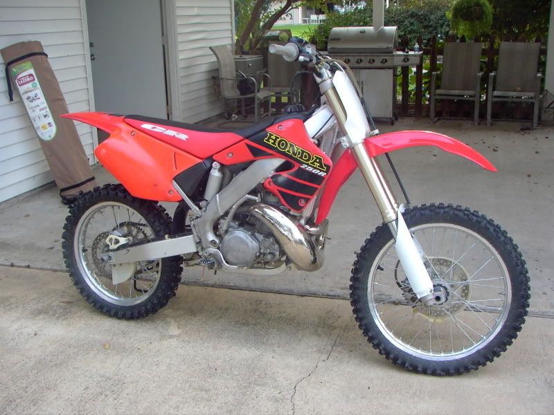

Just out of curiosity how do you rule out the gen 2. What makes them look different than a gen 3. Thank you for the Pics Bob.
2strokeforever
Posts: 1524
Location: Vernon B.C Canada
Post by 2strokeforever »
the gen 1 and 2 have a straight across weld on the frame spars, the frame spars also look like an aluminum 2X4
gen 3 spars are sexy, and the weld has a corner in it
the welds are closer to the footpeg on gen 1,2,3, the gen 4 and 5 the welds are above the airboot
4stroke=dead fish
