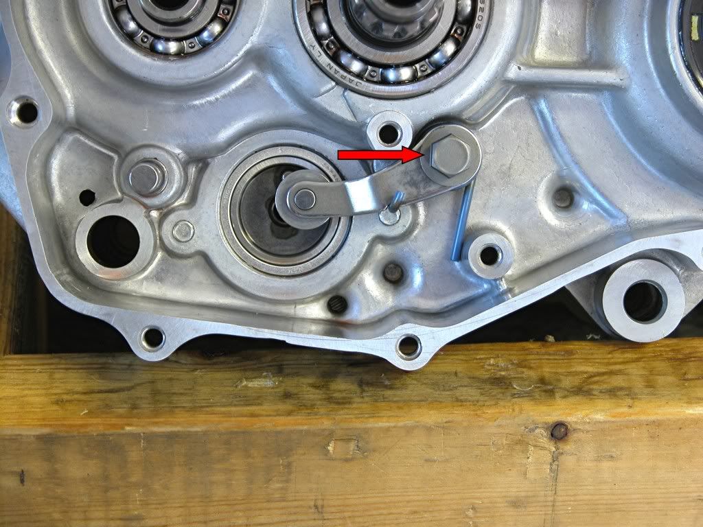

Start with the neutral stopper arm.
Install the lever and a new spring and washer. Torque the bolt (arrow) to 9 lb.ft.

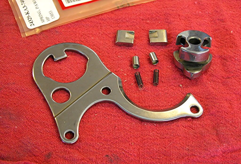

Assemble the drum shifter components into the guide plate. Coat all the
components with clean gear lube. As I stated previously, these are new
pawls, springs and plungers that should be replaced at every rebuild.

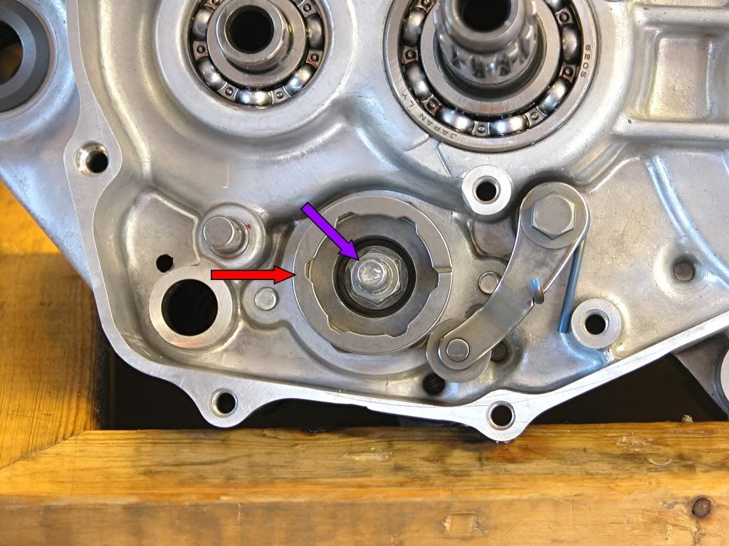

Install guide pin in the shift drum then install the drum center (Red arrow)
while holding the neutral stopper arm back with a screwdriver. Torque the
center pin (purple arrow) to 16 lb.ft.

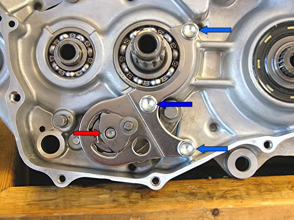

Set the drum center to a position other than neutral and install the
pre-assembled guide plate with the drum shifter over the center pin (Red
arrow), while holding on to the rachet pawls. Torque the three retaining
bolts (Blue arrows) to 10 lb.ft.

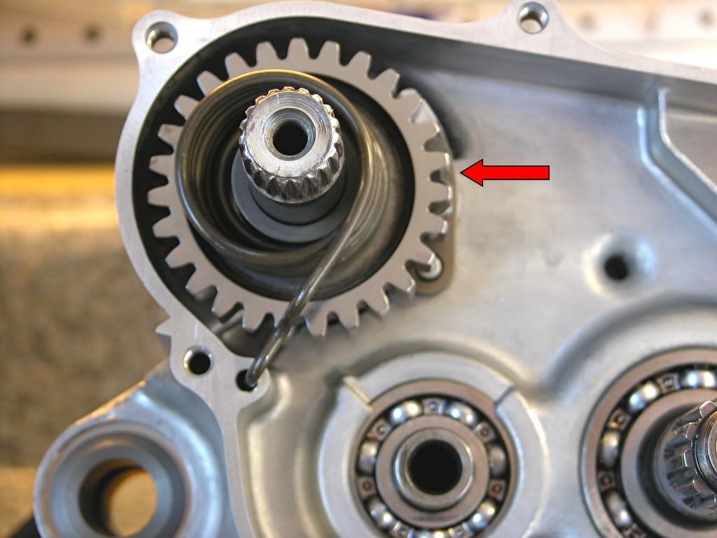

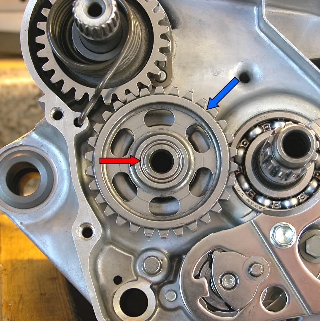

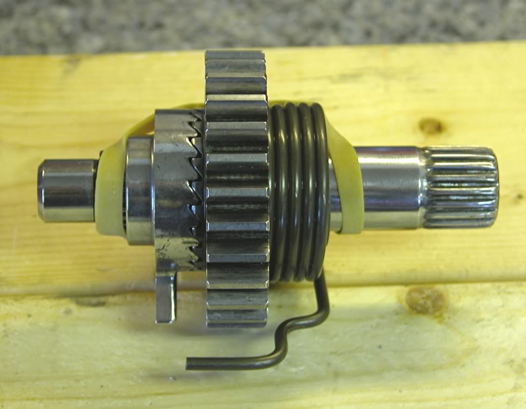

Assemble the kick start assembly as shown.
Place the kick start assembly in the case and wind the new return spring clockwise until the end can be inserted into the case.
Install the idler gear (Blue arrow)and bushing (Red arrow) after coating both with gear oil.

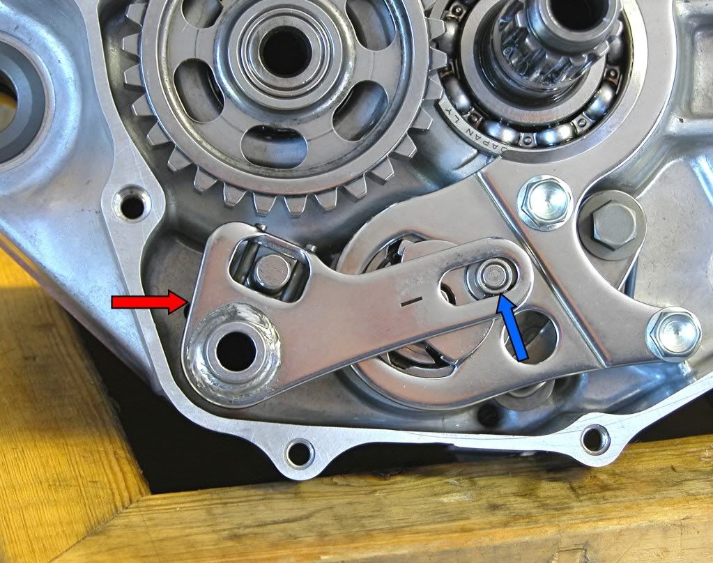

Place the shifter collar on the drum shifter (Blue arrow). Assemble the
gearshift spindle return spring, snap ring and thrust washer and install
straddling the case pin as shown.
