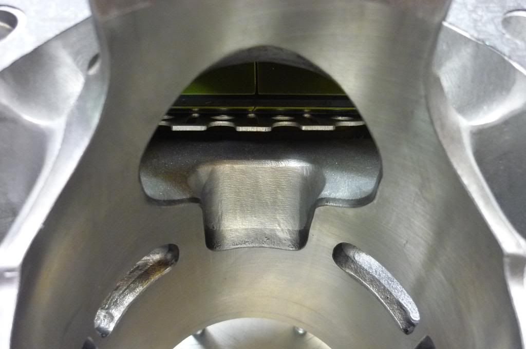

I had 2 engines rebuilt built by him, one for a friends CR500AF I am building, and the other, my own personal engine.
Friends bike is stock rebuild, rebuilt crank, all new bottom end, trans seals bearings and a few gears in the transmission too. TMR reeds, Mild exhaust port work, and mild bump in compression to make the power slightly more linear, and decompressor for the events when easier starting comes in handy, like sidehilling stall in the Rocky Mountains.

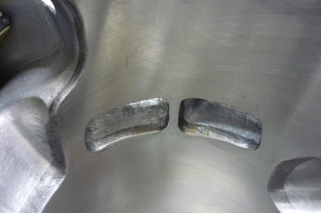

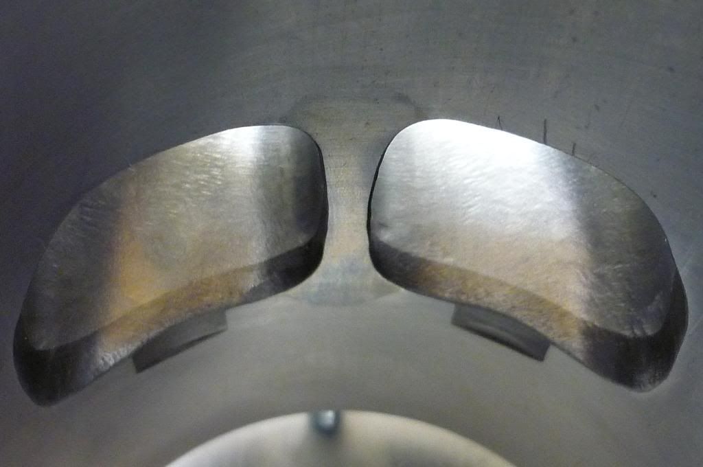

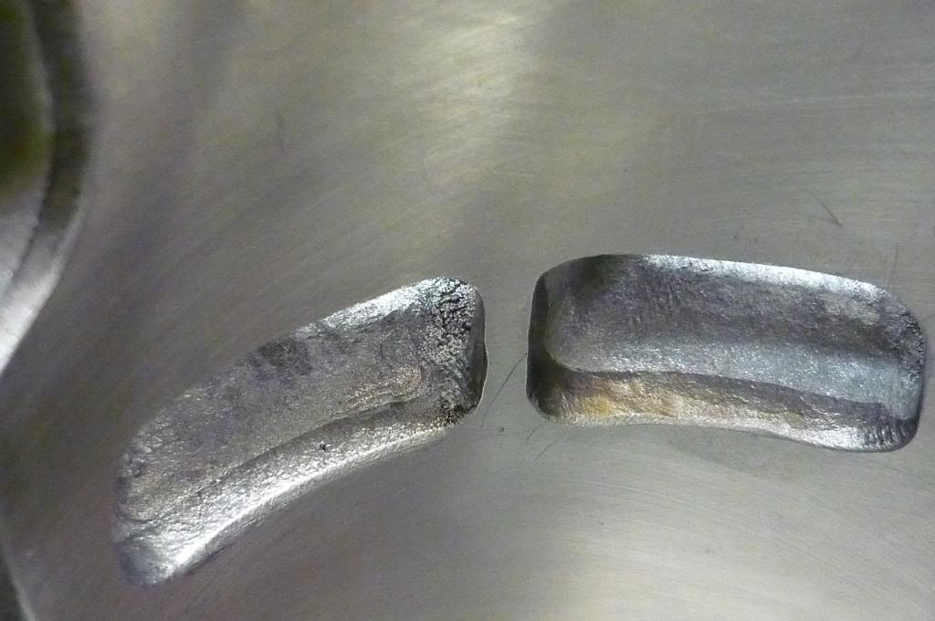

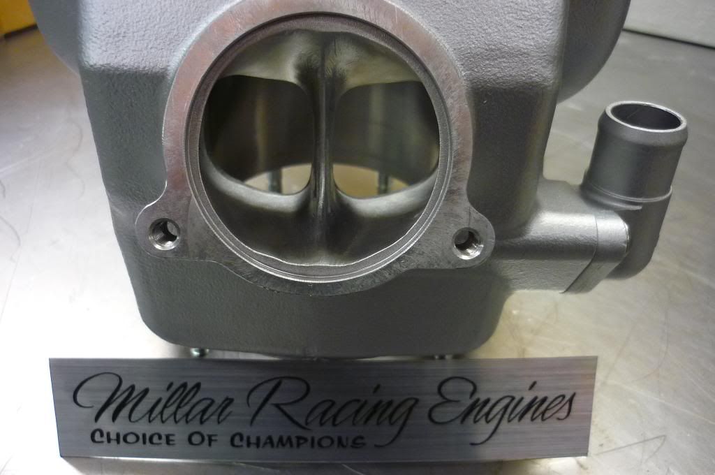

Mine is a full rebuild, TWIRP new crank, new wiseco piston, new cylinder, all new bearings and seals in the trans and crank, bushings, gaskets, kickstarter, studs, nuts and exhaust fastners/ springs I ordered through him.

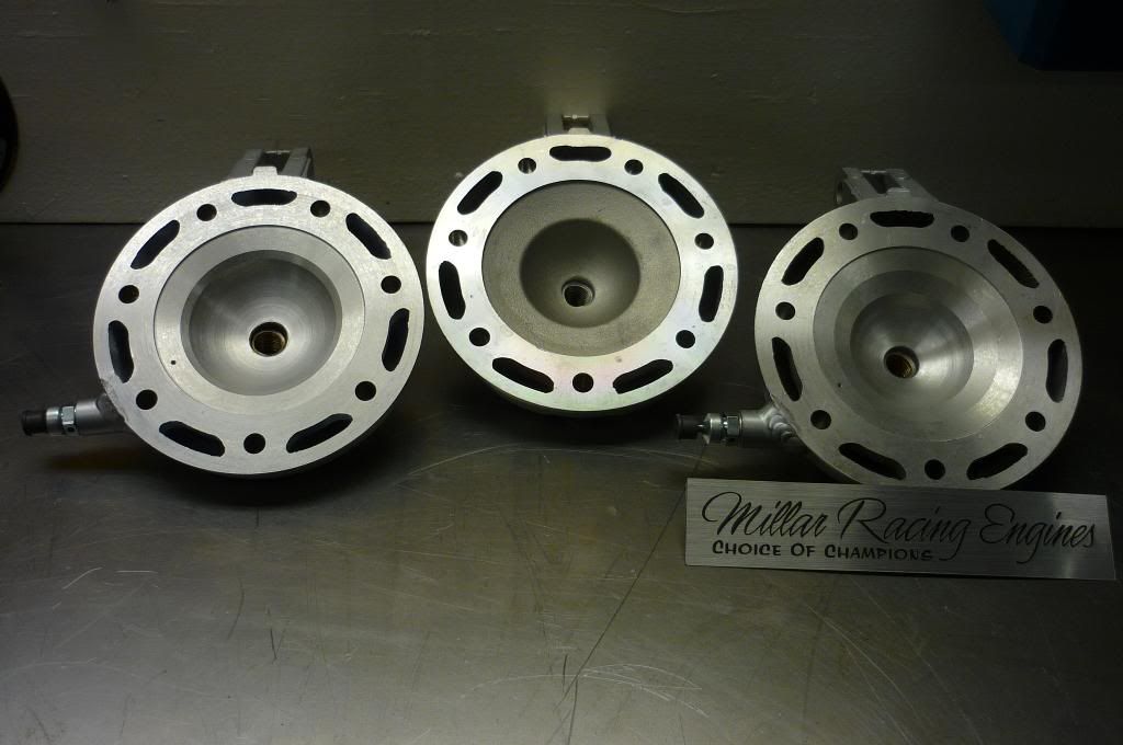

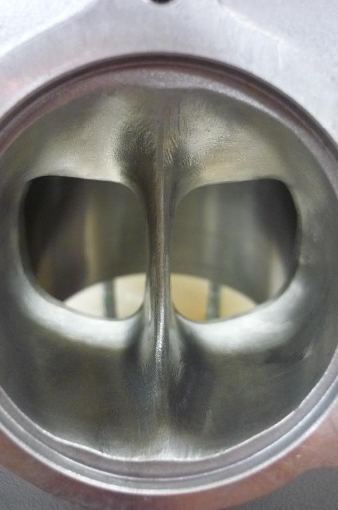

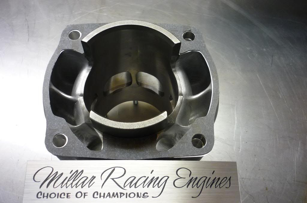

And the best part... TWIRP ported case and cylinder, specially machined HF1 (1986 era heads), rechambered, and with decompressors installed.
One for pump fuel, one for C-12.
The TWIRP porting of the cases, and cylinder I am sworn to secrecy on, so th pics do not divulge the techincal details of that aspect.
Too, bad because TWIRP is the most revolutionary port design and theory I have ever seen for a CR500.

Looks top notch! Things like this you almost feel bad assembling and running, but that's what it's for. I'm sure the real beauty will come out when the slide opens. This stuff has been tested in his stomping grounds by himself and his crew and you all see his homework he's donated all over the forum. More useful info and presented professionally for all of us to use.
I know I have at least one twirp in my future. :evil:

Adam those engines look great. How can I make my 92 cases look like that? Did you paint the cases or blast them?

he hot washes, sand blasts, then paints them! :wink:
I am very happy with the outcome!

It is a shame nobody will see how beautiful the parts making the power really are, thats why I took lots of pics for the hoons, any true hoon would appreciate the beauty of it.
I blast them with glass, then paint them with VHT brake caliper paint. If the carb bowl is off and fuel gets slobbered on the engine the paint stays :wink:
