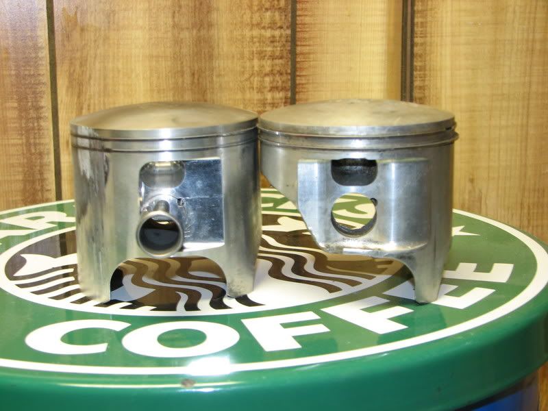

The one on the right is 85-89 left one is 90+

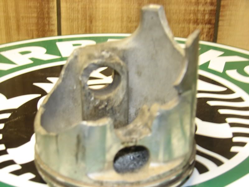

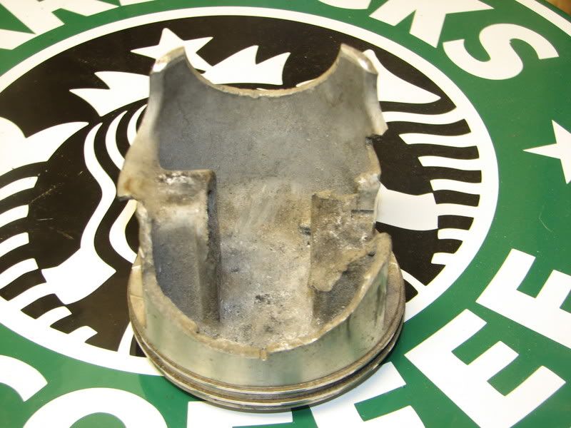

The rist pin caught a port and whala....
Its an ashtray now!!!!!britincali wrote:DUDE that piston is a trip man! Who chopped it up like that?
- iggys-amsoil
- Posts: 3604
iggys-amsoil wrote:I bet if the holes for the exhaust bridge were not drill it wouldn't of broke.
OKaaaaaa..
