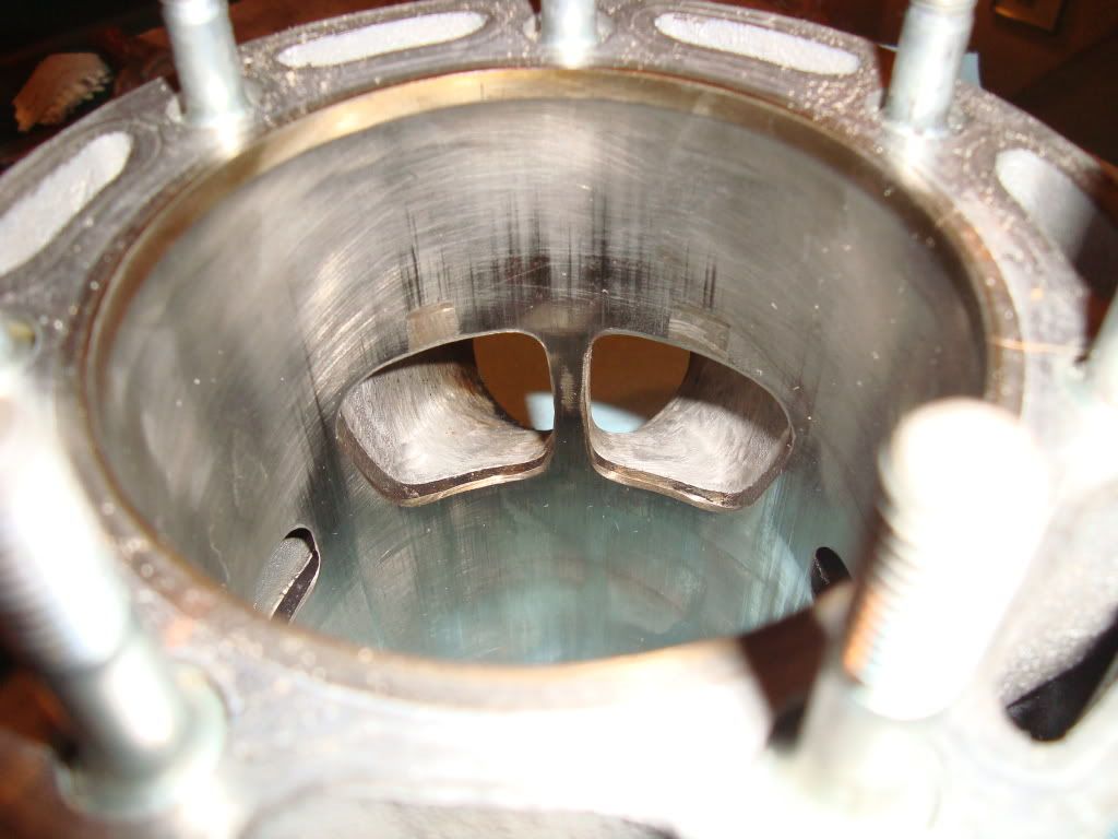

Heres some better photos of my teardown.....
Intake side of cylinder looks near new......

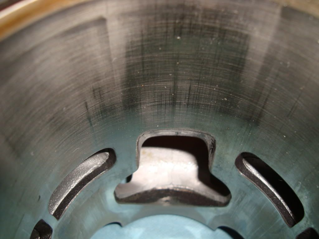

Exhaust shows some wear, digital camera is adding to the effect

These are some telling photos..... now remember this piston is 4+years old and shows almost zero wear. The only wear visable is from where hot combustion gas has come down through the ring end gaps and blown the 927' off the cylinder wall. The top ring gap shows the most wear, the second ring slightly less....No blow by, no varnish, ring lands absoultly spotless, no scoring of other Wiesco type shit.
None of these parts were washed or cleaned in any way... its exactly how they came out. Vertex = Good.
