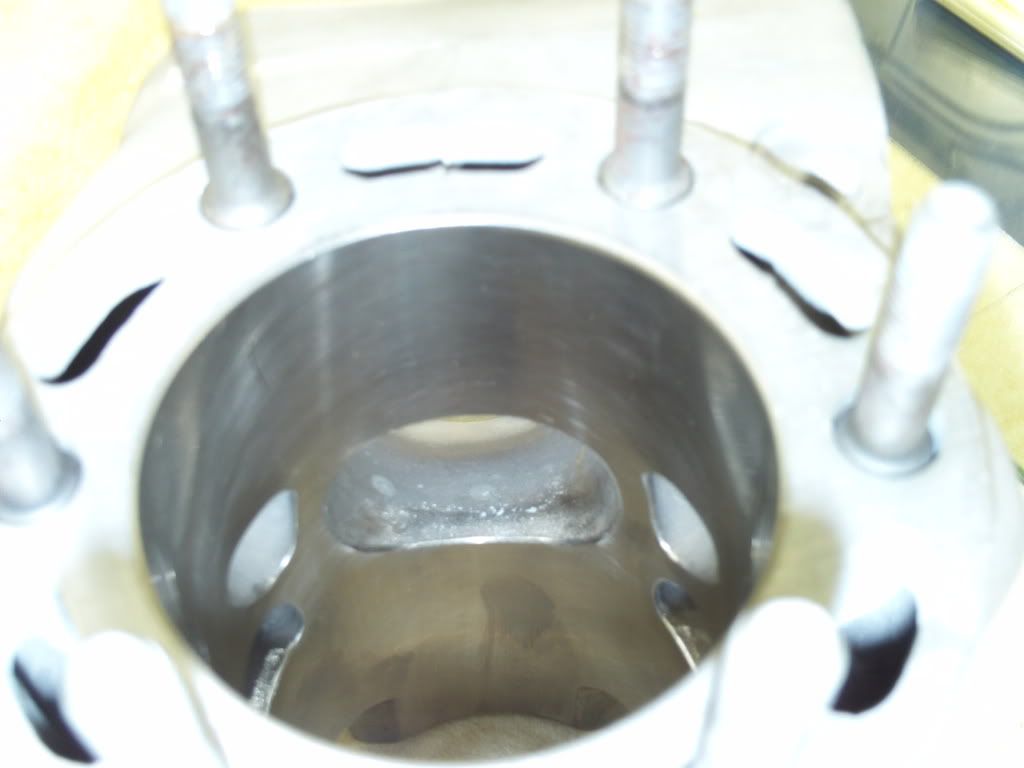

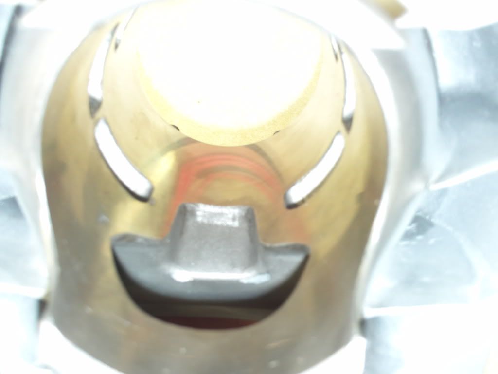

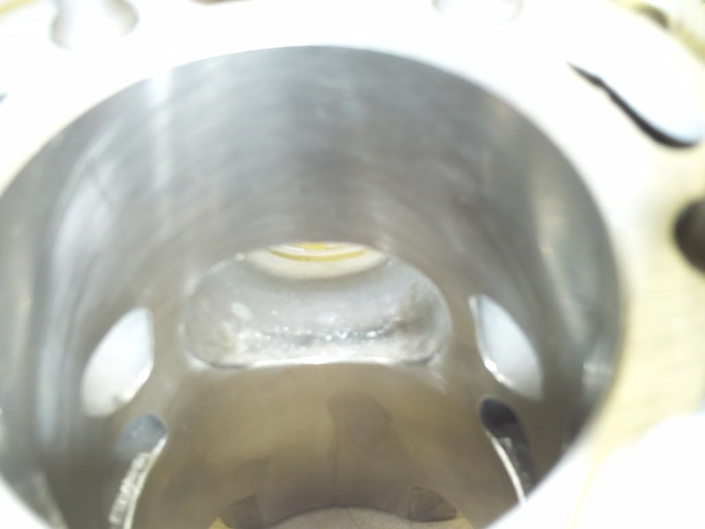

Well I'm bringing this back to the top I had my 250 cylinder re-plated at US chrome. I'm very happy with the results they did an excellent job and looks like they took plenty of time to chamfer all the ports edges. Also cleaned all parts of the cylinder. Looks like it should run like a top I give some long term results too if any one is interested. As soon as I get the funds I'll be sending my cylinder with the Eric gorr job on it off to get plated too. I plan on putting on quite a few hours this summer. They claim a longer life and higher quality finish than the nikasil that comes in the factory. If that the case I should be good to go for a long long time as the factory coating lasted about 8 years.
And yeah its too shiny to get much of a photo
