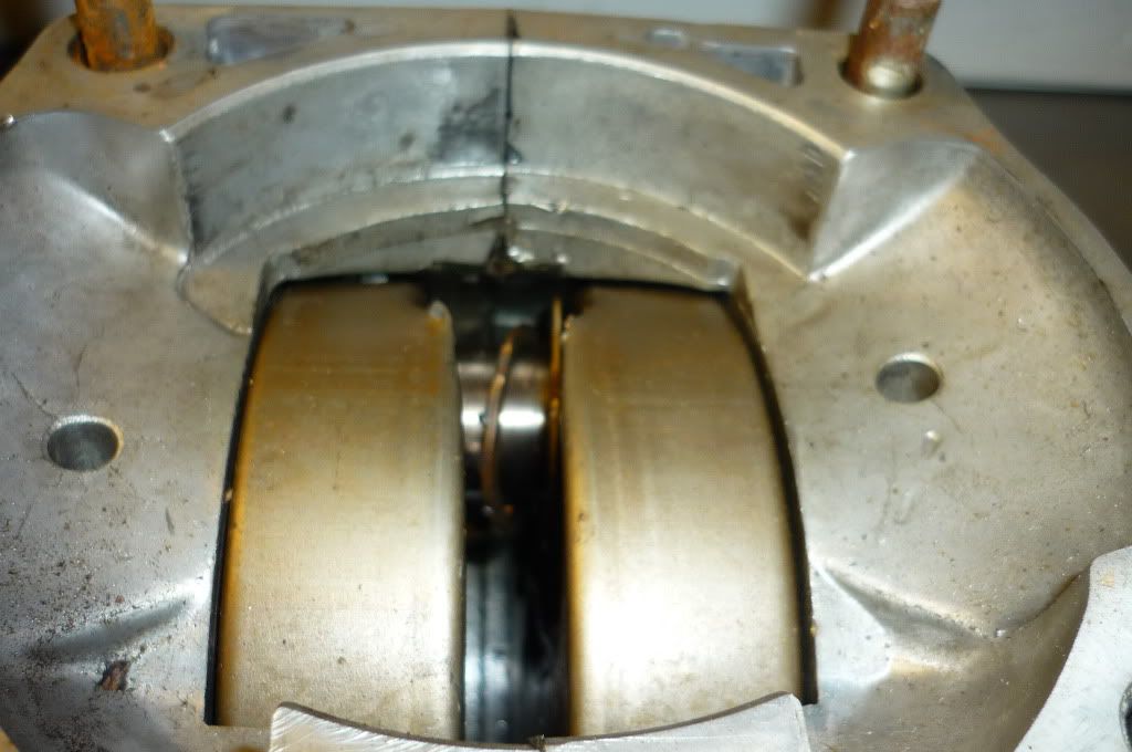

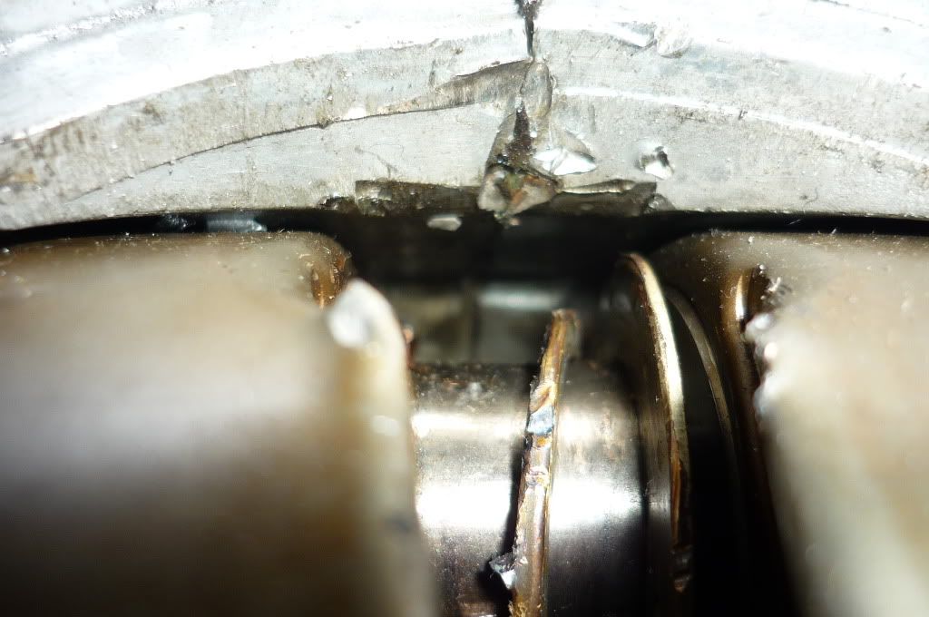

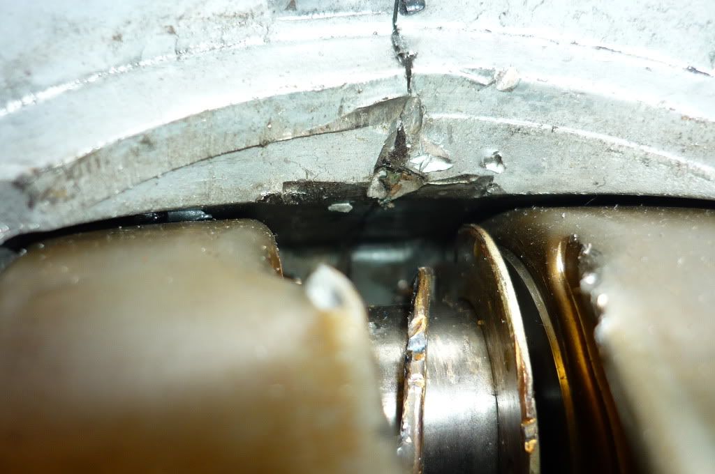

one broke rod means nothing. 1000 broke rods shows a pattern of trouble. like the wiseco/cast debate. impossible to count how many broke cast slugs are now beer cans, number of broke wisecos could be counted on 1 hand. any part can break at any time for a number of reasons. probly rode the bike for 6 months with bearings wobbling for all we know. could of been a shit rod from the factory. what does aftermarket have to do with anything in this situation ? heard hotrods had bad holes and broke...... never seen a pic of one yet
. granted there aint 500 members here running hotrods but still i dont buy into the bad hole bullshit. heard wiseco was all over the board with sizes. funny i measured 2 wisecos and both were near identical size on all areas measured. go figure
here are some pics of a big end rod failure.
I bought this bottom end like this.
I had never seen one like it before, I would imagine the rod brg was so worn out the rod journal ovaled and broke?
or else it sucked in water and hydrolocked, cracking the rod, and it came apart the next time it saw revs....
all speculation ....
It did not crack the cases.
I was told the cylinder skirt / sleeve broke off from the rod impact.
