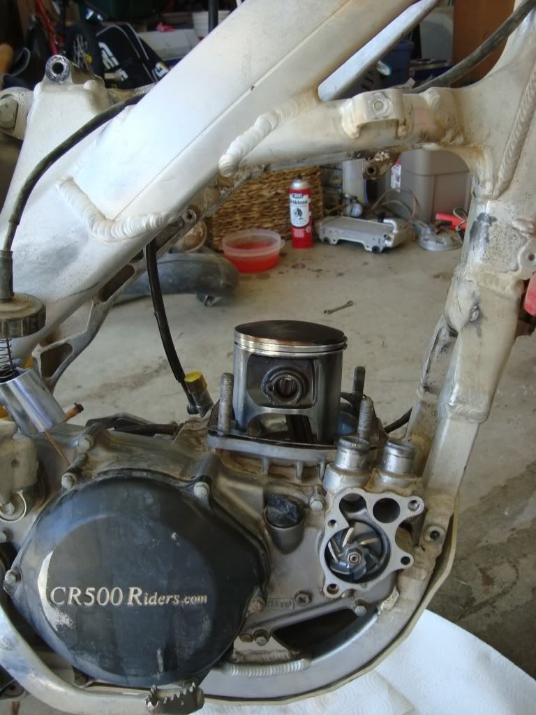

Checking rod side clearence. 5 years ago is was 0.024". Now its 0.027". Thanks '927'!!
Detailing the piston. Everywhere the piston touches the bore, I hand sand a nice little radius into to piston. I think it helps... WTF knows...
One day, a thousand years ago, I couldnt find any WD-40 to rinse out a bore, but I had to PAM sitting around, been using it ever since. This jug was washed out with solvent by Roosty, and with brake cleaner by me.... look what the PAM still pulled out of the bores pores. Squirt this shit all over, wait for it to foam up, wipe and repaeat until the papertowel is clean. OK, you can stop laughing now....... but it works .

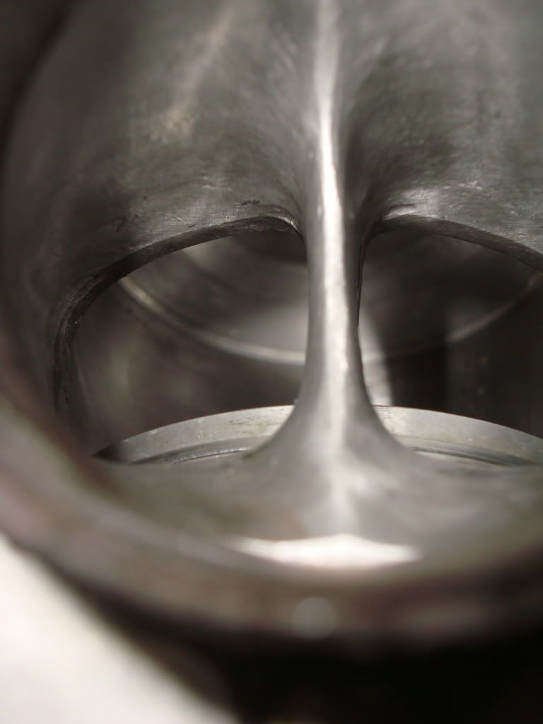

Heres the proof, bore looks like chrome.... soft as a babies ass.....
nice, i'd throw some gloves on tho, that pam goes strait to your blood :lol:

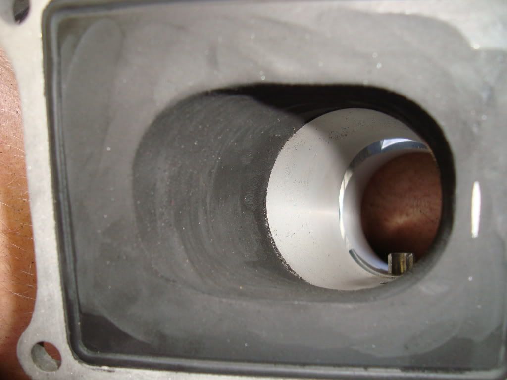

Heres the Carb boot Roosty supplied me with. Its matches the 41mm PWK perfectly.Why bore the carb out, only to have a big step in the intake tract directly downstream from the carb. Adam corrects this issue.
