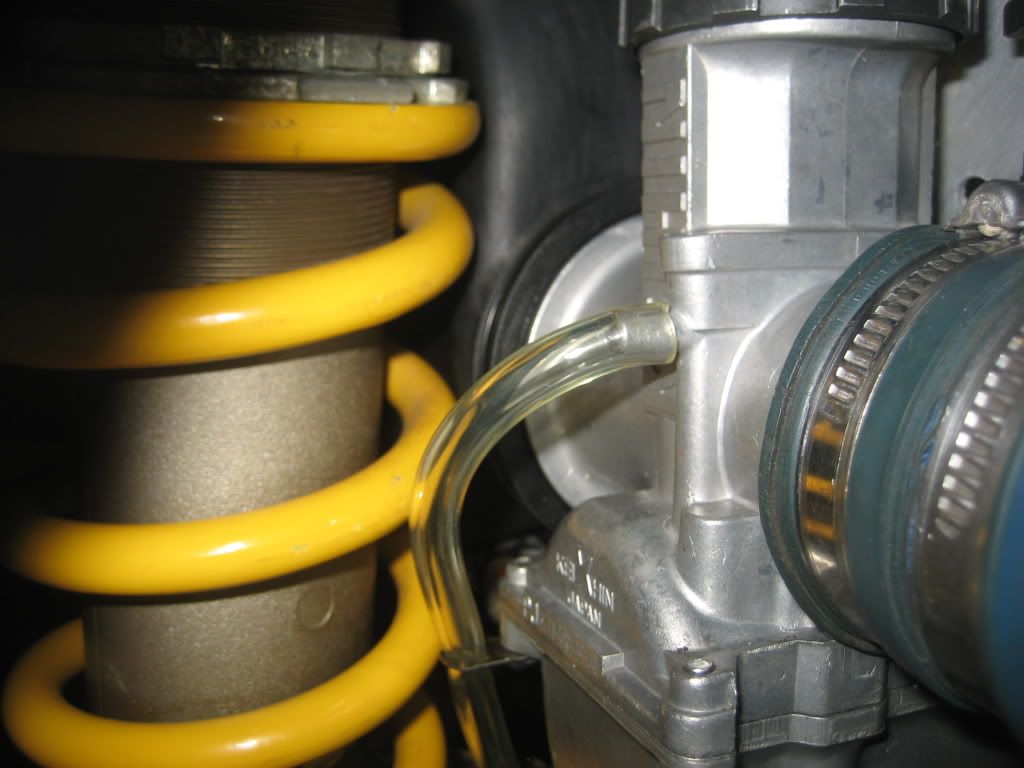

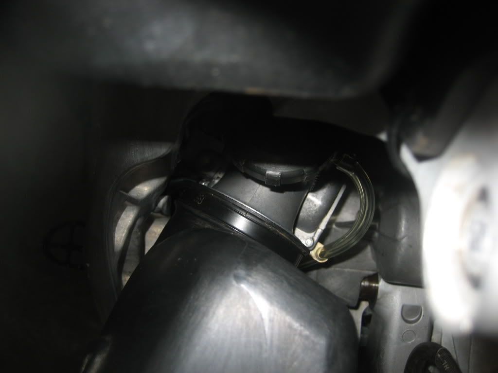

Post by yota »

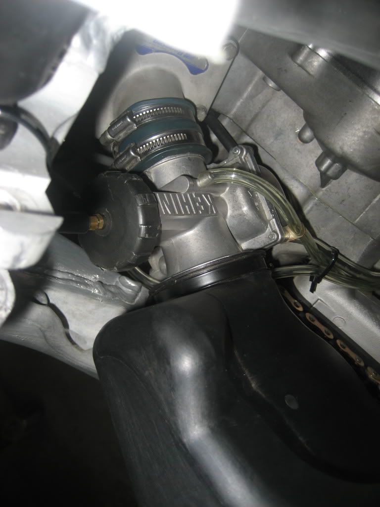

airbox install was ok. had to take off the shock to get it on. aligns pretty good but theres a little pressure on the starboard side of the boot once the subrame bolts on straight. if you loosen the clamp the boot wants to pull off the carb bell.

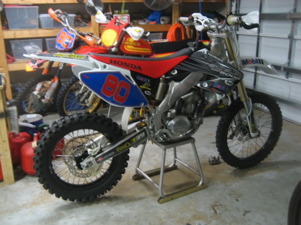

Posts: 430
Post by yota »
red seat ): blurry pic.

Post by honda02 »
You can take the airboot back off use a heat gun get nice and hot press the boot in were it hits let it cool it should hold it new shape I had to do this.
But after I installed the Rad Vavle it clocked my carb away from the shock and gave me more room between the shock and the boot.
Don't you love it but after you get all the bugs worked out it worth it.
Good Luck.
yota wrote:airbox install was ok. had to take off the shock to get it on. aligns pretty good but theres a little pressure on the starboard side of the boot once the subrame bolts on straight. if you loosen the clamp the boot wants to pull off the carb bell.

Post by yota »
I think I would have been ok with the narrower kayaba shock. I may try your heat gun trick... thanks

Dang man, that is looking sweet. Gotta' say I agree with the black seat cover idea. That would look awesome. :cool:
Posts: 3604
Take the air box loose from the subframe, get boot on, tighten clamp, the rest is cake.

Post by yota »
iggys-amsoil wrote:Take the air box loose from the subframe, get boot on, tighten clamp, the rest is cake.
thats what I did.

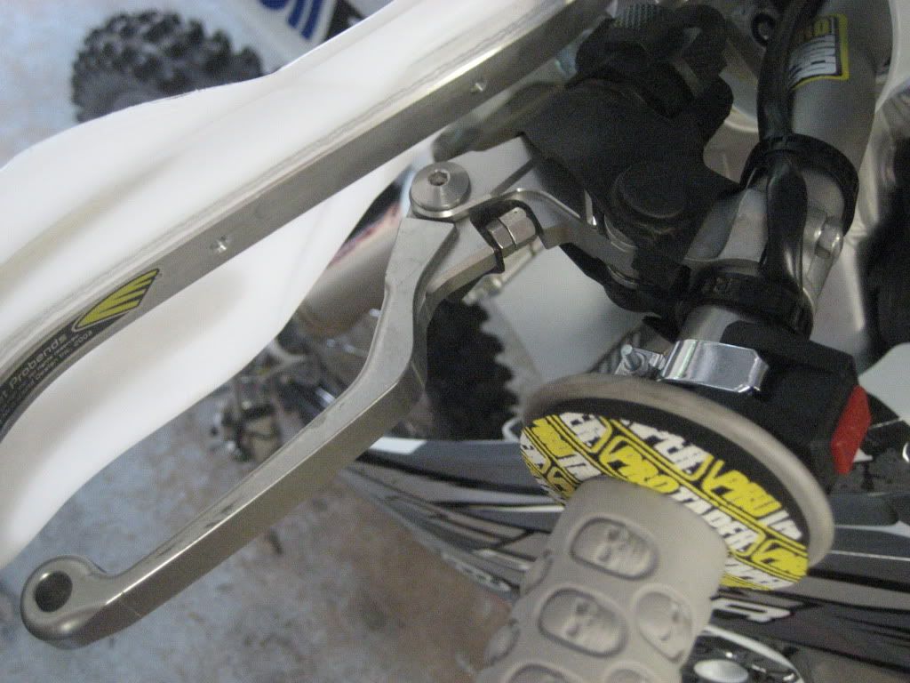

yota
Posts: 430
Post by yota »

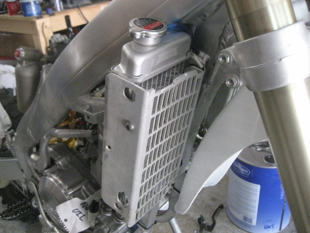

retrofit of Flatland Racing guards off my old YZ 250

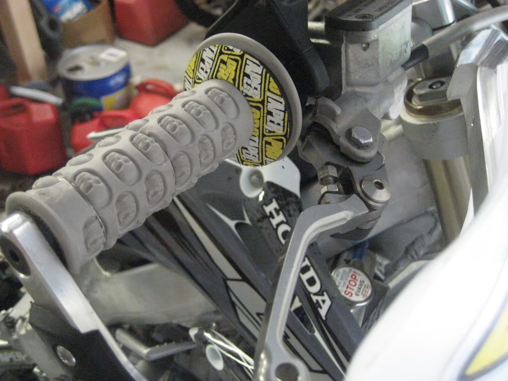

yota
Posts: 430
Post by yota »
retrofit of the perch and levers off my old YZ250f

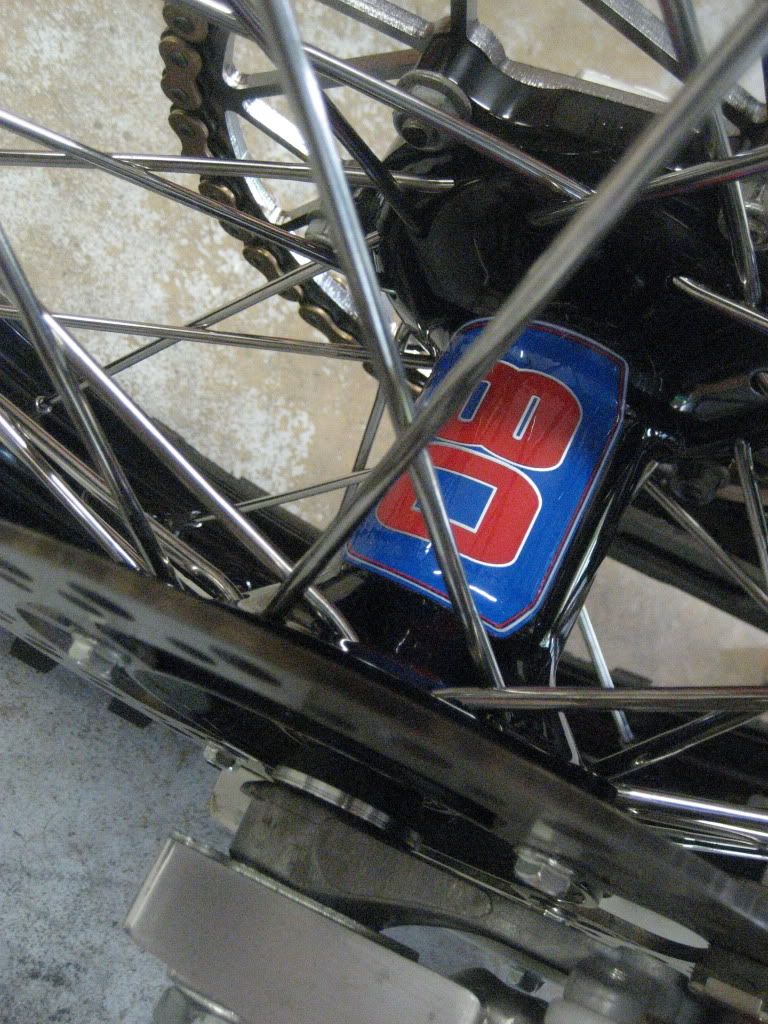

You say your rear wheel has 32 spokes, but the picture on page 2 has 36 so that picture can't be your rear wheel.
