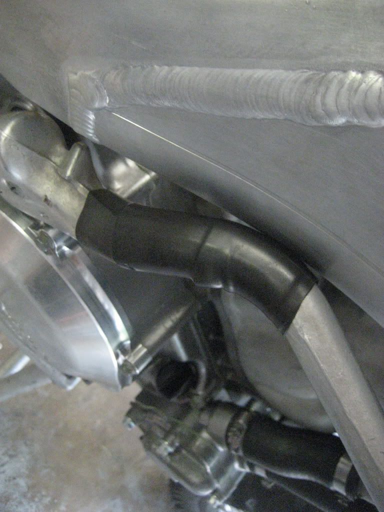

Wheelie-Gene wrote: As for the kicker, you'll probably have to reposition the shaft on the internal gear.
Yea.... re-index the shaft, or go Ghetto, and put some shrink wrap where it hits....
decided to go ghetto until the next time I pull the engine out. 3 layer of shrink wrap.

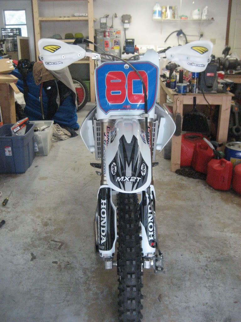

yota wrote:Image
does anyone think this ignition mounting location is a problem with heat? I am hesitant to splice the ignition wires to move the ignition up on the steering head.

Thanks yota that is exactly what I wanted to see. :wink:
Now that is 02/03 shape front mud guard is it not.
Then in 04 they went with a different shape to 07, correct. :?:
If not can someone steer me in the right direction.
BTW the bike is looking great, won't be long and you will be riding it.
yota
Posts: 430
Post by yota »
yes that is an 03 replacement. don't know if they changed for 04, not up on honda stuff yet.
Bike looks great.
No need to pull the engine to index. Drain fluids, remove brake lever, remove right side cover for access.
Mad Dog meant to say
Bike looks great.
No need to pull the engine to index. Drain coolant, lay the bike on a mat clutch case up, remove brake lever, remove right side cover for access
Yota, love those graphics. Sweet build. The steelie had the cdi box mounted right above the exhaust port and between/behind the radiators. I can't imagine your location being much hotter than that. I don't see a problem with it.
cool. its been so long since I took the steelie apart I can't even remember where the ignition was mounted (:
