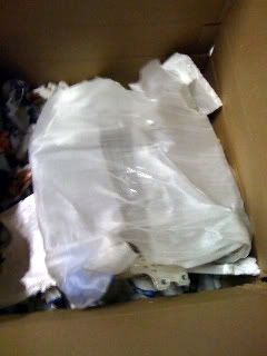

Rue
Posts: 300
Location: Albuquerque
Post by Rue »
When I got off today I had received this via UPS today. Eric a.k.a. SolidBro your the MAN!!!! The Quality and Craftsmanship is top notch!! :cool: :cool: :cool:
SolidBro Replaced the upper and lower sigots(notice the diamiter of the lower spigot is the same diamiter as the Factory CR500 Rad) Attention to detail VERY :cool: , and added the upper right spigot.
Looks better then factory and that's how I wanted it!!! CHECK OUT THEM WELDS!!!
I was so excited to put it on and....
I come to find out that I can't get the Rad on!!! Due to me not researching and doing my homework!! :oops: SolidBro even asked me before he welded the Right Spigot "do you want the spigot straight up and down or angled to the Right". Me not knowing I said go ahead and weld it straight up and down. Bad Fucking idea on my part!!! :evil: :evil: I should have asked someone, but most of the Gen. 1 builds that I've seen use a slitter of some sort.
The spigot hits the f'n frame rail...
:cry: :cry: :cry: :cry: :cry:
I was thinking of heating the elbow and bending it 45° or so to the right??? :? Would I F' it up and Restrict the flow?
Any Ideas Guys, please let me know..
AFC Build link
"SOLID Bro!!"
Post by "SOLID Bro!!" »
Send it back and I will make it right. ?

Post by Rue »
[quote=""SOLID Bro!!""]Send it back and I will make it right. ?[/quote]
Thanks Eric!!! I really appreciate it. :cool: :cool: :cool: I was just going to try to heat it & bend it, I didn't want to bother you. It was my dumb ass mistake. :oops: I will get it out to you on Monday. PM sent :wink:
