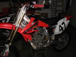

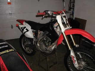

what do you think of this color combo? never mind the cheesy plate #, its there for mock up :lol:

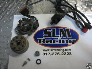

today is another good day, i scored a complete 2000 cr250 ignition system from ebay, it will be here friday guarunteed
now i can clean up that mess on the side of my frame.
Anyone want to by a cr 250 1997-98 complete working ignition system for $150 ?

Any thoughts on color?

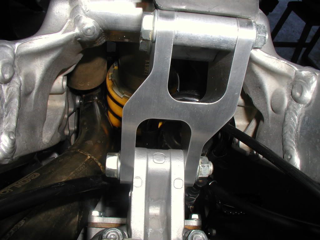

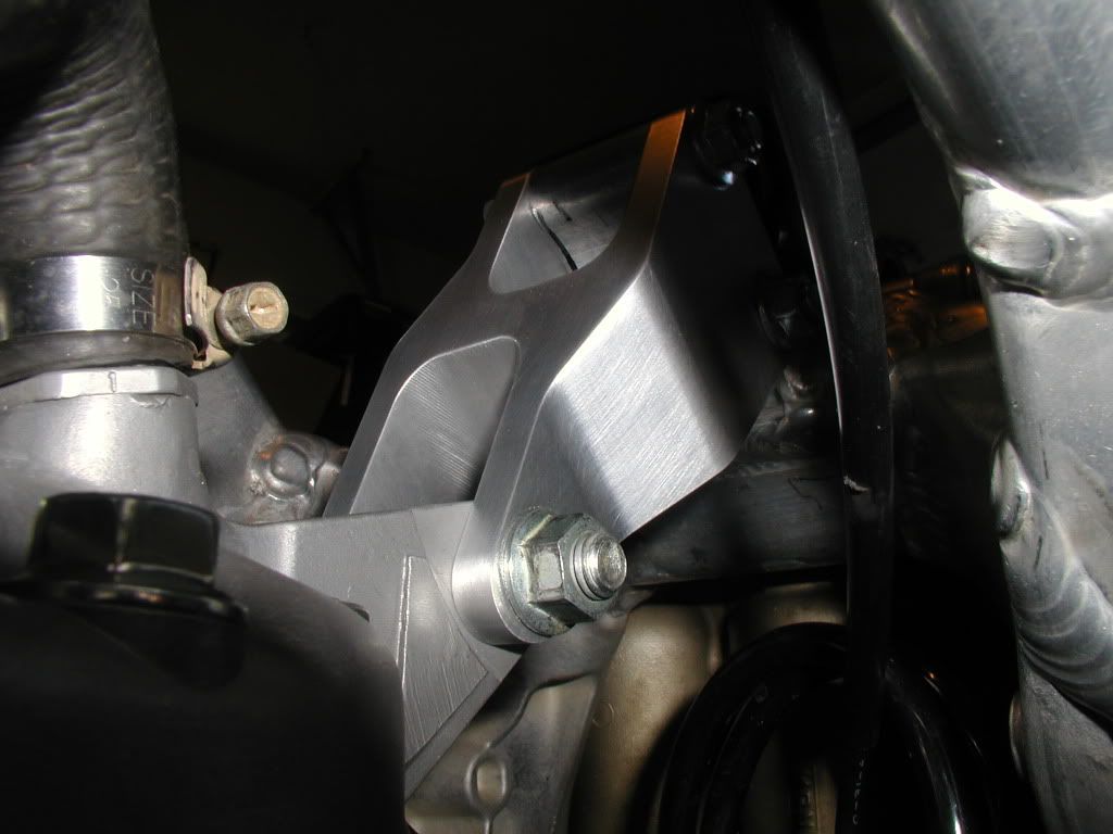

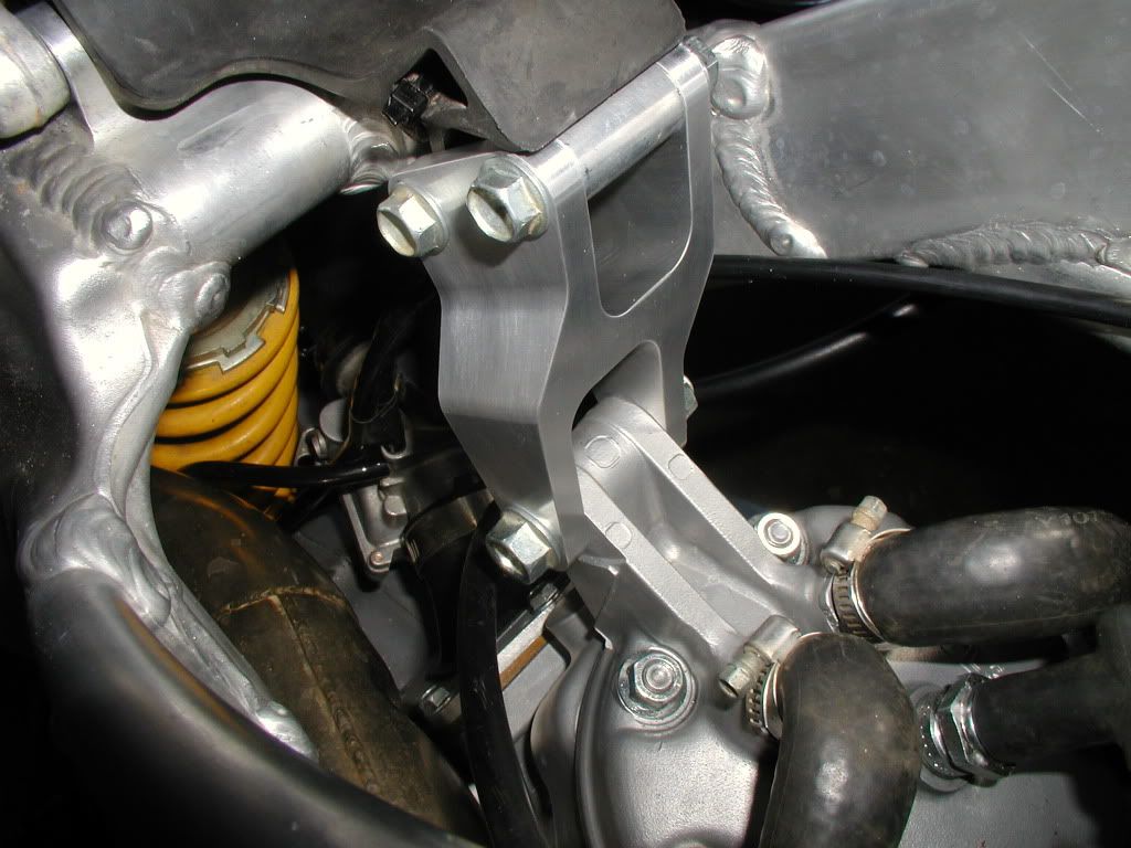

Here's some pics of the headstay im using, idea was found on this site but the print is all mine :lol:

That headstay is F-in SWEET!!
SWEET! well done on stealing the idea from here. :lol:

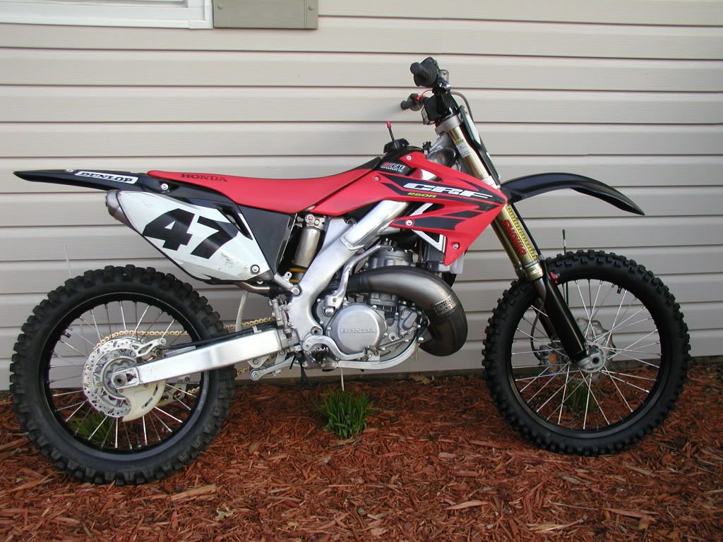

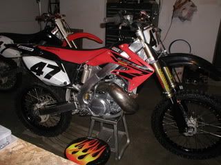

here's some updated pics of my build with PC works pipe, Twinring rear sprocket, ultralite front, 2000 cr250 ignition installed and the color combo im going to go with.
Future updates will include new plastics and my own custom design graphics by De Cal works.
I like it.....

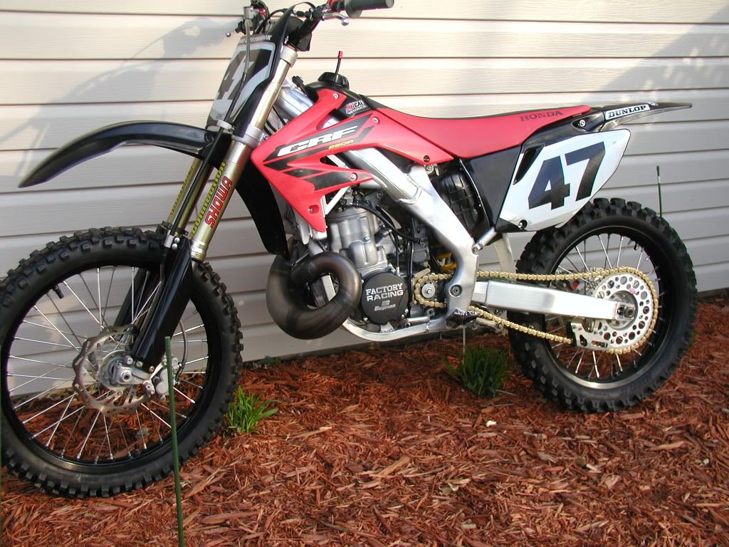

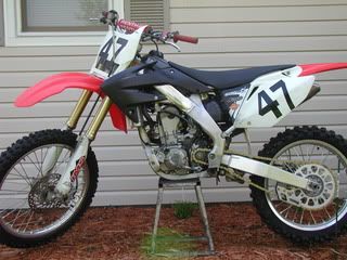

A description of a 'Black & Red' AF would have not done much for me, but, a picture is worth a thousand words, And that really looks good.
I think the clincher is the black rims and the subtlety of the red Showa decals. Just a little more black along the forward / lower edge of the rad shrouds would perfect it, plus perhaps a red worded decal on the swing arm.

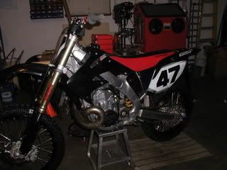

bearorso thanks, i was thinking the same thing about needing more black in the graphics. will try to achive that when i have the graphics made, i have a pic of my other bike with the colors opposite of this one since i swapped the colors between the two.
it looks good also, decisions,decisions :cool:
Hoons don't cut me up for a pic of a 4t, its for color only :roll:
Looks pretty good man! So how does she ride?!!
And why'd you swap the FMF Fatty for the PC? Still have the fatty?
