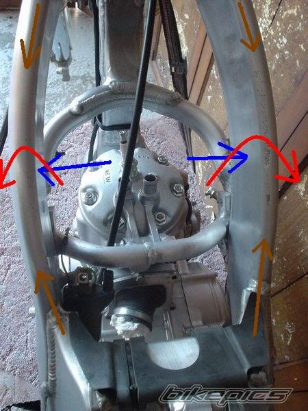

Here's my take on the cracks on pstoffers frame -dannygraves ones being a big part as well ( I assume the "being made to fit "refers to SH's work as I understand this is a SH from pstoffers previous posts ) - especially the one about the hammering that HC bikes take.
I did my Dip.Mec.Eng over 25 years ago & couldn't resolve a force vector equation on paper to save myself nowadays, everything left in my head is experience / practical, so this isn't too cerebral.
The two cast swingarm pivot to shock tower plates, with the shock tower welded in and the cases/swingarm attached is an immensely strong & Rigid structure . It isn't going anywhere fast. The top spars, as strong as they are, with the bend in them (when looking from above) are quite flexible in terms of spreading/bowing out - the curved tube going from the spars to the down tubes as well. Those tubes also attach only slightly forward of the plate/spar junction - that area is a big point of force convergence. So you get an essentially solid structure attached to a flexible ( predominately in one plane, re the bowing ) one. Under harsh bottoming , which would be generating massive forces with a std swingarm, let alone extended ones ( I've not seen this sort of cracking with std swingarms, but still could happen ) but also that of the front end, forces are going into that area of the spars where the round tube is attached & the cast side plates. It would be interesting to see if it required welding on the inside - it would seem probable. The top of the spars has a tighter radius than the bottom , plus ( I think ) the internal bracing is aligned with the line you see on the spars, so the lower section is stronger/more rigid so the crack will spread/develop @ that weaker point. The top of the spar would have a tendency to twist outwards when it bowed = frame cracking in that area, the top & outside as its surface is put in tension. The jacking out of frames that some people do delivers big forces to this area as well - Aluminium isn't a good material to take beyond its yield point - that perhaps may be what dannygraves was referring to.
I've repaired many linkage bike swingarms over the years - people are puzzled that the cracks are inevitably on the Top of the swingarm - thinking that it should crack on the lower side from bottoming. But what is happening is the linkage is redirecting what you'd think are compressive forces into tensile forces, so tearing apart the arm in a way that seems impossible at first glance.
Sorry if this doesn't read well, please give me some lee-way, I took a low hanging branch to my head on Sunday so I'm thicker than usual.

if i understand what you say correctly (and to decode it a bit)
it is not because we have vertical forces on the top (or bottom) of the beam
but because we have forces from the inside towards the outside of the beam.
(in other words the oval shape of the frame (from above) tries to became more round)
in more simple language when huge forces reach the upper frame that part tends to push the beams outwards, but because they are "solidly" connected to the rest of the frame torque is generated and then wrapping of the frame at that point which finally leads to tares on the beam.
it is like twisting (holding bottom with one hand and top with the other) a soda can to the point it splits open...
did i get it right? :o
sonic22
Posts: 22
Joined: June 4th, 2009, 5:13 am
Location: Greece
Post by sonic22 »
i even made a sketch about it! :D
brown are the forces coming from the front or the back
blue are the reaction of the frame to the brown forces (oups...)
red are the twisting forces that are generated because the frame has strong front and rear mounts and there is less give in those arias.
i believe the frame finally gives near the rear mount not because that is where the maximum torque is generated (that is in the middle of the beam), but because there we have the upper part of the beam twisting while the lower part stays still and that create stress to the metal.
And alu does not like to be stressed.
hope all this is in the right direction.

Got it in one, Sonic!
You've arrowed the forces well - as you can see, the cast uprights/shock tower sure as hell isn't going anywhere, so to speak, so the bowing & the twist you've indicated is spot on & it concentrates right at the spar//tower interface. The "twist" is why it cracks on top & sides. We don't have HC here in OZ like you guys - I'd be interested to hear if this happens to HC AFs often - I've only encountered this on one bike, used by a FMX lunatic, never on a std CR/CRF/CRFX or AF.
