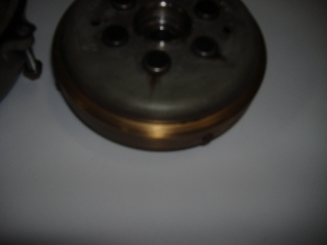

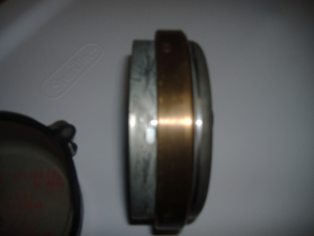

While I'm thinking about FWWs. I'd also like to mention how I think they're made like garbage. Somebody (insert name here) made a very good point about the rediculous design of Steahly's FWWs for instance. I've thought for a very long time they should be made like this:
Jeff Ward's 1991 SR500 flywheel. It's got an 11oz brass ring.
After reading your posts Mick, I think I will stay with the stock fly wheel and my Barrnet Steel clutch. To much BS to go through just to help keep it from stalling. Seems like alot of expense for not much return.
yeah, I was bitching about that a while ago. it should be a ring to create as much inertia as possible while reducing rotating mass. the fact that they make it disc shaped means that it will slow the motor down more and weigh more while have less of an effect as a ring shaped weight.

dannygraves wrote:yeah, I was bitching about that a while ago. it should be a ring to create as much inertia as possible while reducing rotating mass. the fact that they make it disc shaped means that it will slow the motor down more and weigh more while have less of an effect as a ring shaped weight.
Bingo! You're the man...
